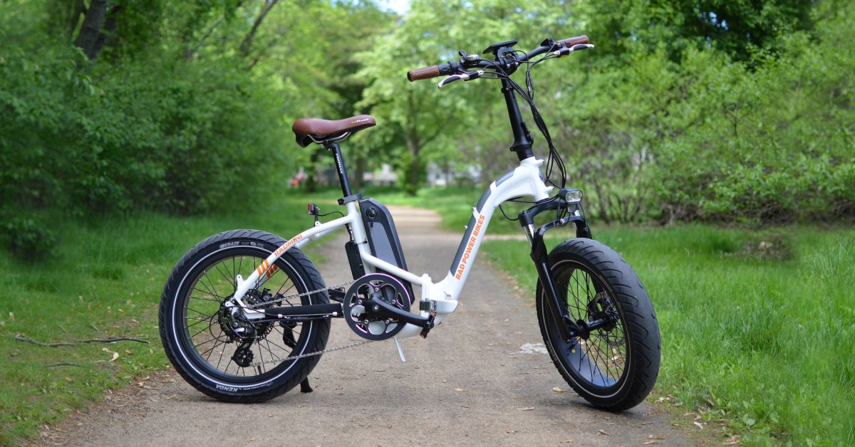

Here are a few suggestions... good luck with your search. ;)
You've got a difficult search going here. Most throttled folding bikes have hub drives which, for the most part, are less capable on hills than your mid drive emtb. Even at full throttle, depending on the slope, I don't think your leg muscles will get much of a break. The throttle will give you a rest on the flats though.

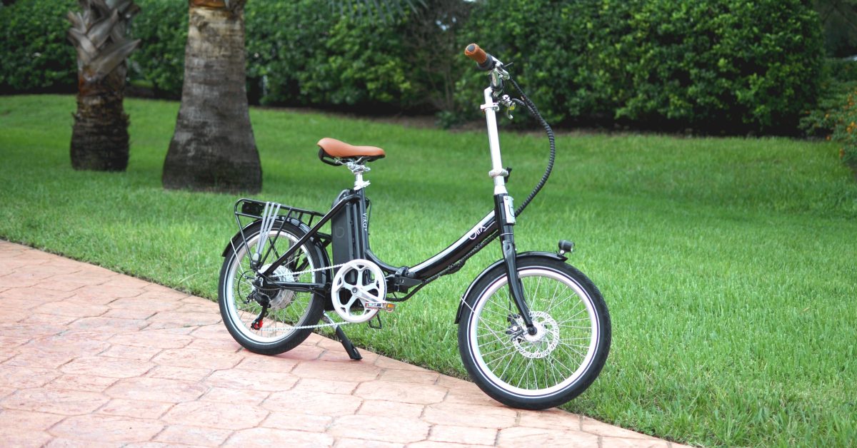

Here are reviews on some popular folding bikes for 2019 which might be of help:

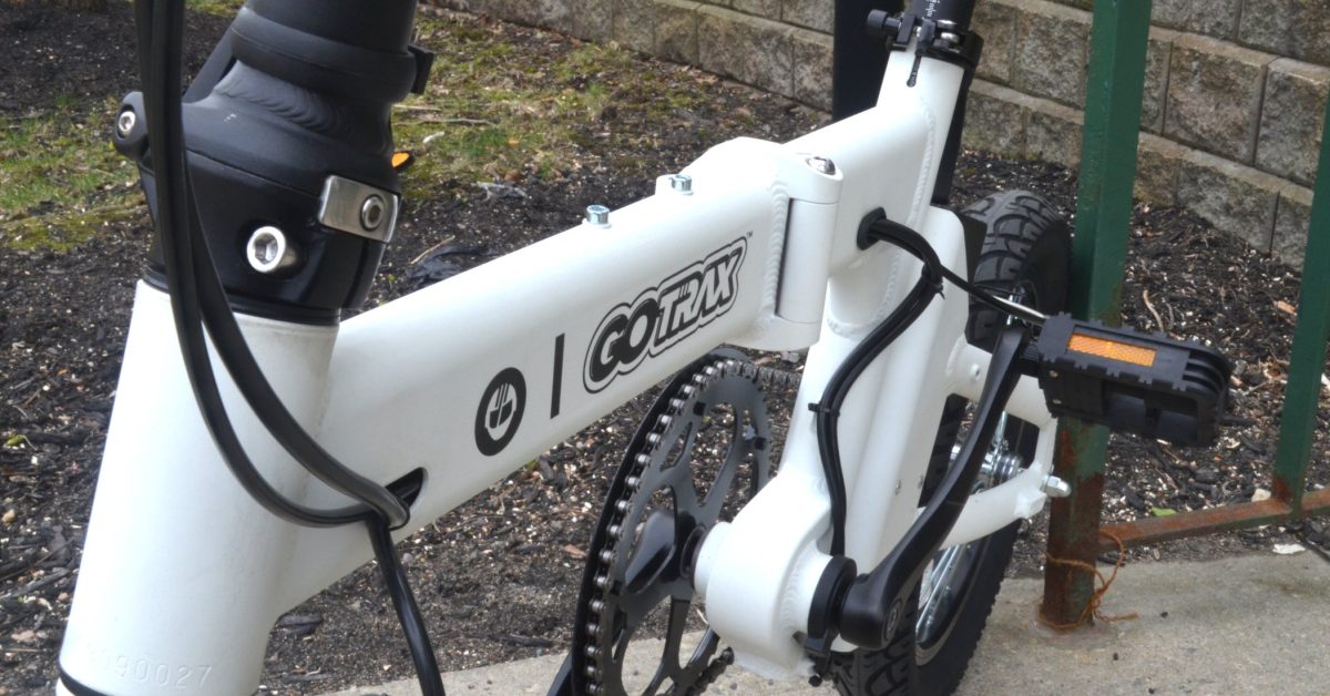

Here's a bike that can do what you want. Mid drive BBS02. That will handle any hills, A reviewer went 24 miles on flat ground, throttle only, on the Luna Mosso, using the 52V6AH Luna Mini battery. Watch the video in the lower right corner. They have different batteries now.
