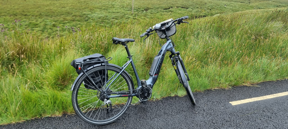

As I was on my holidays in Co. Donegal, I visited a bike rental in Carrick (Eircode: F94 VY84). They had a basic Thompson Enigma e-bike for a day rental. It was a simple Bosch equipped mid-drive motor e-bike with a reasonably big battery. I made a nice trip to Malin Beg (to see Slieve League cliffs). I could climb any hill in the area, and there was aplenty of juice in the battery post ride. I'm sure a Trek FX+ 2 couldn't make it!
The brand I have never heard of. Just a basic Bosch E-Bike with the weakest Active Line motor and a 500 Wh battery...
I could easily climb 10% grade ascents...
