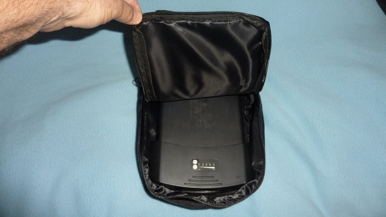

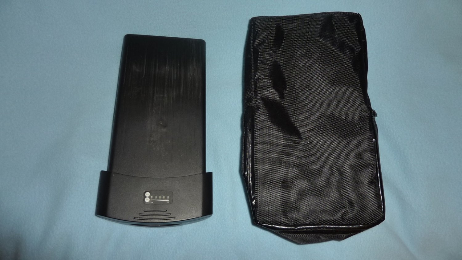

I use padded bags, sized to fit my various batteries. There are many available to fit most any battery

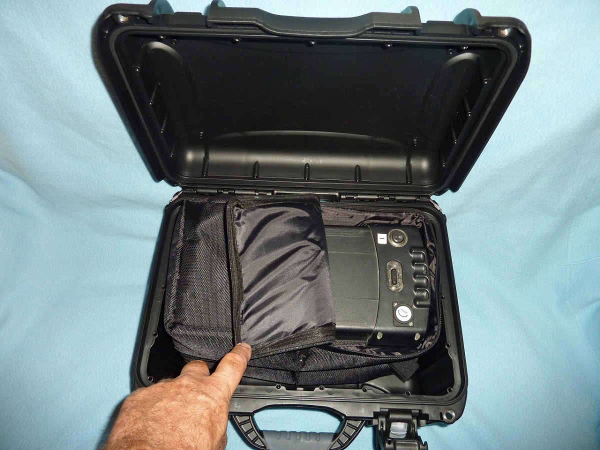

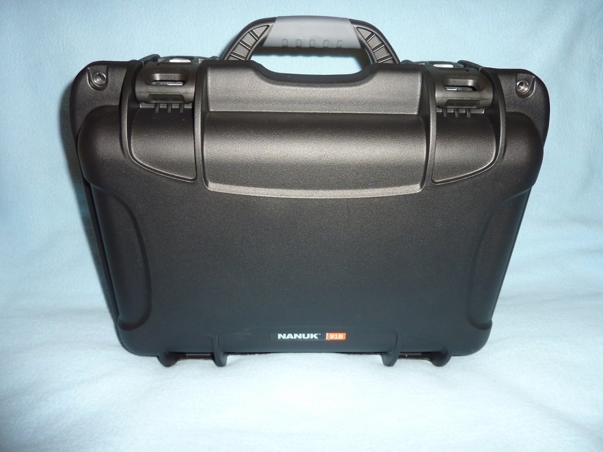

I've seen several cases where batteries were damaged during transport by placing them loosely in a vehicle. A sudden stop or collision can send them flying, increasing the risk of damage or even a fire.
I take it a step further and carry the battery & bag inside a hard shell protective case such as those made by Pelican or Nanuk:
I also use the padded bags when carrying a spare battery in a pannier.
There are also products that combine the two ideas such as this padded hard shell case:
The trick is to find a product that closely fits the size & shape of the battery. If you post your battery dimensions, you might get a more specific response.

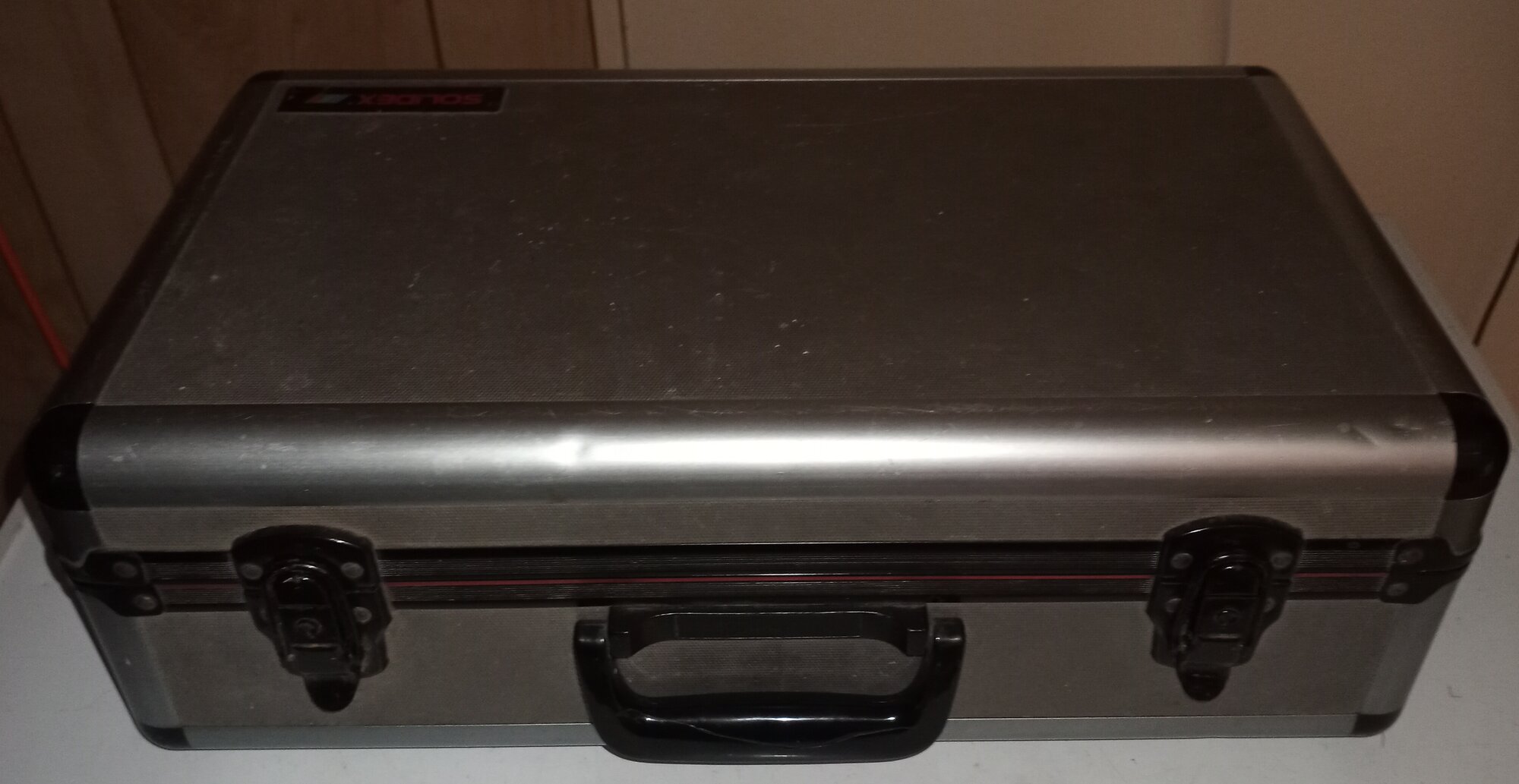

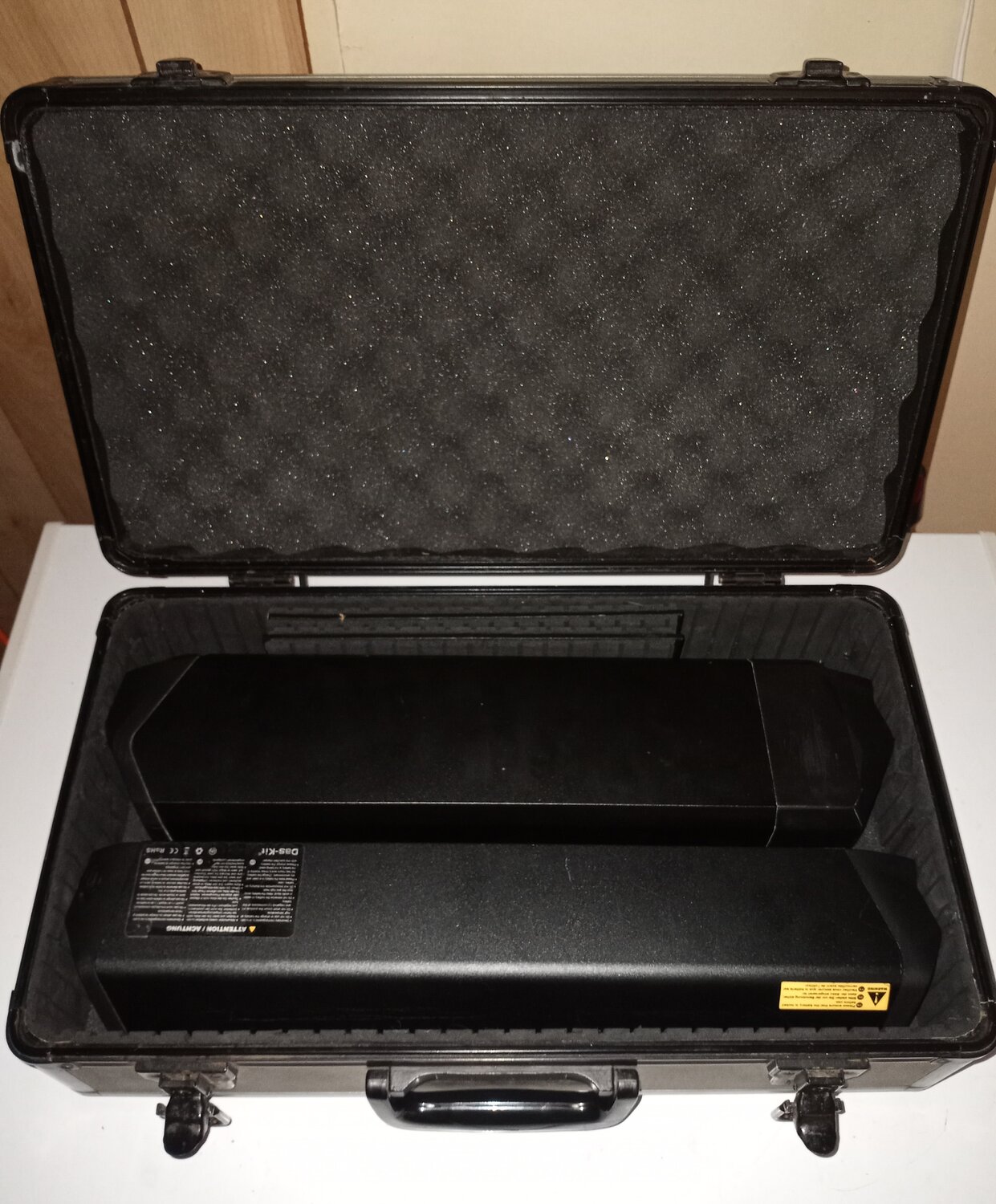

I've got an old camcorder case from the 90's.
My two batteries just happen to fit perfectly inside.
The case and batteries weigh 29 pounds.
I would try to strap the box down with a seat belt if it was ever in a vehicle.
