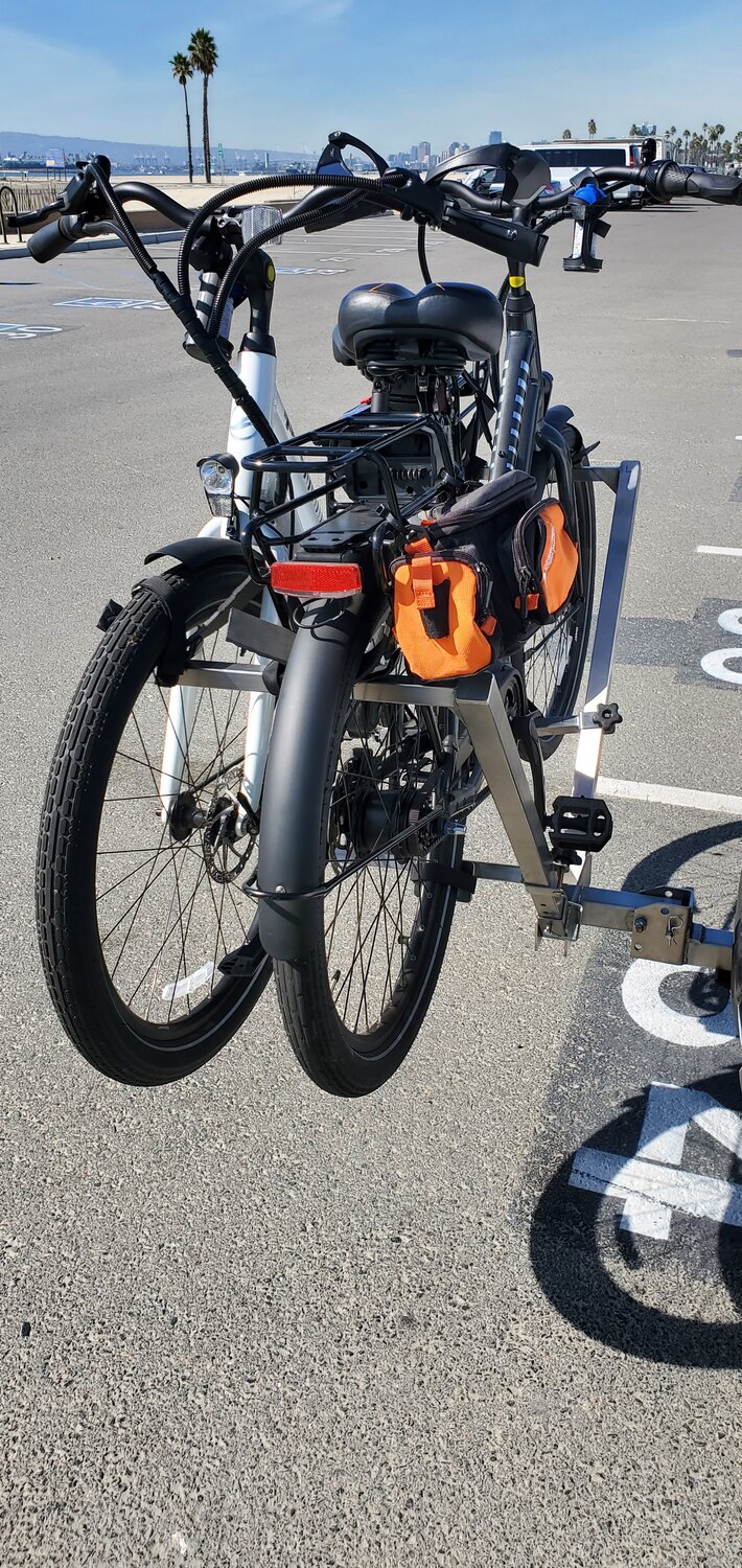

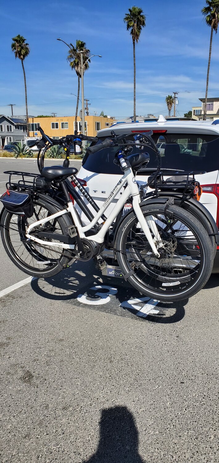

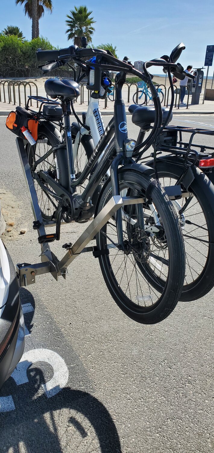

To anyone Looking for a super stable, super convenient, ultra compact Double (or Single ) Bike Carrier, I Highly recommend this rack from MOTOW.
https://motowus.com/
I looked at ALL of the higher end models, and found this one to be the Goldie Locks best of all worlds.
I am 66 years old and have a bad back that can't handle lifting too much, or for too long.
But the process of lifting ONE wheel at a time makes this unit a breeze to use (manually).
But if you REALLY need help you can accessorize it with A MOTORIZED LIFT ! that connects to the hitch. Sold by Motow.
So far I'm doing great without a lift.
Next thing to note is the fact that the whole unit breaks down into essentially 3 separately removable Parts that you can easily toss in your Car while you are off riding.
In its broken down state, it is SUPER light weight (aircraft aluminum if I'm not mistaken), no wheels or cart needed to move it.
Plus so easy to find space for the 3 Parts in your Overly Crammed Garage (come-on I know your garage is stuffed ):cool:
I have watched my bikes in the rear view mirror when going over bumps..... and the bikes remain Rock Solid.
This is what I want for my investment, not a cheaply made, risky set up.
And last of all.... NO I don't work for Motow, I live in Southern California and being retired now am so happy I can get out beyond my neighborhood (with confidence) and ride.
