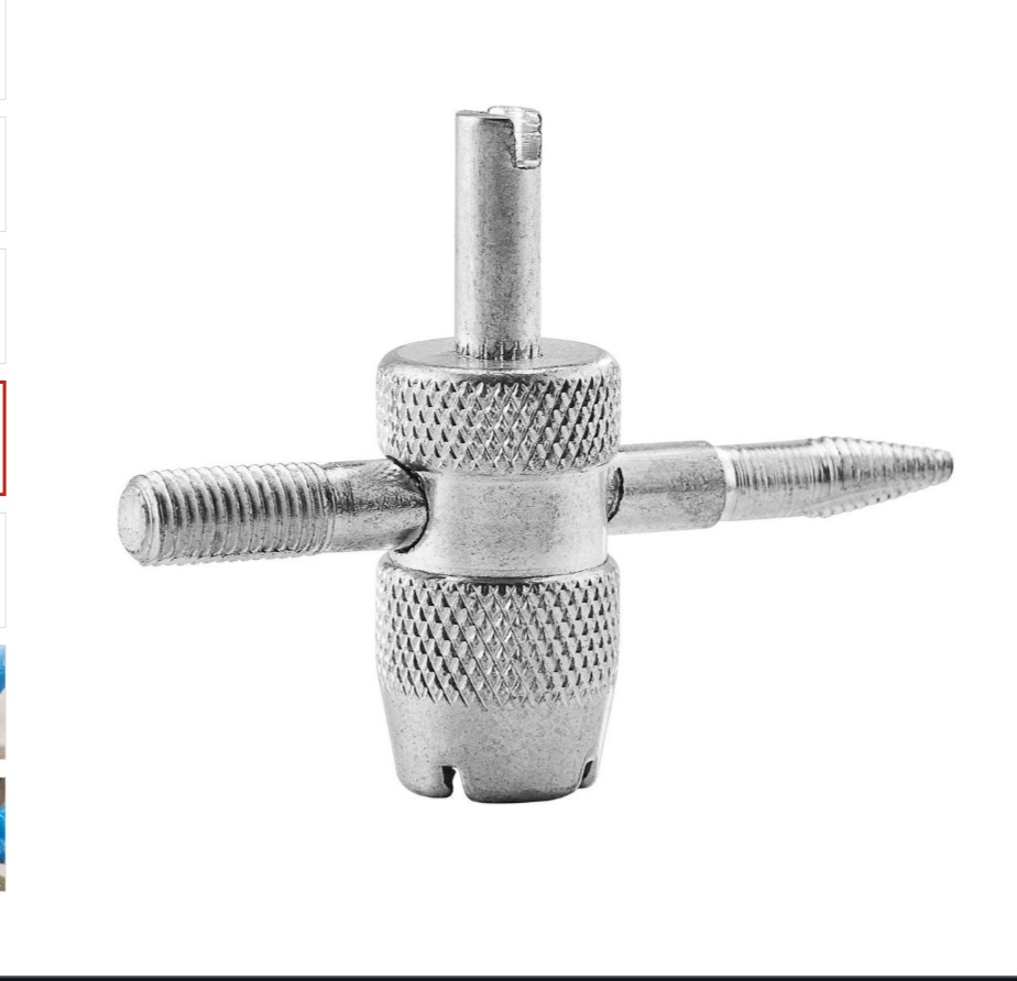

The stubby valve core tool handles are actually a tap for the valve stem.
Removes valve core, re-taps inside and outside threads, and reams valve
Tire-sensor safe
Ideal for bikes, motorcycles, and automobiles
I've seen them at places like Autozone too
Tire-sensor safe

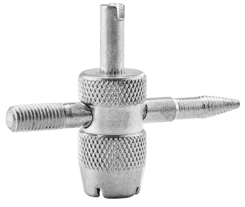

It's a great tool, and I always carry one! There are some issues though.
Depending on the length of the valve stem, the tool may not be long enough to clear a sealant clog.
The spokes on some wheels often interfere with the "T" design, preventing it from turning 360 degrees. It works great on my 26" 34 hole rims but not on my 36 hole rims.
I also carry this one that clears the spokes:
True.
I've used a water soaked Qtip in that case. Just go easy to keep it in tact and spin in just one direction or it can start to unwind the cotton.
