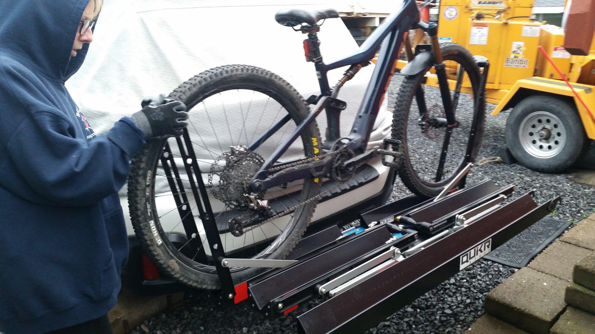

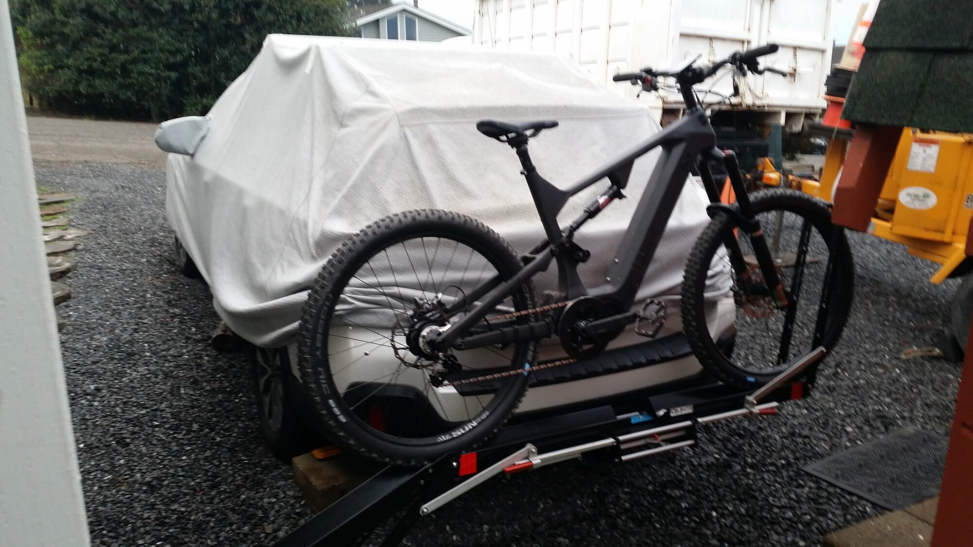

Tested loading my new Hydra into my wife's new QuikRStuff rack. Ramp is still attached and to the left.
Yes the rack is expensive. Yes it was a long wait. (Though I think they can tell you exact wait times now.)
AND, the rack is strong and impressively workable in every detail. If you like things that are just "RIGHT" this may well be the rack you're looking for.
My wife with her bike in first "slot". Second slot for bike has wheel holders folded down still. Third grooved track is the loading ramp latched in place and locked.
