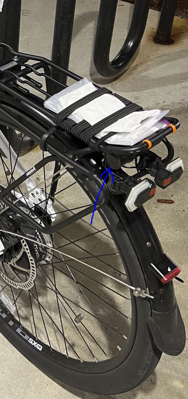

I've been fairly happy with these turn signals on my bike; however, I had purchased mine from aliexpress for a little less than the Amazon.com prices. The controller that came with mine uses one CR2032 battery, which seems to last for at least 3 to 4 months of every day use of the controller. I have the turn signals on the front (via a this handle bar extension) and rear (on bike rack) of my bike, so left turn or right turn signals blink in unison on the front and back of the bike. My ebike display has a USB port on it and I have the two turn signals that are on the handle bar plugged into the display USB port, so they automatically charge from the ebike battery whenever the bike is powered on. For the rear, my bike rack had reflector mount on it and I removed the reflector and installed a portable 5000 mAh USB charger where the reflector mounted and have the two rear turn signals plugged into it (see enclosed picture of turn signals and USB power bank mounted to rack). The rear turn signals plugged into the 5000 mAh USB charger won't automatically charge the turn signals when their battery get low, so I've gotten into the habit of every now and then simply unpluging and immediately repluging the USB cable into the USB battery charger and that will cause the turn signals to get fully charged. The turn signals will also work (i.e. blink) while they are being charged. My guess is I can go 4 to 5 months before I have to juice up the 5000 mAh USB charger.
