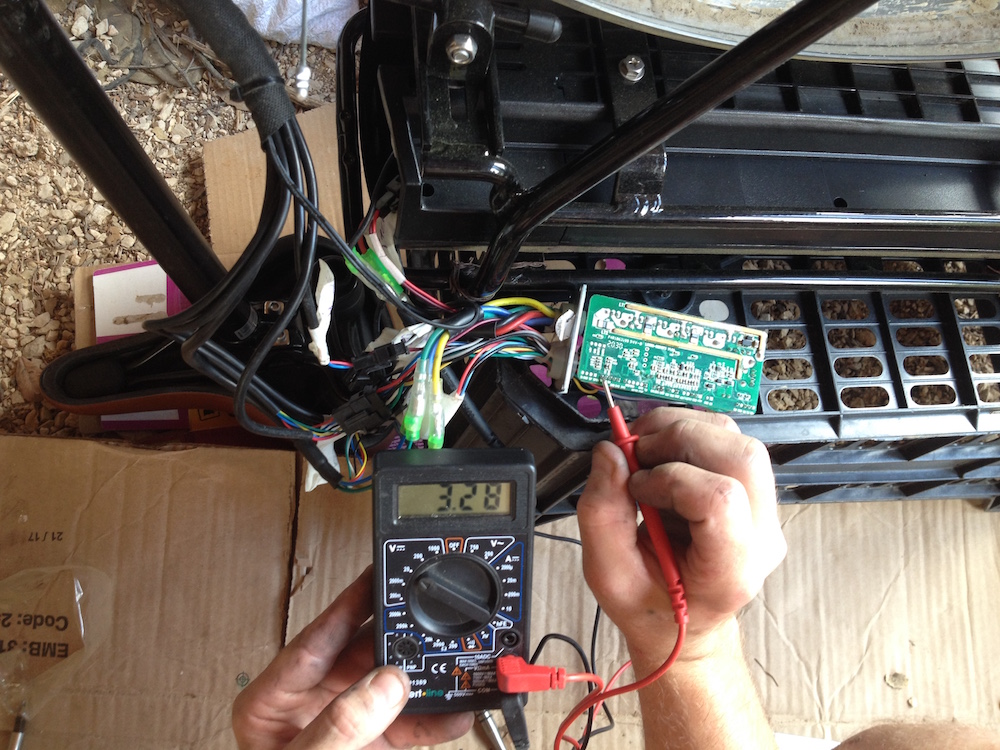

I did all the tests listed here, except for those that require a device to turn the wheels at constant speed: https://electricbike.com/forum/foru...-motor-s-phase-wiring-hall-sensors-and-wiring. All the other tests I did, and they all passed successfully.

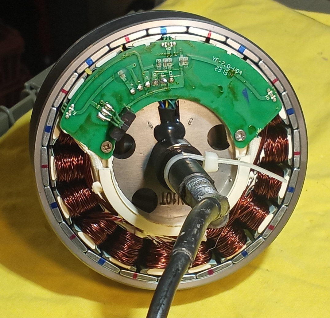

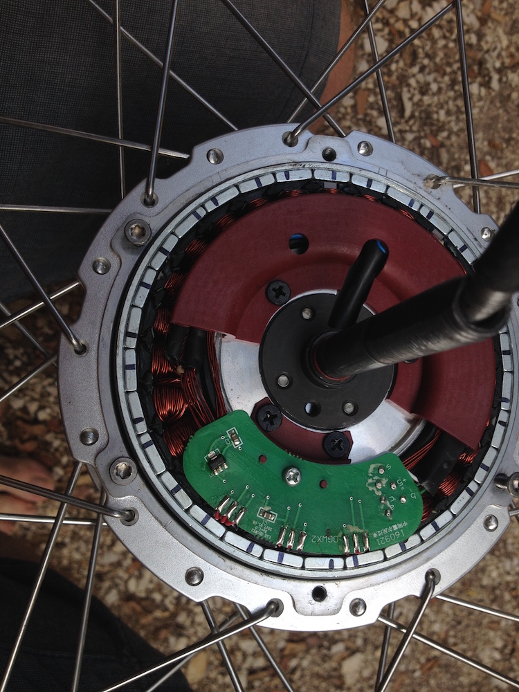

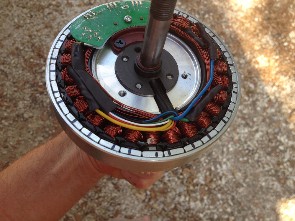

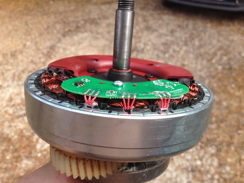

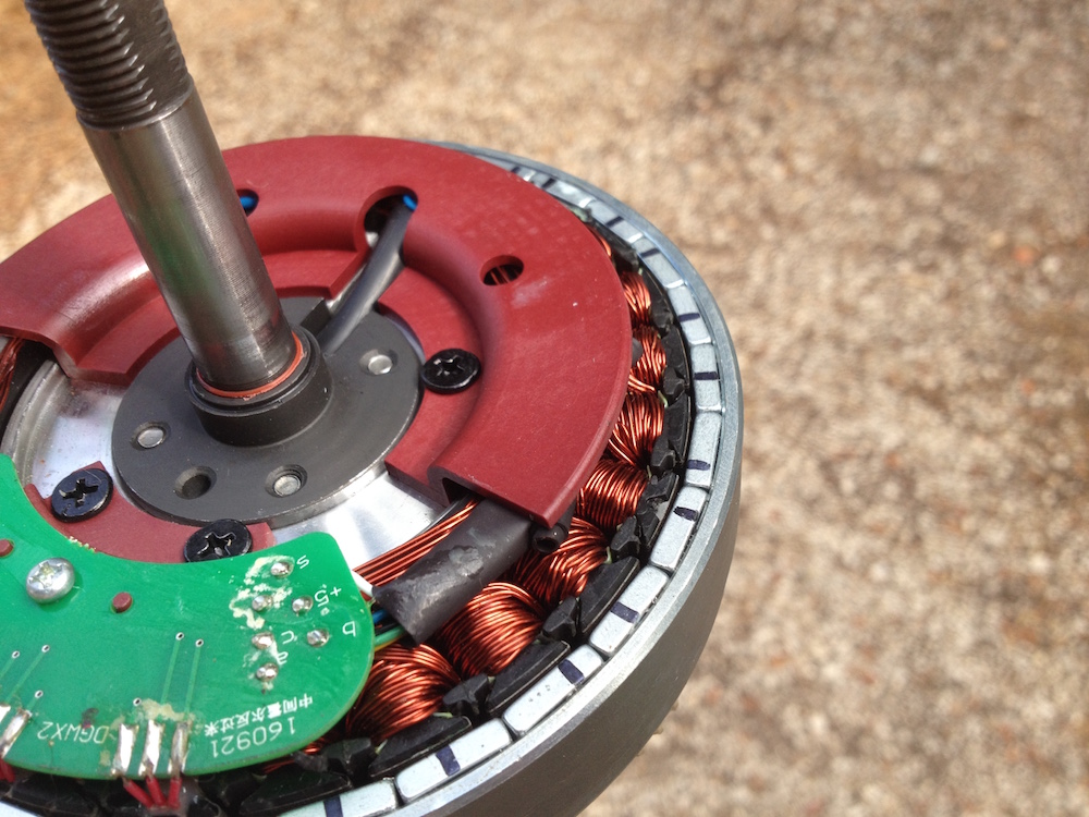

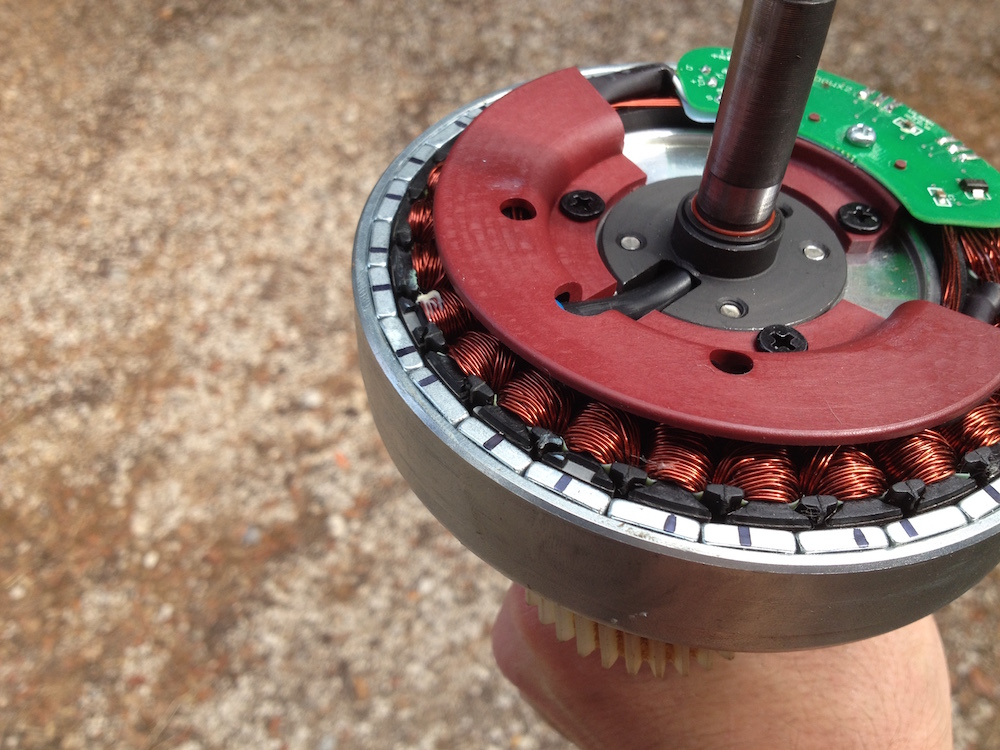

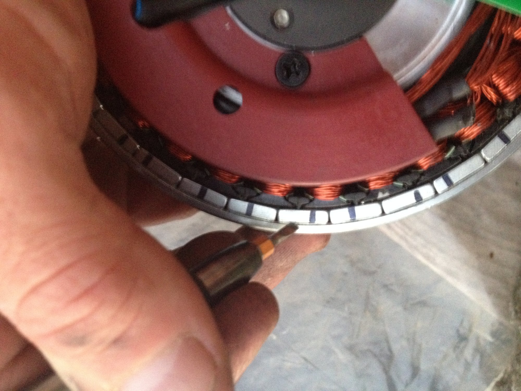

I opened up the motor, suspecting loose magnets. Although I didn’t manage to separate the rotor from the stator, looking at them together I didn’t notice anything weird. This is my first time trying to repair an electric bike, but everything seemed normal. The bike is a foldable Megamo Park and I think it’s a Shengyi DGWX2 motor.
I also checked for broken teeth from the planetary gears but didn’t find anything.
The casing where the gears meet with the wheel had a very slight bit of slightly rusty colored stuff, but very little, and nowhere else.
