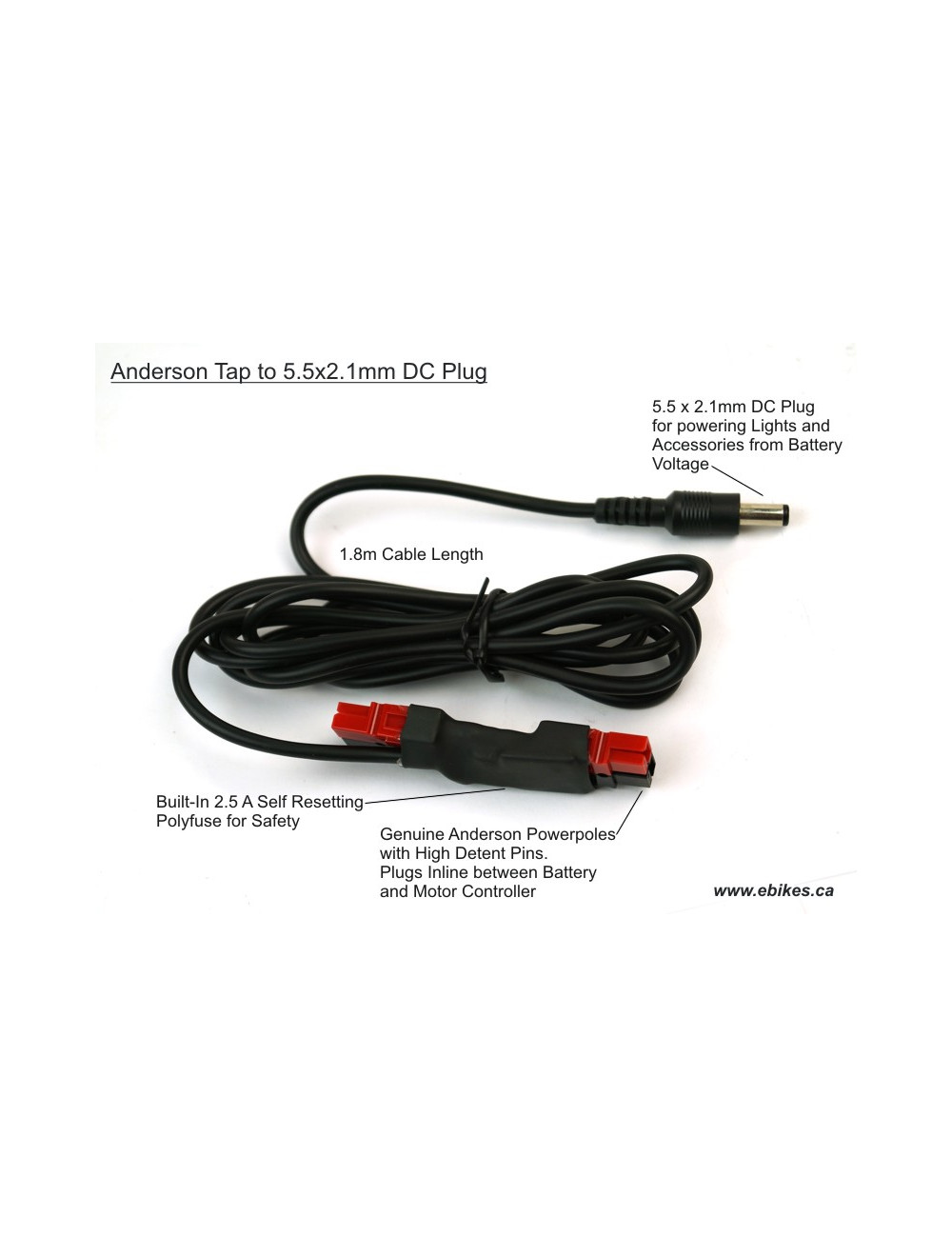

I use an Anderson tap and accessories that are rated for a range of voltages. Tire pumps, lights, and horn all work with 24v to 52v. Makes it easy for me.
i bought a dozen self reset fuses and made a couple with XT90 and XT60 connectors.

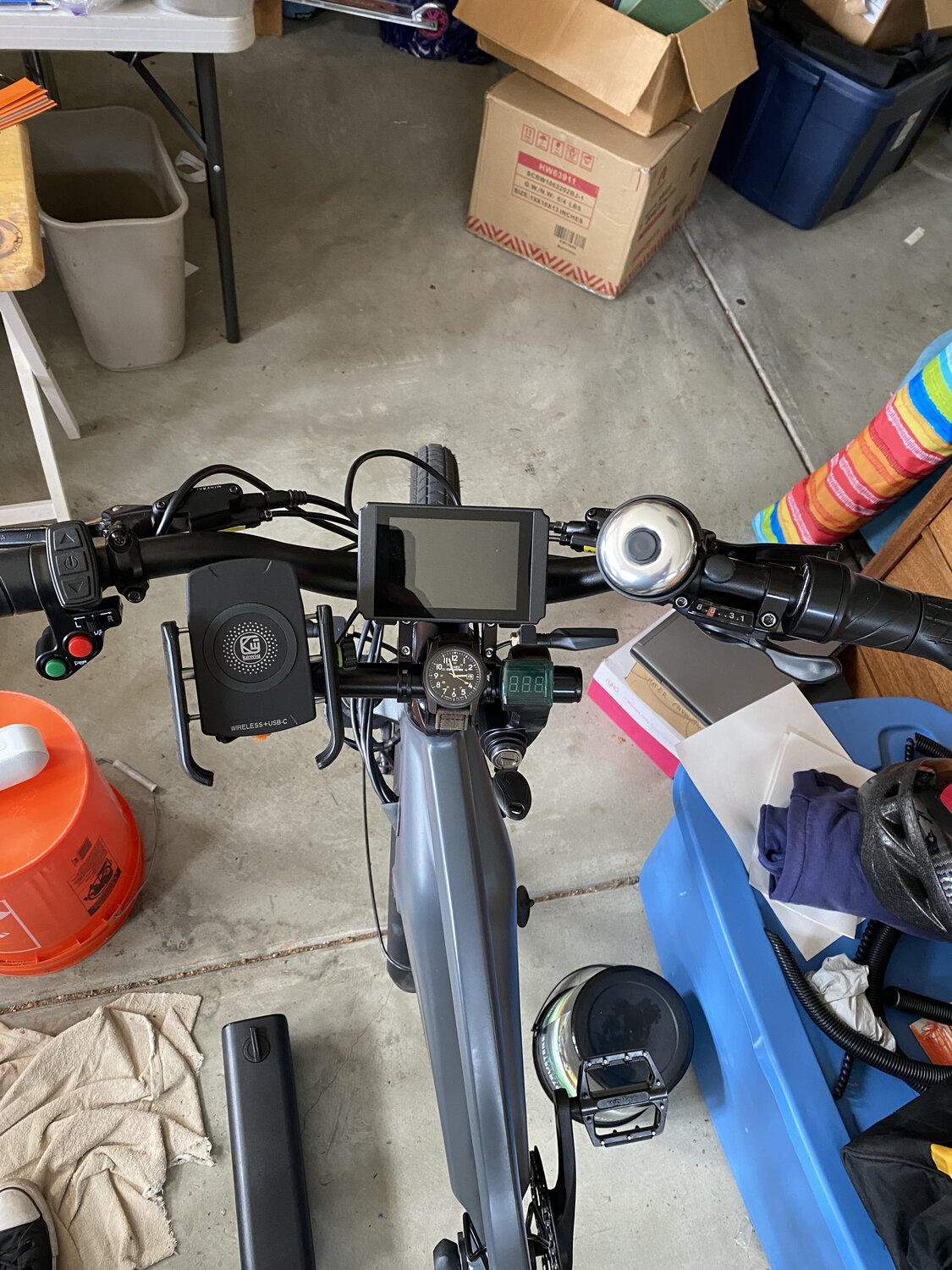

There should be a constant 48v going to your display, from the controller. That is the source that I tapped in to. I connected a dc-dc 48v->12v converter to run my light assembly. I also used the same source to add a wireless charging phone cradle.
Would you mind sharing the converter you used to do this? and pics of it all would be great too!
I used this one.
There are many kinds. Buck converters are smaller, but dont seem very water resistant.
Here is the light assembly.
Ebike Headlight and Tail Light... https://www.amazon.com/dp/B08KG5GJRD?ref=ppx_pop_mob_ap_share
And here is my wireless charger.
KEWIG Motorcycle Phone Mount with... https://www.amazon.com/dp/B09DC4VJS2?ref=ppx_pop_mob_ap_share
