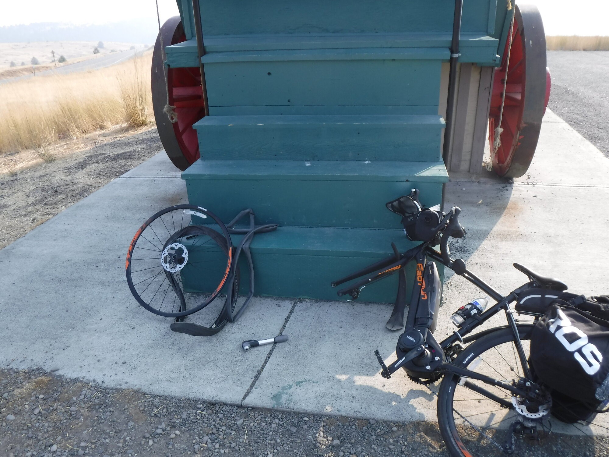

Not the same bike that the airless tires are going on but same idea. Flat on a ride in the middle of nowhere, Vibrelli pump could only get to <40psi if I recall correctly and before I started carrying a CO2 inflator.
