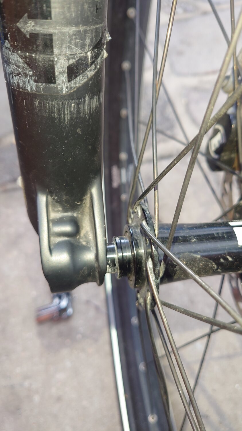

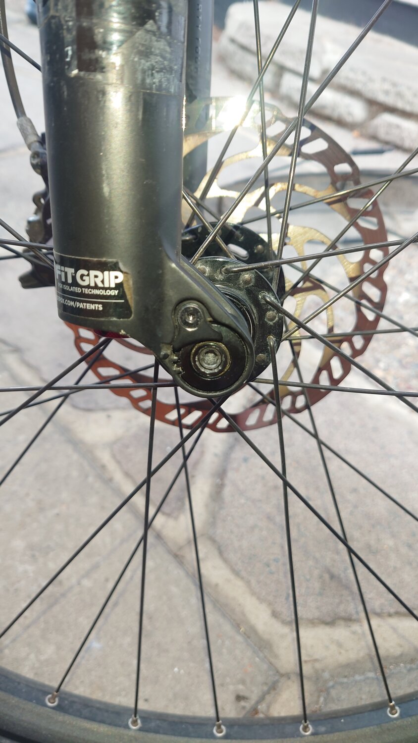

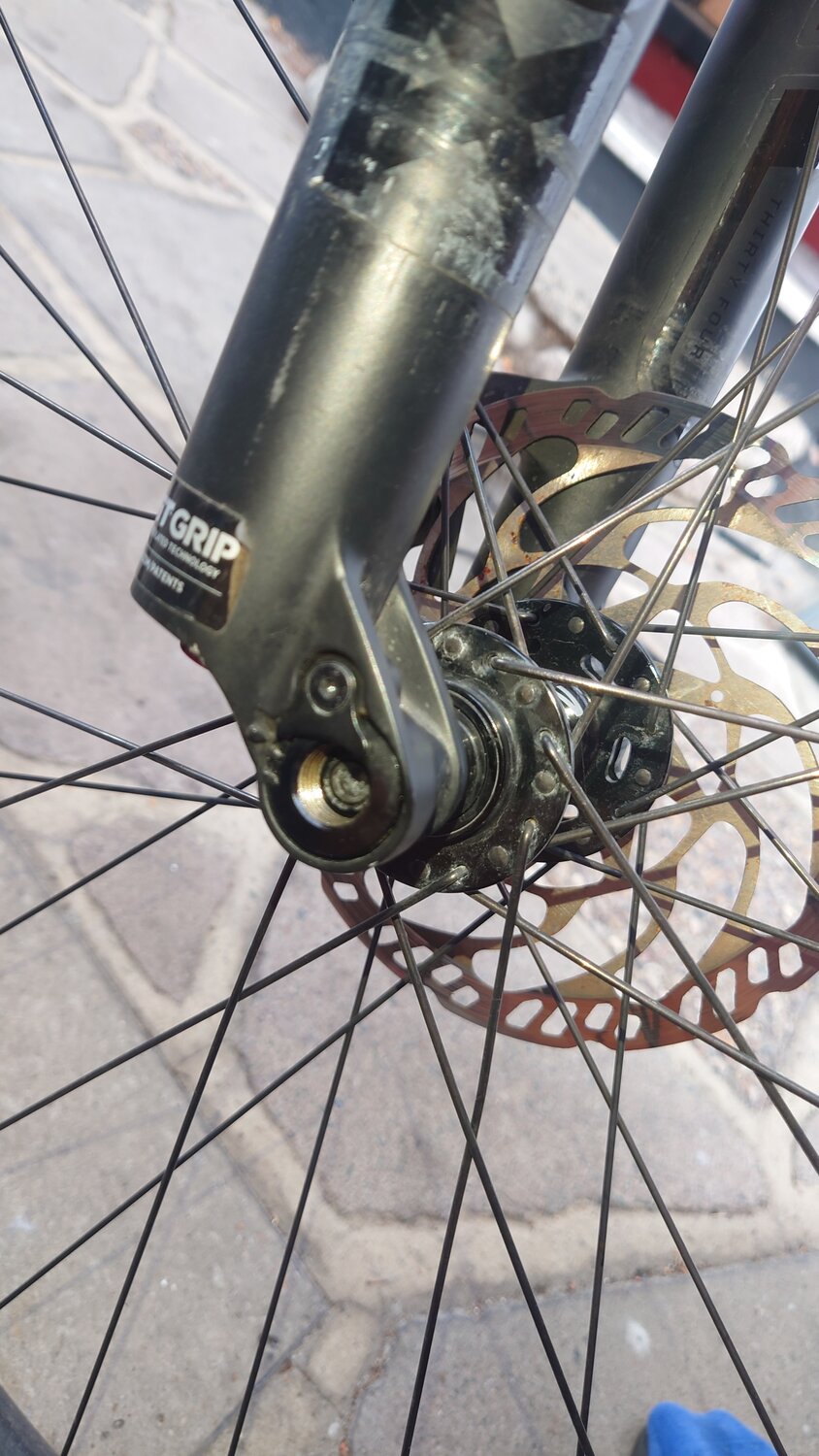

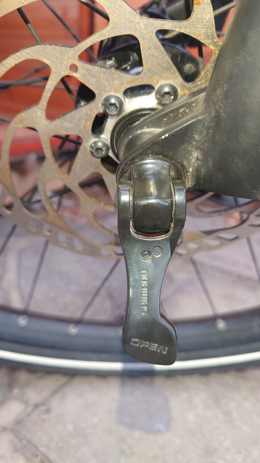

Hi all. Before my 1500km trip I tried to learn about my superdelite as much as possible. I was told many things by fully charged (company that I bought it through). For example, I am not allowed to change my own tires even if I have a flat one during my trip (need to walk it to the nearest service), I am not allowed to change carbon fiber belt or to even have a spare one (R&M will only send one if I have proof that it snapped) etc. Had many issues with my front guard from the day I bought the bicycle. Numerous times I have asked them to fix the problem of it getting stuck if I get on a bumpy road and then damaging my tire until I stop and push it back up. So for my long trip I took the front mud guard off since with extra added weight it was even worse. But I could not take it off easy... Front wheel quick release axel just does not come off at all. Back wheel is different design and have no issues. This one I can undo it by loosening from the other end, then instead of being able to pull it away, all I can do is undo the thread. After it reaches the end, nothing happens because the frame is keeping everything secure and 0 give no matter what I do. I won't go back to them just to be told I am not allowed to take the wheel off, but there must be something I am missing here... Anyone had this problem before? Would also help me in the future if I do get a flat tire and need to change inner tube. In the photos I took you can see starting point and what it looks like after I undo the thread
Your e-bike seems to be equipped with the most modern thru-axle equipped with a quick-release lever. Chances are someone tightened it too strongly. If you have not mismatched the release direction (anti-clockwise), just put a piece of a tube onto the QR lever and pull it. The thru-axle should never be removed by acting on it from the other end.
Hard to know exactly what you're saying here, but I'm guessing:
1) Front axle screws into threads inside the axle hole of the fork.
2) Rear axles has a separate nut into which the axle threads.
The procedure for removing the front axle is to loosen the lever, then rotate anti-clockwise to unthread it, then it should slide out.
If this doesn't work, you'll need to be more descriptive about what's going on for us to help you.

Based on how unscrewing it seems to be pushing the fork apart, it seems like the axle is stuck in the bearings. If I were you I'd thread it back in by just one or two threads, and then give the thread side of the fork a very light tap with a mallet. It's probably just crusty dirt that will pop loose easily.

The front thru axle simply unscrews from the fork once the QR lever is released
I have had issues removing the front Quick Lock axle bolt in the past on my Nevo3.
Once undone, if stuck, I use a socket extension bar and a soft headed mallet to start to get it to move, which usually does the trick then pull it through.
When reassembling, give everything a good clean, then add some saddle stem grease to all the surfaces, including the holes in the forks. This will help to remove it in the future.

Hi, for some reason I did not get any notification that I had replies, so I have booked a golden service for my mudguard replacement (broke it while trying to put it myself without taking the front wheel off :D) So I will ask them to show me how they take it off. I did try to tap it a bit, but was too afraid to brake something. Thank you for you comment, seams I am not the only one that has this issue with front axel...
your saying the axle wont pull out when its loose? is there weight on the bike when your doing this?
Done everything by now apart tapping with a mullet - was too afraid I bent something. Booked a service end of the month and I will see what they say about it. Should not be that hard to take it... I mean it is called quick release :D But yeah, tried bicycle upside down, tried somebody holding front end up to release any pleasure - no result

Thank you for the help but since google did not send notifications, I though nobody replied to my thread and I have booked a service. I will ask them to show me how they undo the front axel and inspect if I have something wrong or maybe it is just stuck. It could also be that they don't want anybody to take the wheels off by themselves so they have a special way to do it and refuse to show me... They done that on multiple areas of the bike where they just say it is for the service guys to know only. Was not aware I was getting an apple product...

Which front fork do you have? If it's a Suntour, that's your problem.
