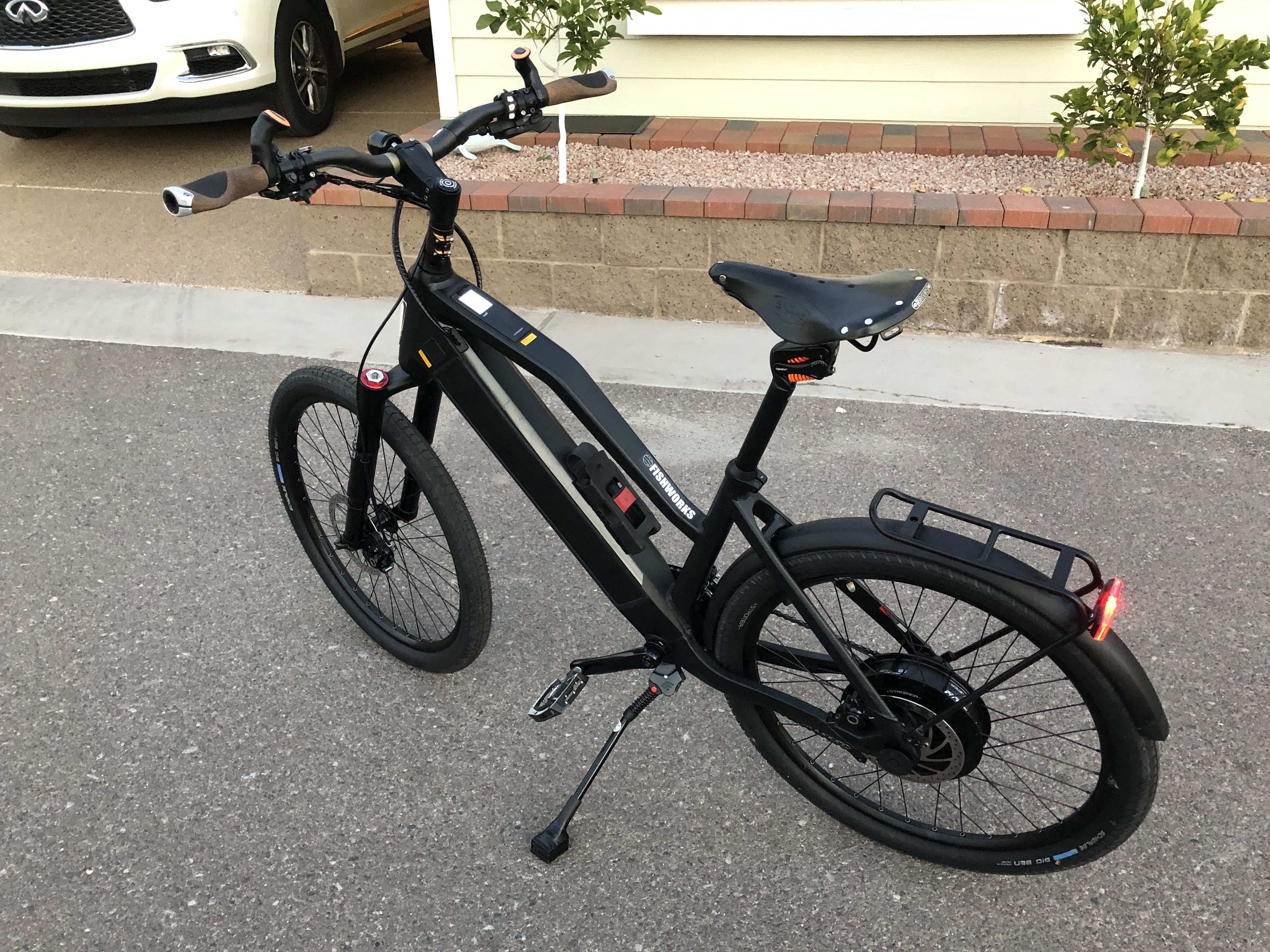

I sold one st2 comfort two years ago( for over 50% of list) with 2k miles on it, to buy St2s. Recently bought another new st2 comfort while they are still available. 30929E62-8D6E-4528-B6CC-31D00C1E6893.jpeg82F9FBA5-ADC8-47A0-BF1A-53F0B6E72EC4.jpeg558F4C19-DB48-4171-8CE9-0EBD0744618E.jpegF463EF38-AE68-45BA-A8B8-6BCE0C625F19.jpeg I’ve got no interest in trading up to 27.5 wheels. Or selling either st2.
I sold one st2 comfort two years ago( for over 50% of list) with 2k miles on it, to buy St2s. Recently bought another new st2 comfort while they are still available. View attachment 29169 I’ve got no interest in trading up to 27.5 wheels. Or selling either st2.
That is a cool looking WREN fork. No problem in installing the fork?

There was a minor issue installing fork. The taper on steerer from 1 1/2” to 1 1/8” on carbon fork happens fast(in a short distance), but wren and Rockshox taper is a little longer. Last time I solved problem by buying Stromer branded Suntour, but this time I looked up into headtube and found U light backing plate had “gussets” that I ground off to make forks fit.
It only took a Phillips head and 5 minutes. I wish I would have looked closer on st2s, cause then I would have had rock Shox sid’s Instead of Suntour on st2s. First picture is backing plate, second picture with “gussets” trimmed off.
I do like the Wren forks better than rock Shox Reba’s(I had on my old st2 comfort) or Stromer branded Suntour.
