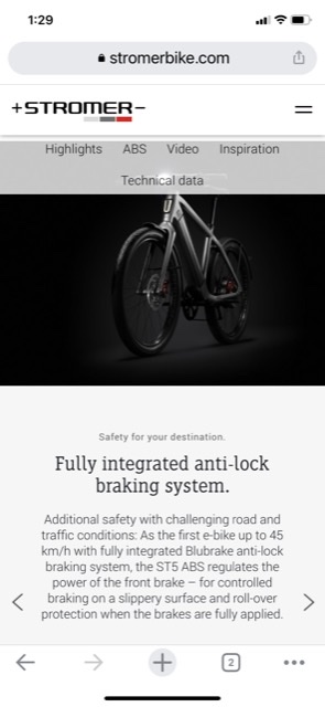

Stromer ABS ??
MinnBobber
Their ABS is said to have “roll-over protection when brakes fully applied”.
Does this mean it can prevent the deadly front flip in an emergency braking situation?
That is more important to me vs anti skidding of front tire.
Anyone know??
Thanks
Have a closer look on the two video. The blubrake video shows the intention of the ABS. I've added some slow motions which unveil: No hard braking was made. But the concept is visible. My own video shows, how it works when hard (or panic) braking occurs: Front wheel locks for a fraction of a second, then the ABS performs a smooth braking.

Thanks for your observations regarding road motorcycles. This gives me the opportunity to explain the difference to the ST5 ABS commuter bicycle.
A motorcycle has often three times the weight of its rider - and the center of gravity is clearly below the handlebar. In case of the Stromer, it's the complete opposite: The rider has mostly three times the weight of the ST5 ABS and the center of gravity is far above the handlebar. The leverage force to throw the rider over the handlebar is much bigger - and takes in place before the front wheel is blocked.
Therefore, the main job of the ABS on the ST5 is provide a smooth negative acceleration. To control this, a gyroscope sensor is part of the bluebrake system. This is, what the video above shall illustrate.

Thank you for this clarification @bluecat !!!
I was hoping for a gyro system as straight ABS would seem to increase the probability of a front flip as it provides maximum braking force, with the high center of gravity on a Stromer, this max deceleration would equal front flip.
If the front wheel locks /skids then traction is lost and braking force is LESS so no front flip, just other control issues. A locked front wheel/tire equals a big skid but not a front flip.
I would then characterize the Stromer ABS as the reverse of motorcycle “anti-wheelie systems”. They keep motorcycle from flipping over backwards under too much acceleration while Stromer ABS keeps bike from front flipping under too great of deceleration.
IMO, preventing front flips is much more important than a traditional ABS, non-skid system, which maximizes brake force and can foster front flips.
This now makes me excited to get a Stromer with their “AFS” ABS , anti-flip system!!!!
Thanks again bluecat for this info
