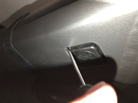

Can anyone provide specific instructions on how to pop out the battery using a small screwdriver, on frame opposite side of battery?
My screen is blank, and I need to pop out battery to reset, so I can ride to repair shop.
(This recently occurred, I loaded bike into car for repair and this is what he did, said it “happens sometimes”.
Obviously there is something wrong with bike, super frustrating.
I used a plastic tool to remove mine, so it would not damage the paint
How to Manually Remove Stromer Battery

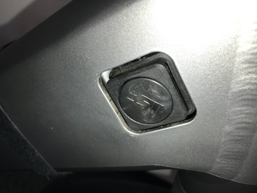

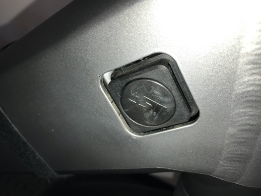

  • Locate the beveled edge around the battery eject button.

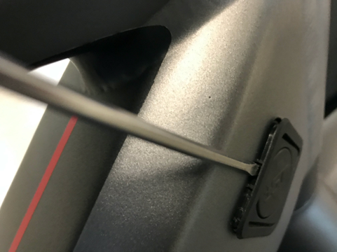

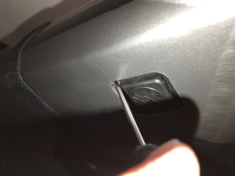

  • Use a small flathead screwdriver to pry edge of button away from frame. Use a cloth or other protector if needed to protect frame.

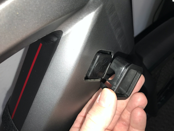

  • Remove the plastic outer edge of the button all the way from the frame.
  • With a flashlight or some other light, look inside the battery compartment and locate the white bar which holds the battery in place.

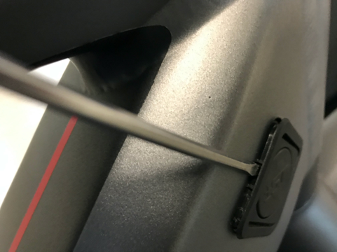

  • Using the flathead screwdriver, carefully insert and use end of the screwdriver to press that bar up and forward, just releasing the battery. Be careful as to not snag anything else, or scratch the battery or the inside components of the bike.

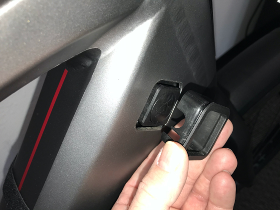

  • Once the battery is ejected, remove the battery and reinstall the plastic edge piece. Make sure to orient it properly so that the cutout portions are face upward, diagonally to the back of the bike, as pictured below.
