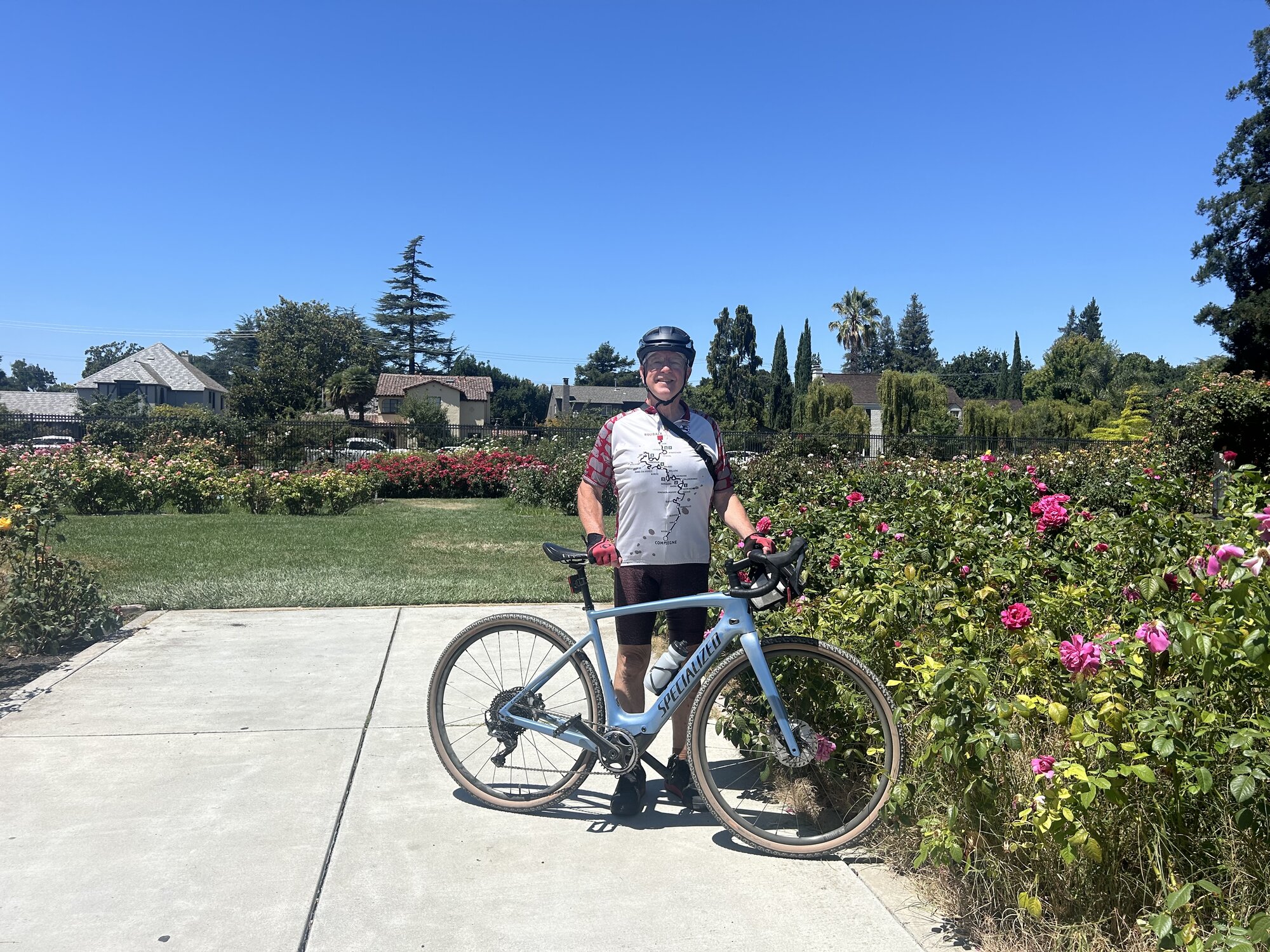

My Crea brakes were fine and then dvlped huge squeak after sitting unused in hot Calif garage for a months.
Me thinks slight front brake fluid leakage from the heat contaminated front pads and rotor.
I have cleaned rotor multiple times and no help !
Was hoping new pads would cure it but one mechanic said it absolutely needs rotor AND pads!
Can that be? 🙁
The howl/ squeal it at a monumental volume and the most piercing and painful pitch composition you could ever imagine!
The whole carbon fiber bike frame vibrates like a 1000watt electric instrument of a touruous tone.
At my brother’s house, I rode the bike halfway down the block, applied the front brake and it did the howl. My brother commented how obnoxious it was even though they were in the house!!!
What do I need to fix?
