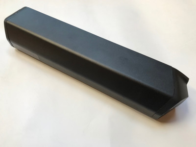

I believe Magnum has Reention Dorado 505mm battery.
so is it possible to increase mph by putting a 1000 watt battery on the metro?
