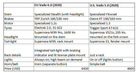

Specialized announced their commuter e-bike in 2017. Milestones for the top-of-line model:
Comparison in Excel format
- 2017: U.S. Class 3/EU L1e-B Speed Pedelec, 45 km/h or 28 mph. Many parts have not changed for years (I think it has been an excellent design).
- 2018: The fixed fork was replaced with Suntour suspension fork. That required using different front-hub and front-axle. Specialized website lists introduction of the 1.3 motor (Brose S Alu) as early as in 2018. (Hard to believe that).
Downgrade: Cheaper drive-train. - 2019: Lack of trustworthy data (only a non-EU source found).
- 2020: A breakthrough. The older BLOKS display had been a nuisance; it did not work with Mission Control either. (a) TCD-W display introduced (works with Mission Control) (b) Different stem (c) Different remote and separate horn button (d) New, excellent lighting (e) New Racktime rack.
Still the same old good Specialized 1.2s (Brose TF) motor. - 2021: New Vado 6.0 not announced.
