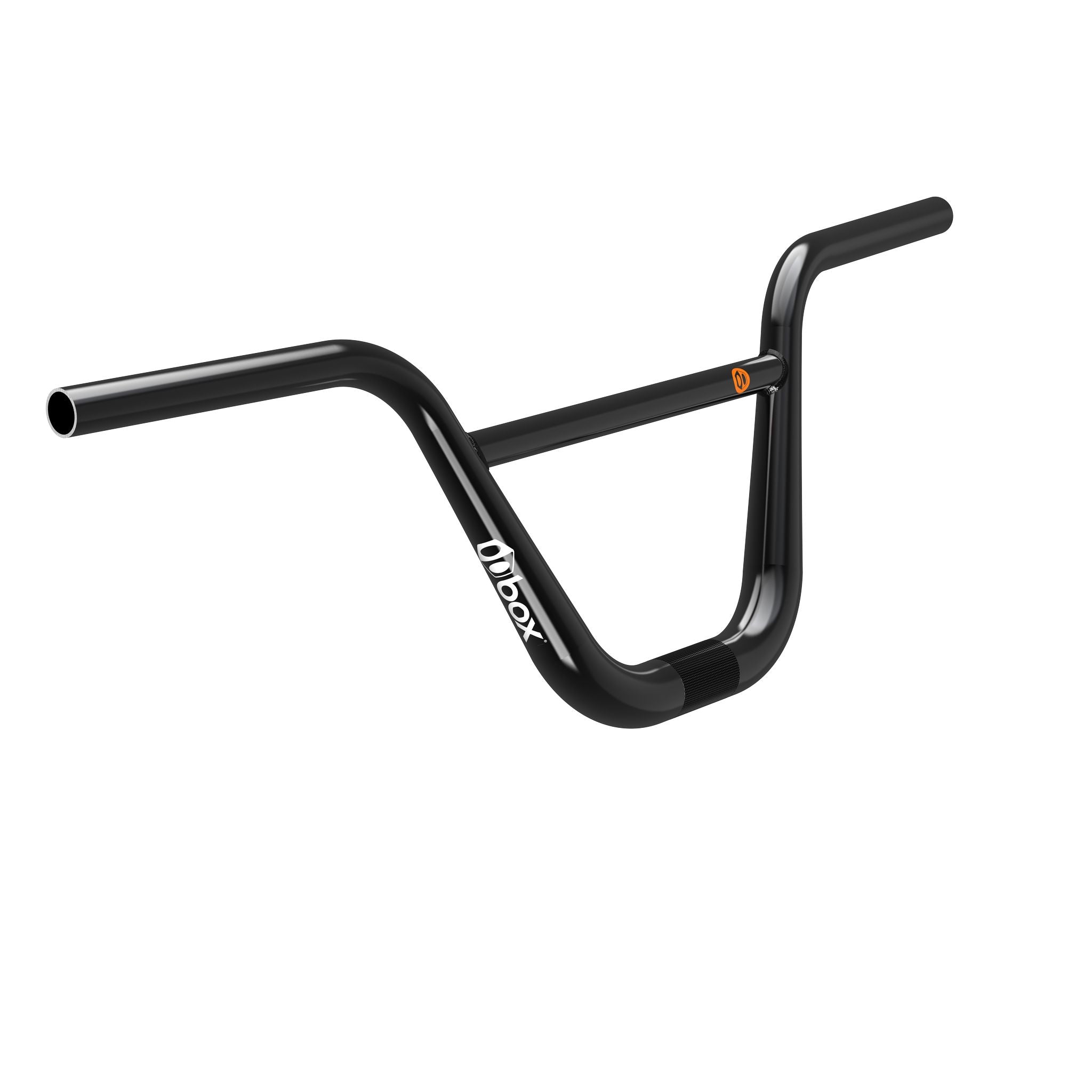

Thanks. Trying to not add weight, but that would be a solution for someone. What did you decide to use for handlebars?
I went with BMX handlebars to get a net 150mm rise with the stock Specialized stem. Here’s an example. I went with an alloy aluminum but that’s now out of stock.
I didn’t do it for a bag though - purely for the rise for my back. Total cost including labor and parts for lengthening the cables etc. was about $500 US. However if you look closely there is a 1 inch crossbar I can leverage for hanging the bag etc. but I haven’t decided yet on a handlebar bag or a left side only rear pannier type.
