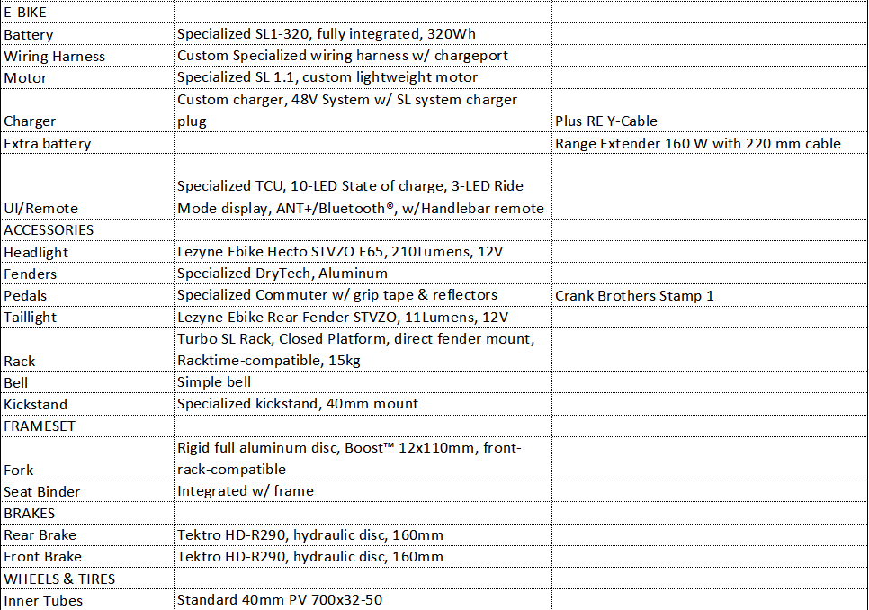

New models of bikes being released on Specialized website today. Mostly updates but no photos yet. Updated specs for Turbo Vado SL 5 EQ are below. Most importantly for me the price jumped up about US$750!
Technical Specifications
FRAMESET
Fork-Future Shock 1.5, Boost™ 12x110mm thru-axle, flat mount disc, carbon fork
Seat Binder-Integrated w/ frame
Frame-E5 Aluminum, bottom bracket motor mount, fully integrated downtube battery, internal cable routing, fender and front rack mounts, Smooth Welds
COCKPIT
Stem-Specialized Stealth Stem, alloy, 14 deg, 31.8mm, integrated TCD mount
Handlebars-Stout Mini Rise, alloy, 9-degree backsweep, 15mm rise, 31.8mm
Tape-Specialized Body Geometry Contour, lock-on
Saddle/Bridge Sport, hollow cr-mo rails, 155mm
SeatPost-Specialized, alloy, 2-bolt, 12.5mm offset, 30.9mm
BRAKES
Front Brake-Tektro HD-R510, hydraulic disc, 160mm
Rear Brake-Tektro HD-R510, hydraulic disc, 160mm
DRIVETRAIN
Rear Derailleur-Shimano XT, Shadow Plus, SGS Cage, 12-speed
Shift Levers-Shimano SLX, Rapidfire Plus, 12-speed, w/o OGD
Cassette-Shimano SLX, Hyperglide+, 12-speed, 10-45t
Chain-Shimano SLX, 12-speed, w/Quick Link
Crankset-Praxis, Forged alloy M30, custom offset
Chainrings-Praxis, 46T, 110BCD
ACCESSORIES
Pedals-Specialized Commuter w/ grip tape & reflectors
Headlight-Lezyne Ebike Power STVZO E115, 310Lumens, 12V
Taillight-Lezyne Ebike Rear Fender STVZO, 11Lumens, 12V
Kickstand-Specialized kickstand, 40mm mount
Rack-Turbo SL Rack, Closed Platform, direct fender mount, Racktime-compatible, 15kg
Fenders-Specialized DryTech, Aluminum
Bell-Simple bell
WHEELS
Rims-DT Swiss R500 disc, 22mm internal width, 23mm internal depth
Front Hub-Specialized alloy front hub disc, sealed cartridge bearings, 12x110mm, Center Lock™, 24h
Rear Hub-Specialized alloy rear hub disc, Center Lock™, sealed cartridge bearings, 12x148mm, 28h
Spokes-DT Swiss Industry
Front Tire-Nimbus II Sport Reflect, 700x38mm
Rear Tire-Nimbus II Sport Reflect, 700x38mm
Inner Tubes-700x32/50mm, 40mm Presta valve
E-BIKE
Motor-Specialized SL 1.1, custom lightweight motor
Battery-Specialized SL1-320, fully integrated, 320Wh
Charger-Custom charger, 48V System w/ SL system charger plug
Wiring Harness-Custom Specialized wiring harness w/ chargeport
UI/Remote-Specialized MasterMind TCU, 10-LED State of charge, 3-LED Ride Mode display, ANT+/Bluetooth®, w/Handlebar remote
