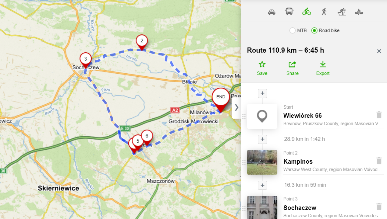

My goal is to be able to make a 100+ km (62+ mi) round trip to Sochaczew via Kampinos then return way via Żyrardów. Not that Sochaczew is an interesting city because it is actually boring but it is a good goal because of the distance ;) With my current range, that would require two batteries and riding in the Eco mode.

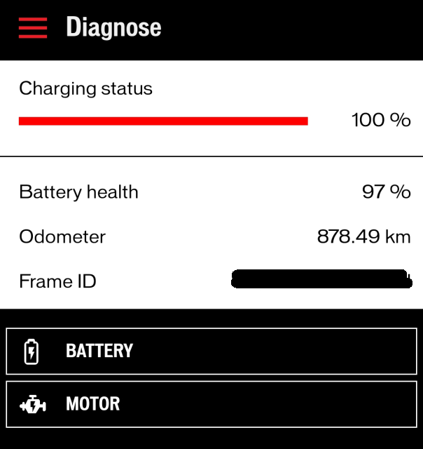

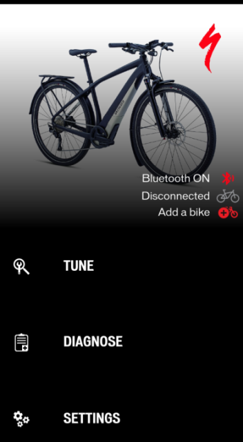

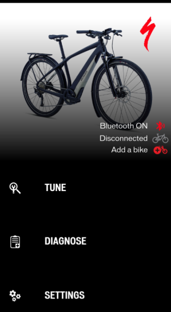

Friends! I'm so happy!
I was suffering because of the lack of connectivity between the BLOKS display of my Vado 5 and my smartphone. Not to be able to look "inside" my Vado was a terrible experience. Now, thanks to @TS25, I've got the unsupported "Turbo Vado/Como Tune App" installed on my Android phone and it works! It is almost as good as the new Mission Control app.
The start screen

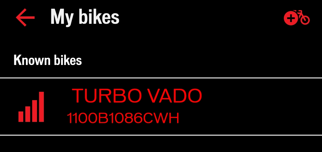

My Vado detected and paired by Bluetooth. The connection took a longer while.

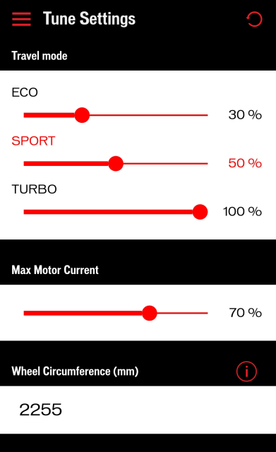

The settings. My Vado supported me too much in the Eco (35%) and in the Sport (70%) modes. Also, the Max Motor Current (Peak Power) set to 100% might be too much. I am dedicated to increase the battery range at the cost of performance. The Wheel Circumference was wrong for my bike. The Electrak 2.0 tyres are 51-622 and the wheel circumference is 2274 mm. The original value reports lower speed than the actual and shorter distance covered than it actually is.
What I really wanted to see was the "Battery health"

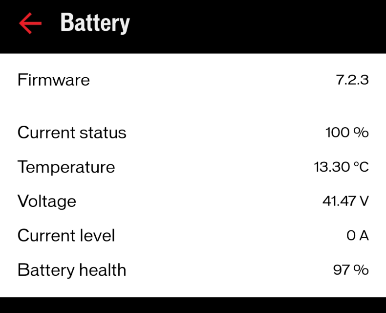

Battery details

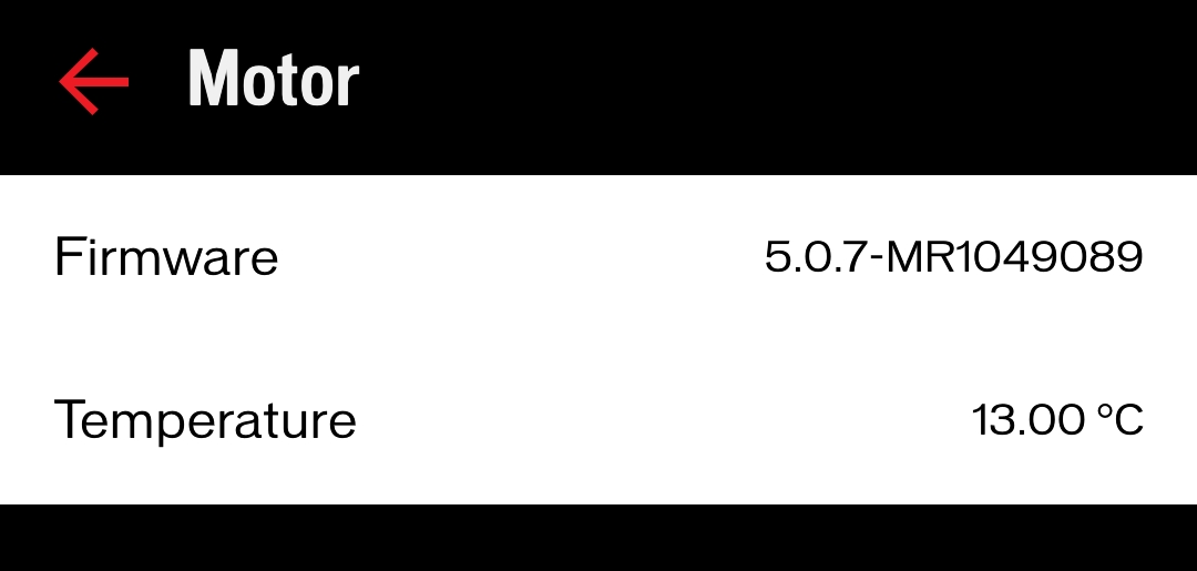

Motor details. 13 C is the current temperature in my garage.
Excited! Now I've got the detailed information and the chance to control my Vado!
