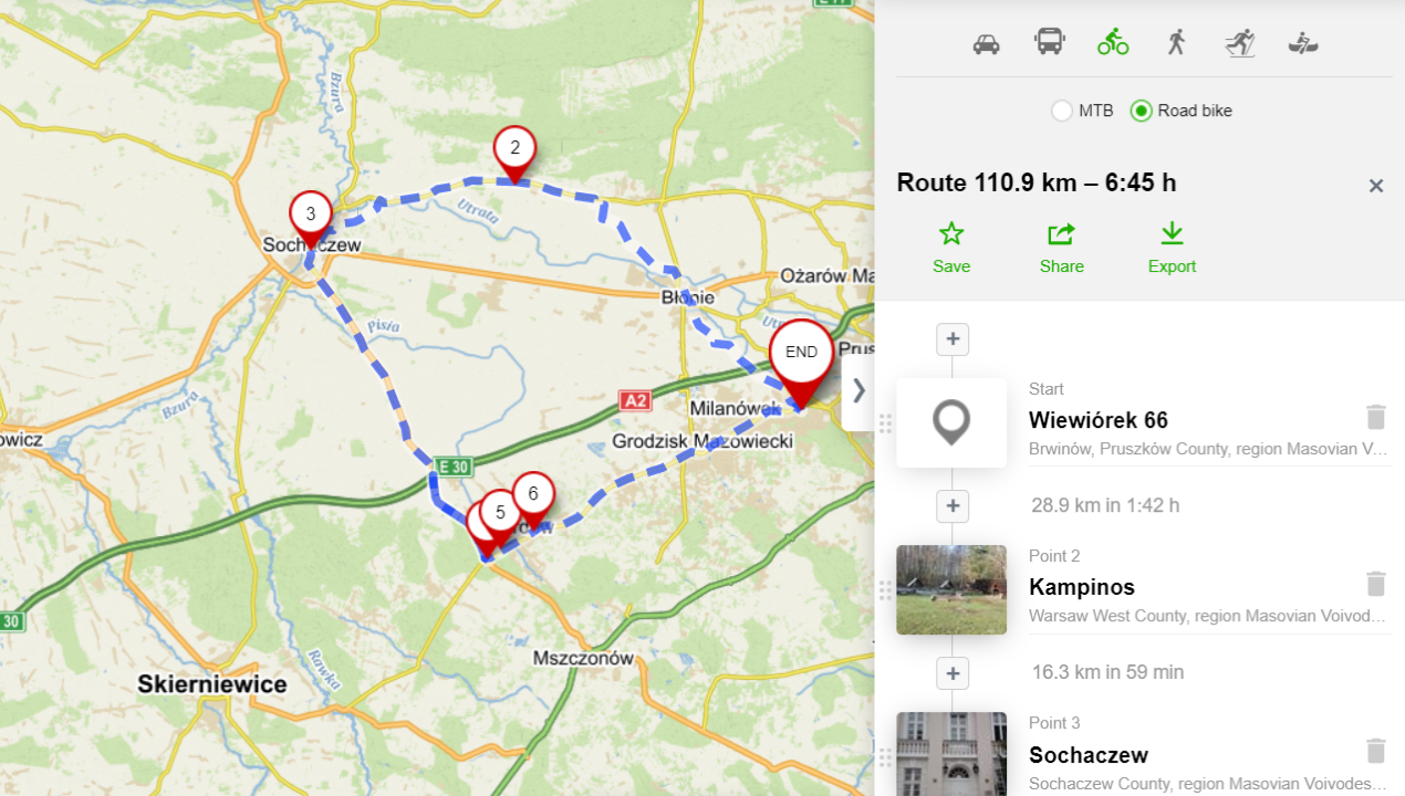

My goal is to be able to make a 100+ km (62+ mi) round trip to Sochaczew via Kampinos then return way via Żyrardów. Not that Sochaczew is an interesting city because it is actually boring but it is a good goal because of the distance ;) With my current range, that would require two batteries and riding in the Eco mode.
