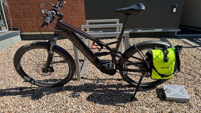

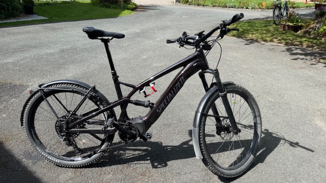

It‘s been a month and I promised pictures.
Sorry nothing spectacular, remembered to snap one with a sport roller on. My work computer fits nicely, plus my lock, a t-shirt, deodorant…
Did the work trip once every week now and I‘m still working out the best route. More options than I had with the Vado SL (I can choose steeper inclines and still make it).
So far I‘m happy. It‘s a nice ride. Should have bought a stronger pump though for the rear shock. Didn‘t know it goes up to 360PSI and bought a 300PSI pump.
Modifications: SQLab saddle and Bennies pedals (both moved over from the Vado SL.
And a bottle cage.

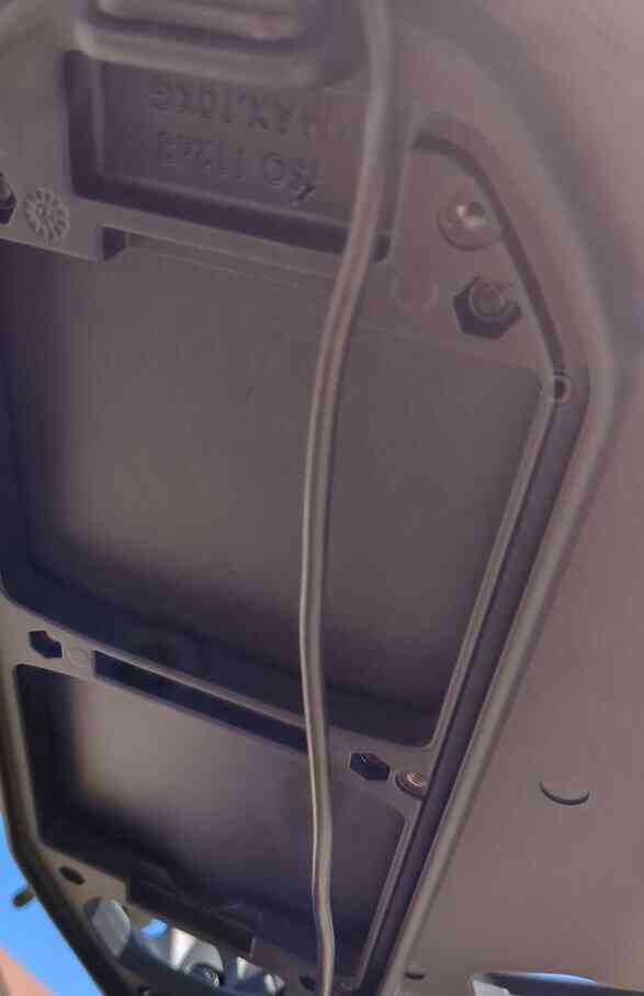

I've installed the front rack (as a customer, I have some things to say about it ! :D ) but I don't really need the plate, I would like a basket. I know Specialized sells one but I would like another one. Do I need a MIK adapter with this arm ? I really don't get how these things work...
