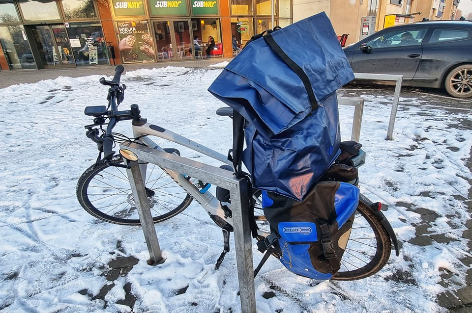

My Vado SL as of today: I'm doing grocery shopping with it, among others. (The big bag is a supermarket backpack).
Stefan - does the Vado SL do well in the snow?
Also - lovely pictures from the adventures!
Well, that's a tricky question. I personally cannot ride in a fresh or deep snow on any e-bike. My gravel cycling mates can do it, and the tyre size of the Vado SL falls into the "gravel bike" territory; so the problem is me here. Now: I use Schwalbe Marathon Winter Plus studded tyres in size 35-622 on Vado SL during the harsh winter (the maximum width for the EQ is 38 mm). These tyres are excellent for riding on the ice and they do well on packed snow.
Thank you very much!

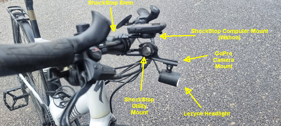

Stefan, how did you get the ShockStop suspension stem on the Vado SL? My SL 4EQ stem has the integrated light, not keen on removing it. I did replace the seatpost with an a cheap Bontrager suspension post, just upgraded to the Cane Creek eeSilk.
Well, I was motivated to do it. The shortest path:
  • Buy the Redshift ShockStop stem
  • Buy Redshift Shock Stop Utility Mount, with the 31.8 mm shim if available. (If the latter unavailable, get yourself some rubber pieces)
  • Buy a good bike capable GoPro out-mount.
After installing and configuring the ShockStop stem, install the Utility Mount. Then, install the GoPro mount on the Utility Mount, possibly either with the brand shim or with a makeshift shim. Just install the Lezyne headlight on the GoPro mount.
I need to mention I didn't do that change in a single step! Originally, I just used the ShockStop Stem and the 31.8 GoPro mount installed at the left off the stem.
