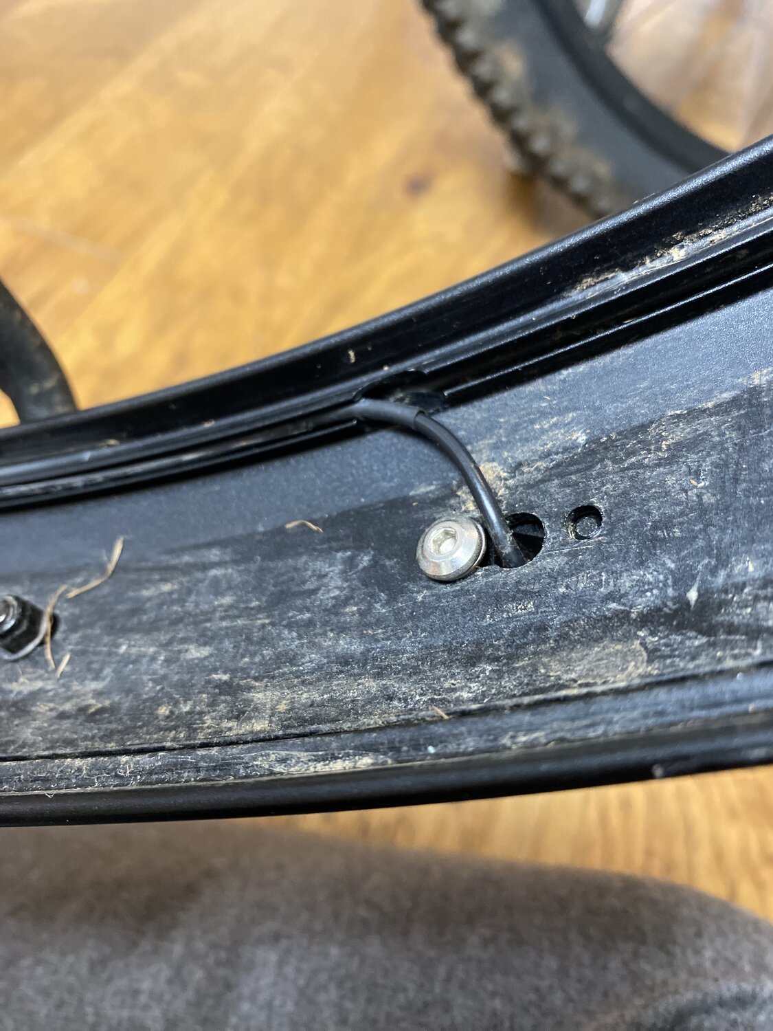

Hello all,
Today after my ride I noticed my taillight wiring hanging down. I'm lucky it didn't get caught and torn off. I'm just wondering where is sits under the fender. I don't see a dedicated tube or clips or anything to hold it. I haven't taken the wheel off yet, but peeking up under the fender, I don't see a place for the wire to ride. My guess is it rides in one of the channels that are on each side of the inside of the fender? Have any of you had this wire come loose on you and you had to put it back in place?
TIA
In my Vado (which is not that different to Tero X), the tail-light wire indeed goes all the way under the fender on the non-drive (left) side. How is it actually fastened? I would have to remove the rear wheel to find out! (I do not want to do it).

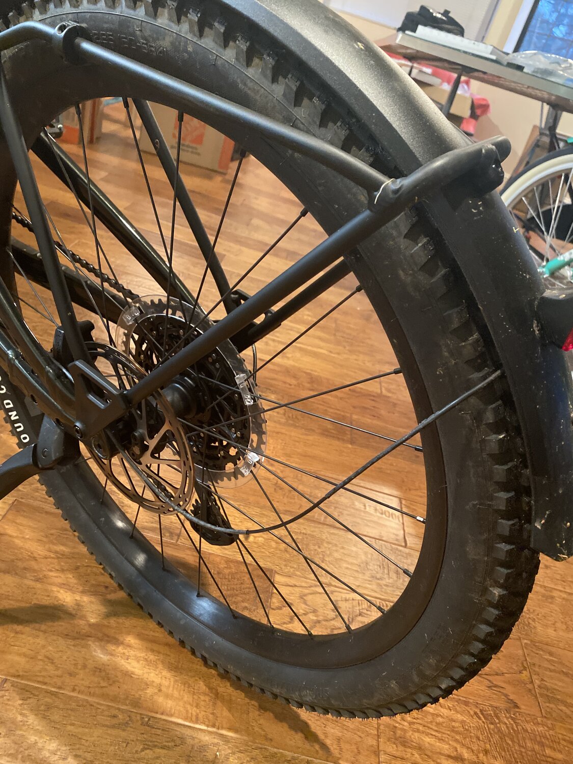

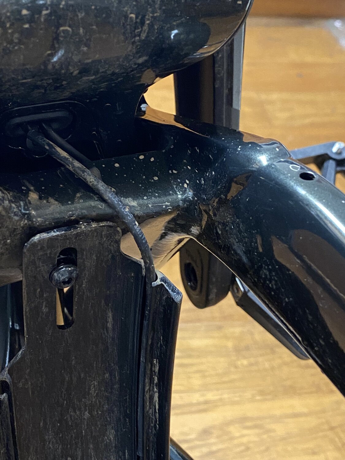

Alright, I figured it out. There is a sleeve over most of the taillight wire, and that sleeve sits fairly tight in the extruded channel on the left side of the underside of the fender. Here are a couple pics. Apparently, I must have picked up a branch or something that that wedged between the tire and the fender and pulled that wire out of the channel. That, or it was never all the way in place correctly when I bought it. Anyhoo, it's all fixed not and I'm just waiting for a break in the rain here in Northern California so I can get out and ride :)
