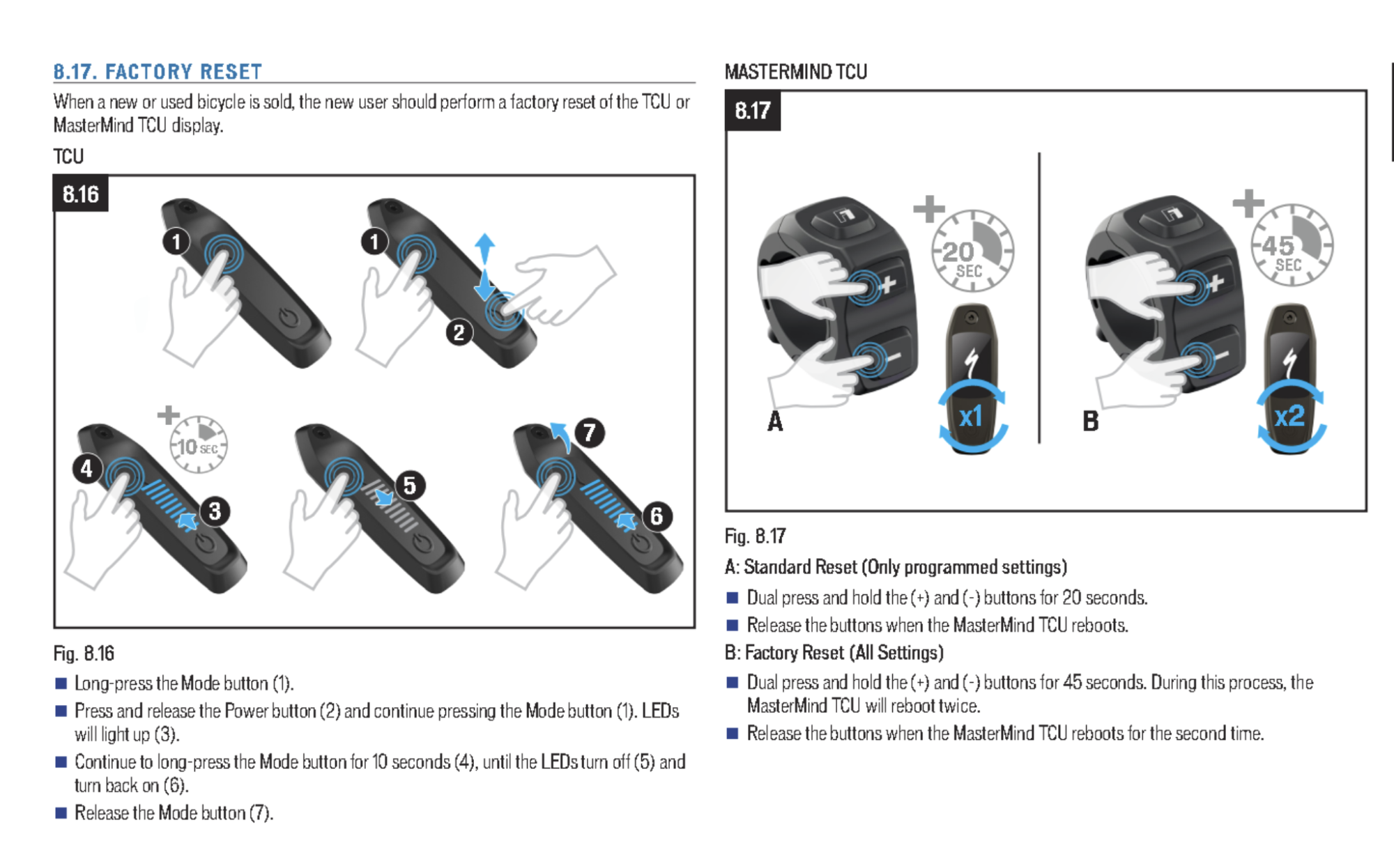

Try holding the Power and Mode buttons down at the same time for at least 20 seconds. See if that resets it.

You say "Brose". It is not Brose (the motor is). It is Specialized. Specialized has made a whole own infrastructure/architecture around Brose and Specialized SL (by Mahle) motors. For instance, @Homestead has an unusual 400 Wh battery with Bluetooth, which was briefly made by the end of 2010s. You cannot just take any remote and hope it would work. You cannot reset the older generation TCU the way you do it with TCU SL 1 or Mastermind.

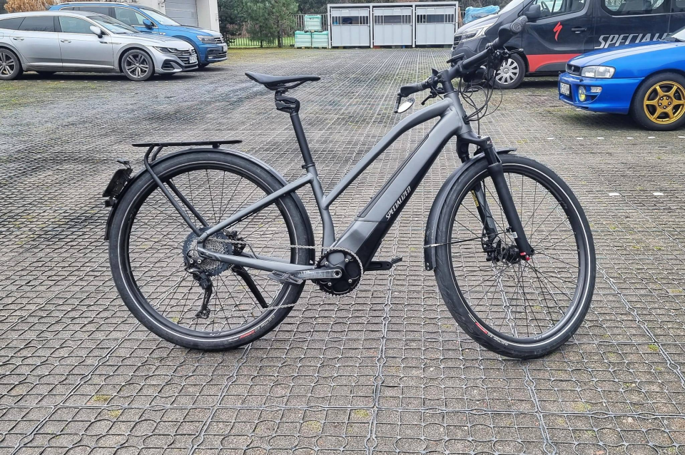

The 2021 Specialized Turbo Levo Hardtail is an unusual e-bike, which was produced in a short run. Its electronics is unusual. Only Specialized knows what parts are compatible and how to make the things work...
A 2017 Vado 5.0 (45 km/h). 1 November 2019.
A 2020 Vado 6.0. 17 January 2023.
It is the same e-bike but is is totally different at the same time. Only Specialized could make it.
