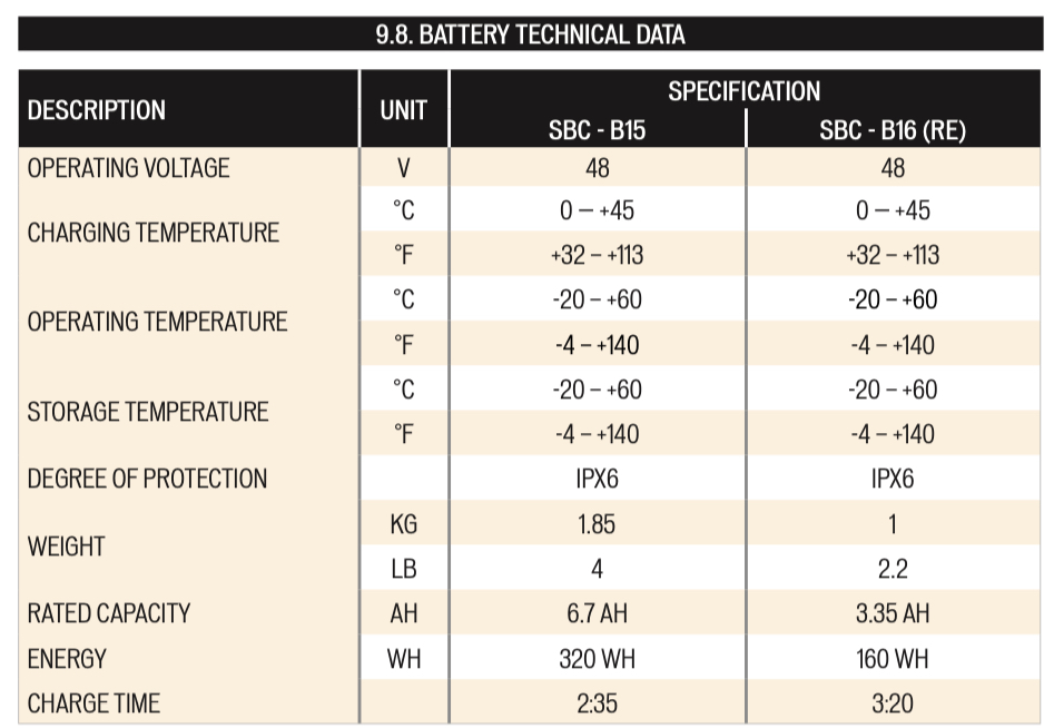

For leaving outside or riding - probably not for my bike at least given my usage habits. Charging - yes, because ambient air temperatures don’t reflect physical temperatures. Check in the user manual and you should come upon a chart that goes into details like this one for my Vado 5 SL :
Who knows though given the weather lately. I’d check the battery with my hand - if you can’t comfortably touch it don’t use or charge it, or leave outside.
Also COLD can kill your battery! More easily than heat if you live in very cold climates.
Thank you, VoltMan99. I will do as you suggest. You have given me the inspiration to actually read the manual. Shame on me for not doing so!
