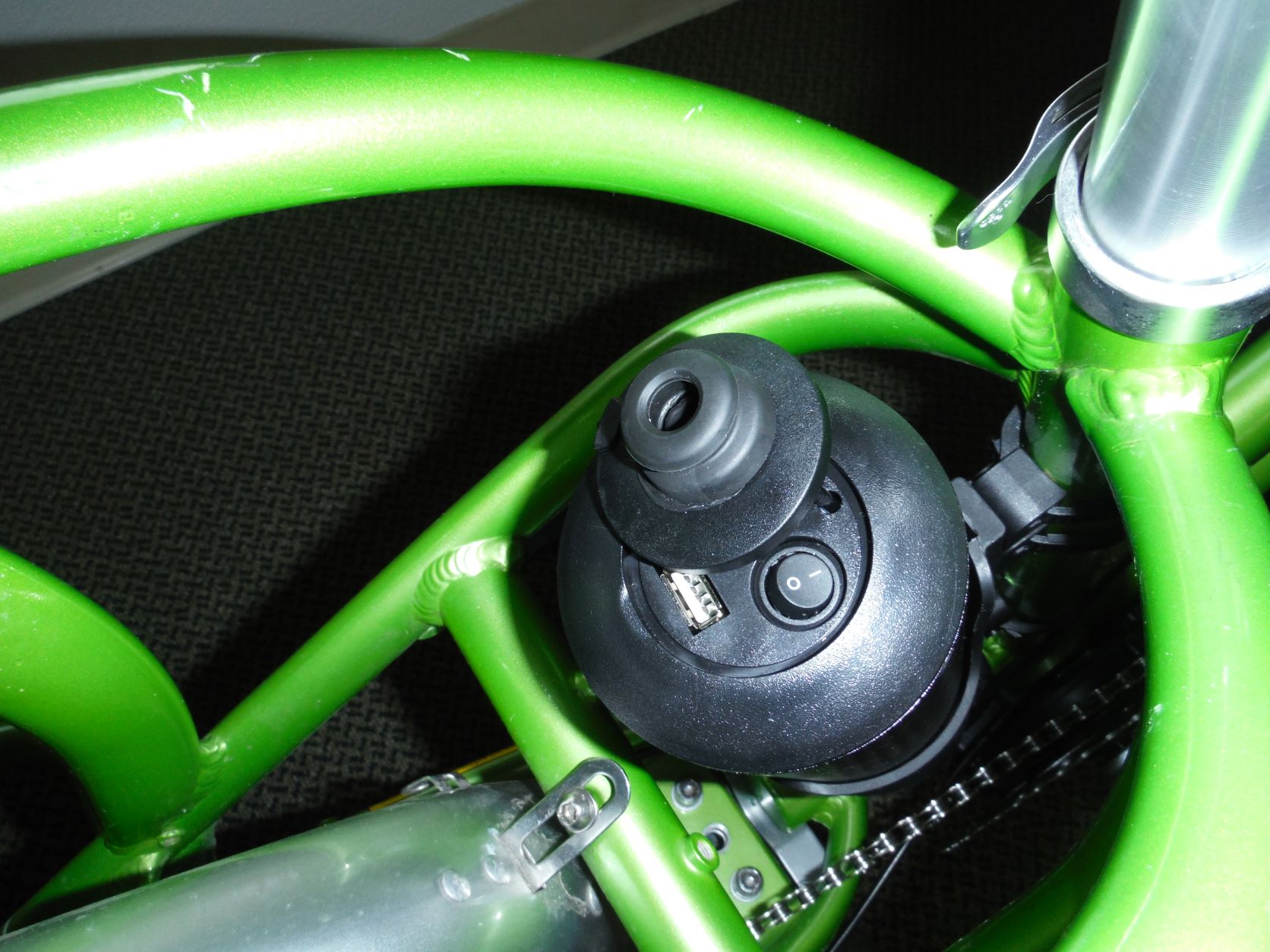

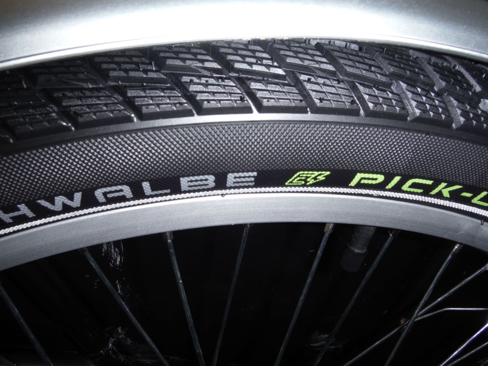

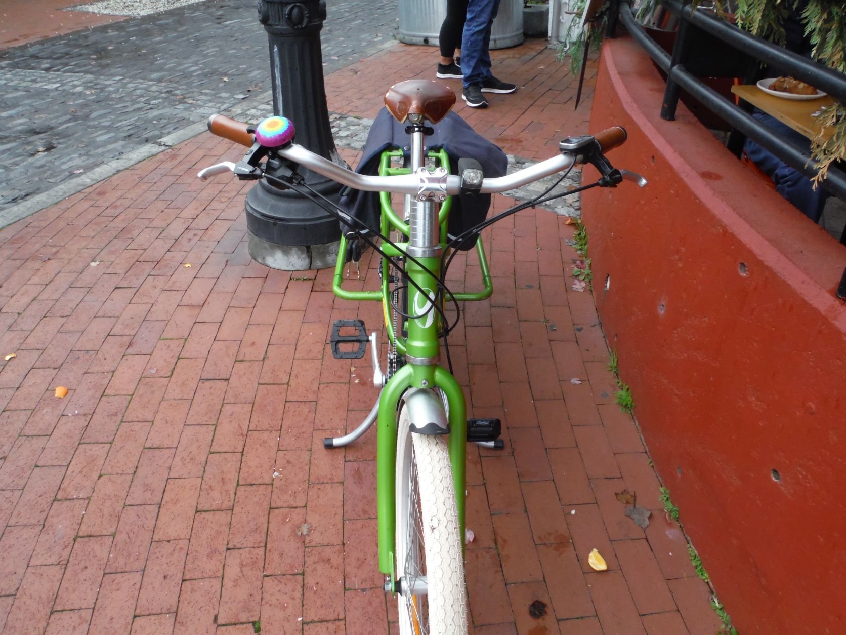

The real limitation with the Roll are the wheel builds. They will taco with that weight when hitting a bump. The crash could be devastating. I would say trade it for a compact cargo bike to convert with a mid-drive. The Roll is a great bike. Someone needs it. Cargo bikes are extra sturdy. Many people purchased non-electric cargo bikes when their kids were little. Then the kids got big, so the bikes are just gathering dust. Also get PickUp cargo tires that each hold 350 pounds without flats.
