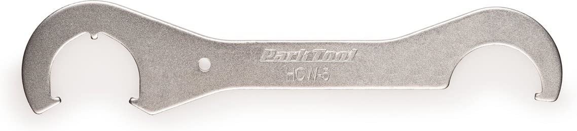

There is another option. As you know you have to remove the pedal in order to use the TSDZ2 lock ring tool. I have a Park Tool HCW5 that using the one tooth side has worked well for me when I just wanted to check that the lock ring was tight without having to remove the pedal. It is made of sturdy steel and seemed to me to be up to the task without damaging either the tool or lock ring.
