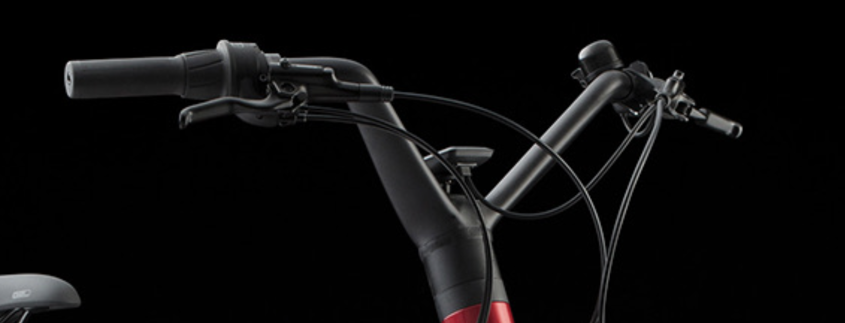

What I'd like to accomplish is get a new 2022 Vado 5.0 and stick the Como 5.0 (NON-SL) handlebars and stem (inclusive of all required fittings, clamps, etc., etc.).
Hey, it works for me. And if it can be done, it's done. If it can't, then it can't. But I want to try.
I love my wife's new Como 5.0, but I like the "feel" of the Vado 5.0 a tad better (for me), and I don't want to go the stem riser route and all that baloney, just make it simply like the Como.
Anyone ever attempt it or try it?
I'VE FOUND THE PART NUMBERS, ALL I CAN DO IS REACH OUT TO THE LBS AND SEE IF THE PARTS CAN BE SOURCED AND THEN BUY A VADO 5.0.
Here are the numbers I got from the Como owners manual. Hopefully they are correct.
S212500025
HDS COMPLETE, INTEGRATED, 1-1/8" UPPER BRG (45X45), 1.5" LOWER BRG (36X45), 20MM TALL CONE TOP COVER, W/ CROWN RACE FOR 1.5" TAPERED STEERER (HS-S-03)
Headset for all Como models
S210800013
BAR MY22 COMO HANDLEBAR, 680MM
All Models of Como
(Different than Como SL handlebar - externally routed cables)

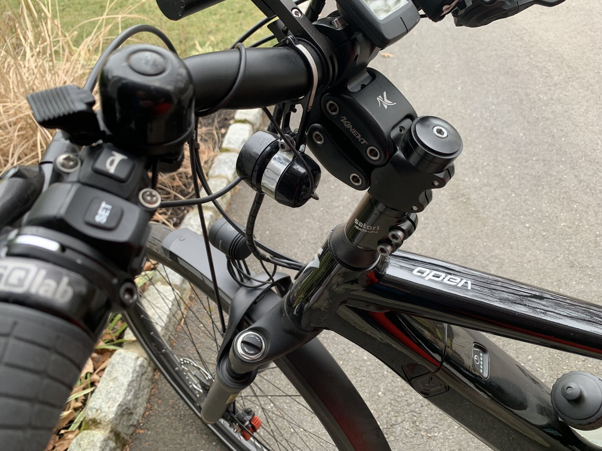

I had a 2021 Vado 5.0, and I used the stem riser, and the "old" Como style handlebars, but.....I did not like the look. The comfort was what I expected, but it just seems like a clusterfuxx of parts to achieve what is so elegantly done by the new Como 5.0. Hence my new desire. Photo for reference (what I had and do not want to duplicate that)
