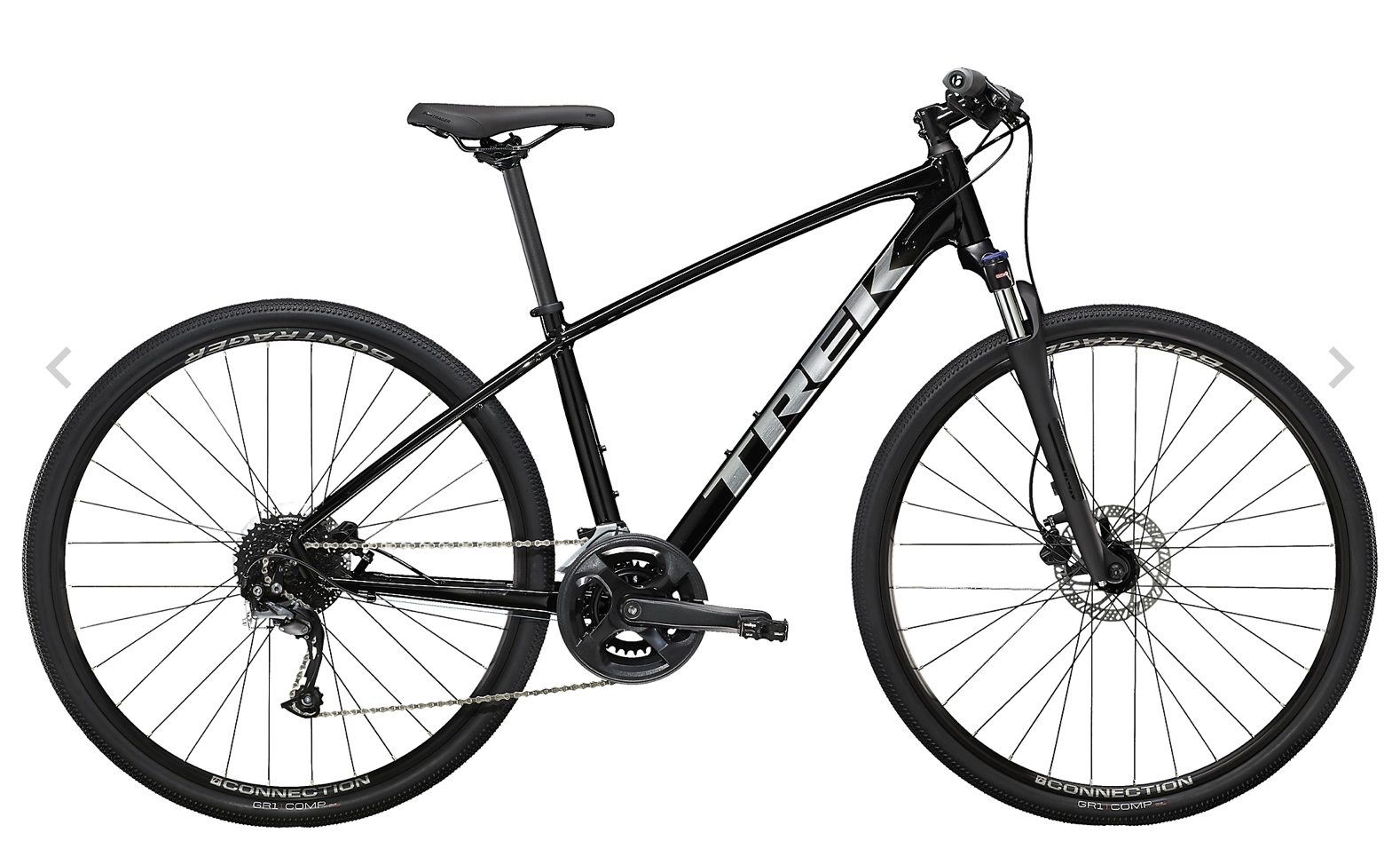

Trek Dual sport 2. I am for sure going to install mid drive. I really want the torque sensor. I ride normally without assist 25-30 miles about 5x week. Since I will get assist, I need to extend the range. I still want to get an equivalent amount of cardio. So I don't exactly know how much distance and time to add to my normal ride.
That looks like a very nice bike. Since you indicated that you have already read up about mid drives I'm sure that you are aware that about the only common torque sensing option is the Tongsheng TSDZ2, which I think would be an excellent choice given what you indicate. It does look like you will have to deal with cable routing if you have cables that run under the bottom bracket. If your down tube has a prominent lip at the bottom bracket where the cables exit that could be an issue with fitment - again I'm sure you are aware of that already from your reading.

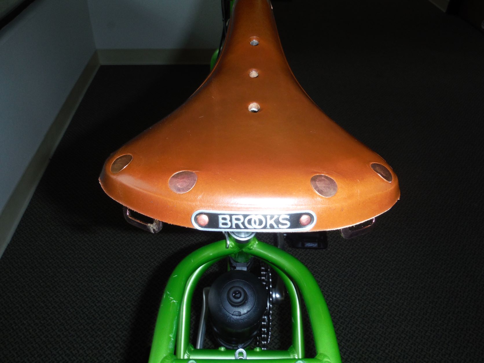

The underside of a Brooks saddle needs to be treated otherwise it is as hard a wood. I use glycerin, and bran oil. Then bounce on it with my heals until it gets springy. The final part is using equine leather products on the underside. Then it is nice. The best.
