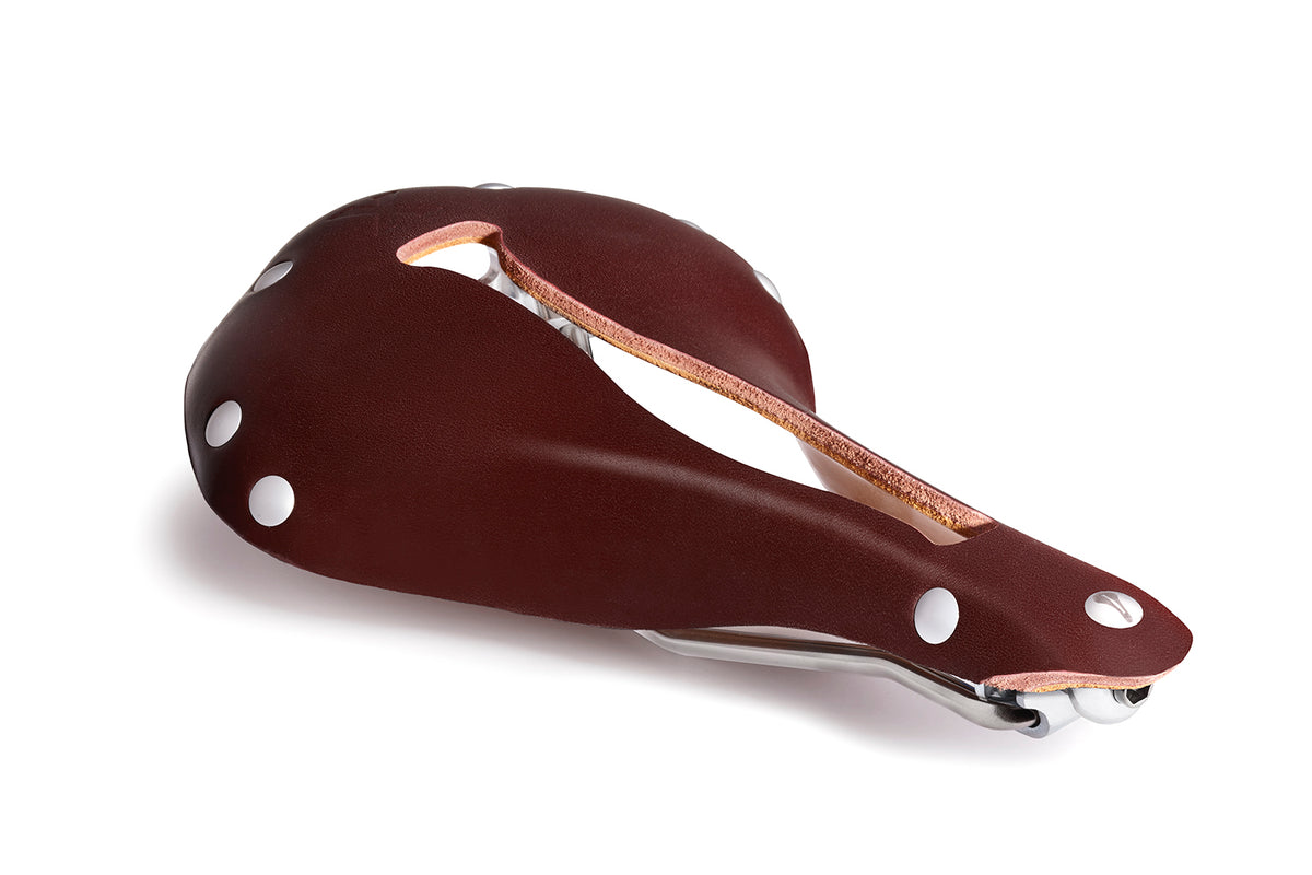

I have the Vado 5 SL EQ. The supplied saddle looks like yours and it didn't work for my 175 lb bony ass. It was too stiff. I gave this saddle a try & it is working for me.
It takes a few rides to get it tensioned correctly because the leather stretches. As the leather stretches it can be retightened. It works on the principle of making a hammock for each sit bone. What I noticed immediately was less pain in the butt the next day. It probably won't work for all shapes and sizes of riders but it worked for me.
