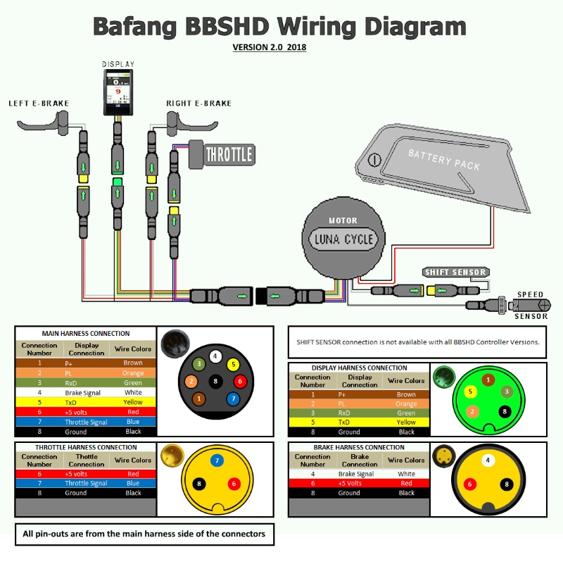

This is the diagram for a BBS02 middrive. but maybe your display harness side is the same for the hubmotor. I believe they do use the P850C in the mid drive kits.
Many controllers will work without a display. For this bafang, the P+ is tied to PL at the display connector to do that. Hard to do though because it's male pins.
