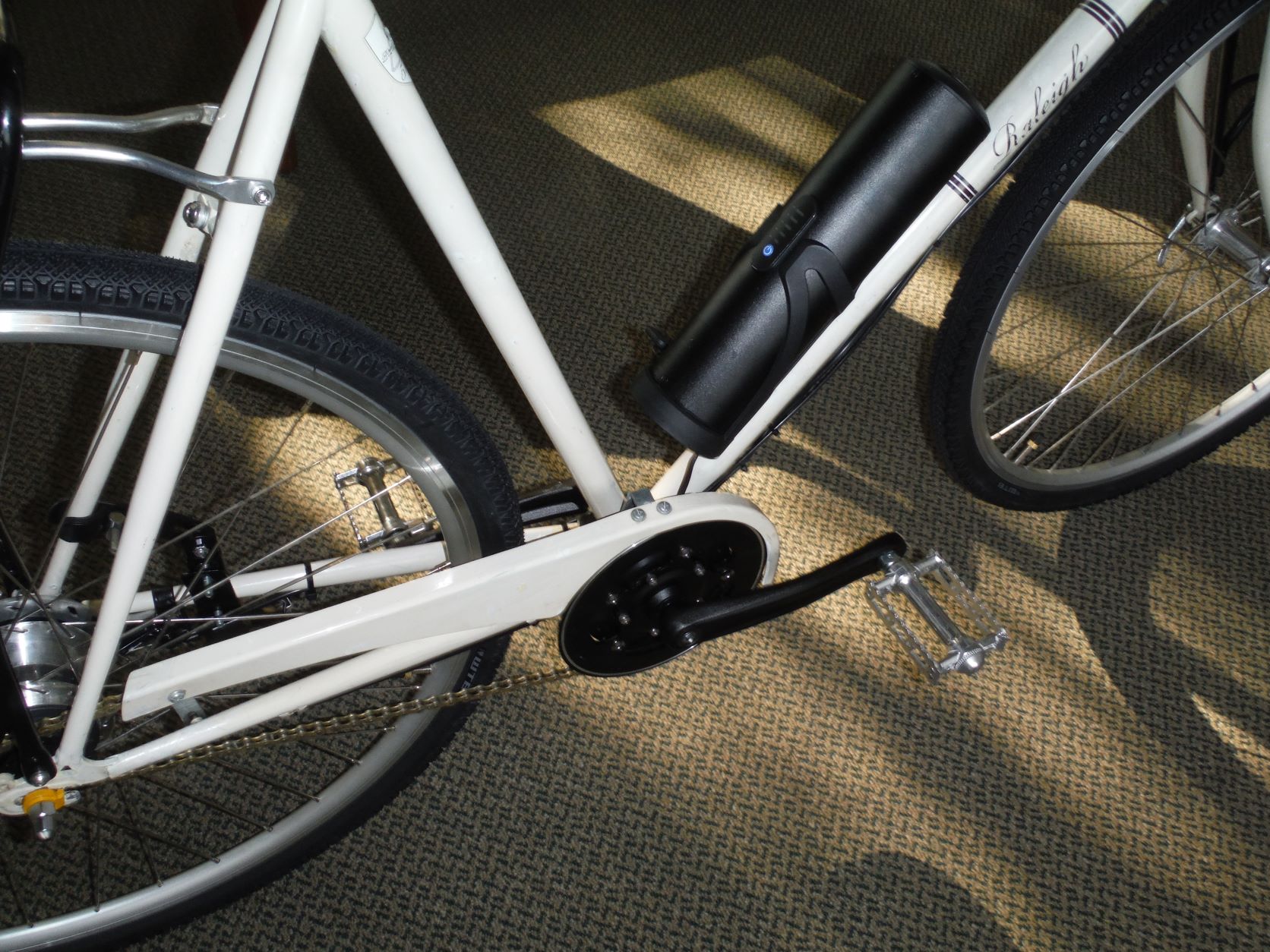

I opt for an extra-wide chain to an IGH. These super strong chains are about $20. Replacement cogs are hard steel and cost $5. The extra-wide chains last about as long as a belt. With ceramic nano boron lube they do not pick up much dirt and it is easy enough to rinse them with a low pressure yard sprayer. Most belts require a belt specific frame adding even more to the cost. Chain driven bikes do not and there are many to choose from. Belt sprockets are aluminum and ware down, the fingers snap off and they are expensive to maintain. Here is a chain electric bike to an internal hub of gears. See how beefy a chain can be? Chains do not need to be unattractive.

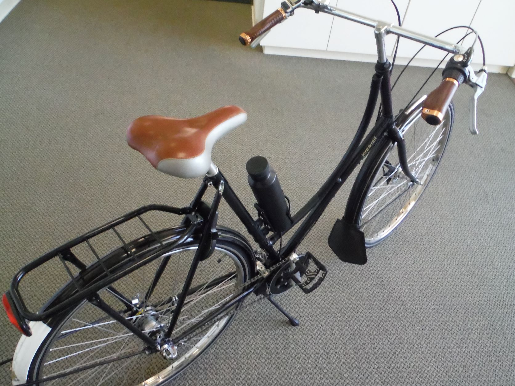

Some of European brands like Gazelle and Cube have bikes with enclosed chain guards. Chains only need lubing every few months. These bikes tend to lot cheaper than beltdrive bikes.
It is hard to install the motor with most enclosed chainguard systems. The closest I have come is just an open chainguard. I have found that with the enclosed ones people tend to forget about it, neglecting the chain. And the enclosed ones are a pain to open for maintenance. I am wild for the Dutch bikes. And, yes, they traditionally have enclosed chainguards. Here is an electric bike with a chainguard and and electric Dutch bike.
