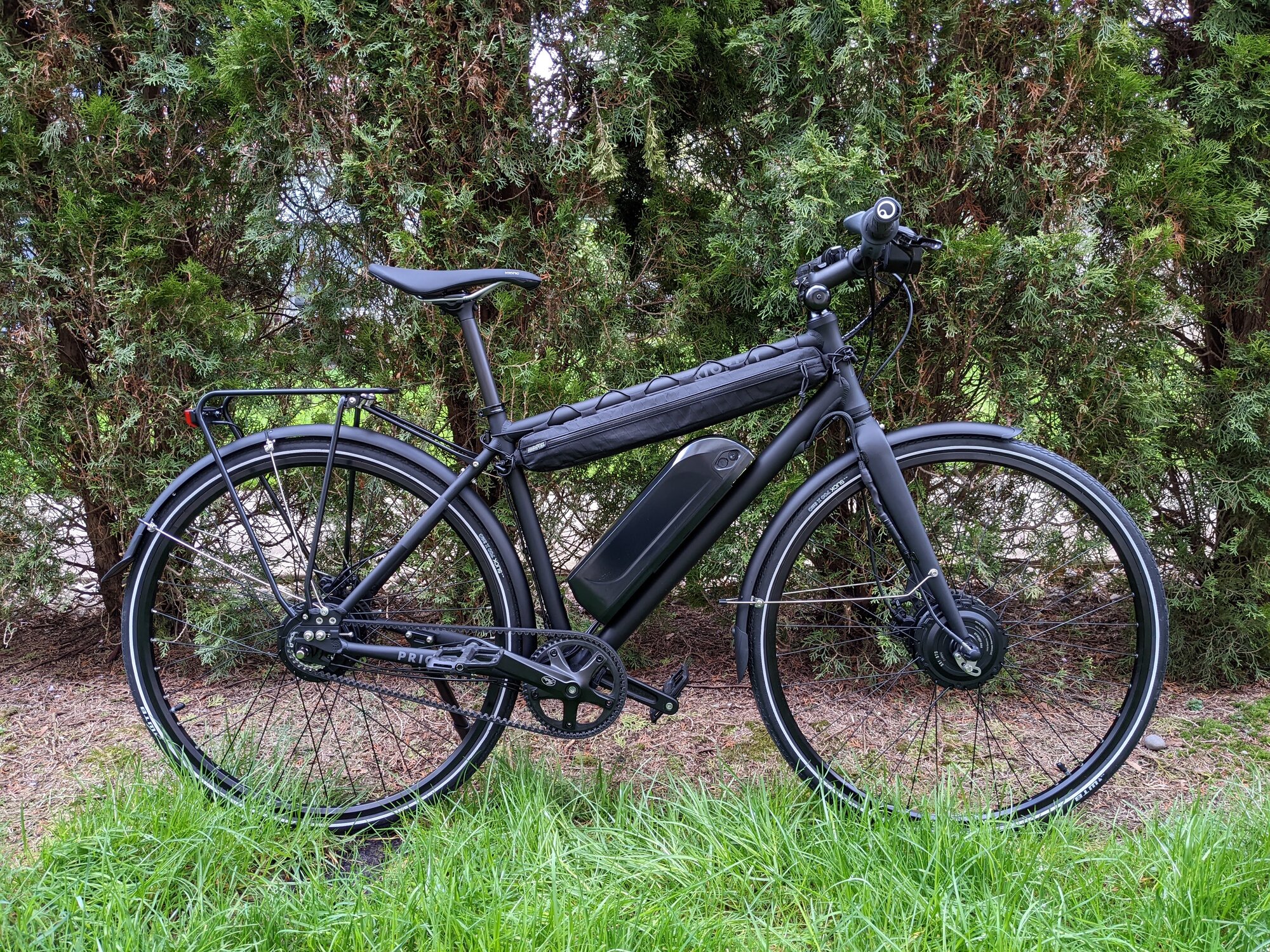

Second Conversion - Priority Continuum Onyx Build Thread

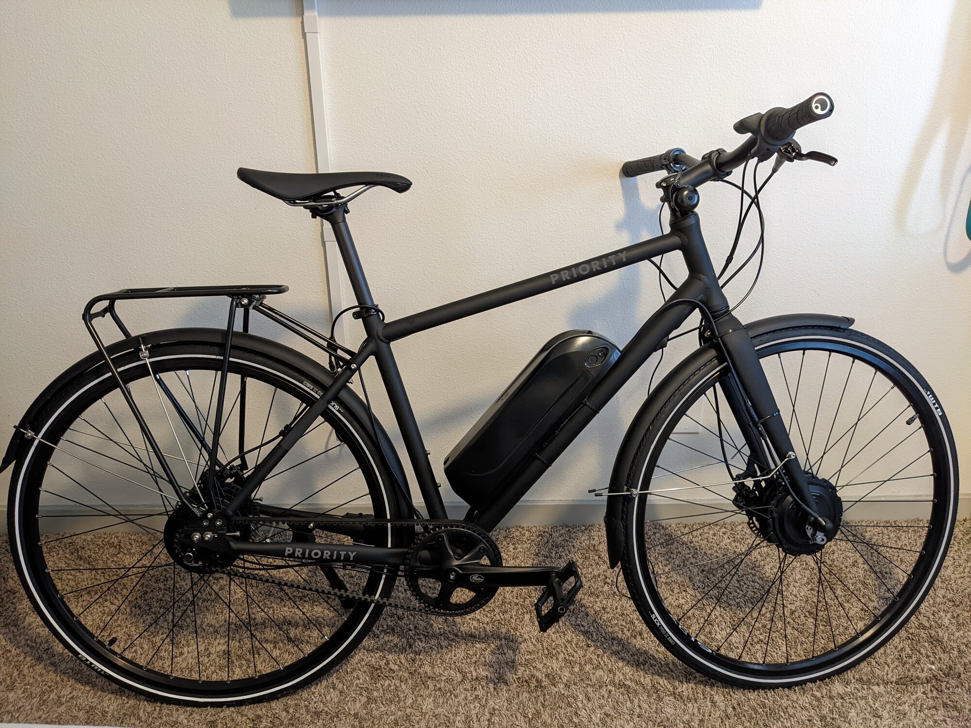

...a bit compact (went with a 19" frame size, should have gone for the 21").

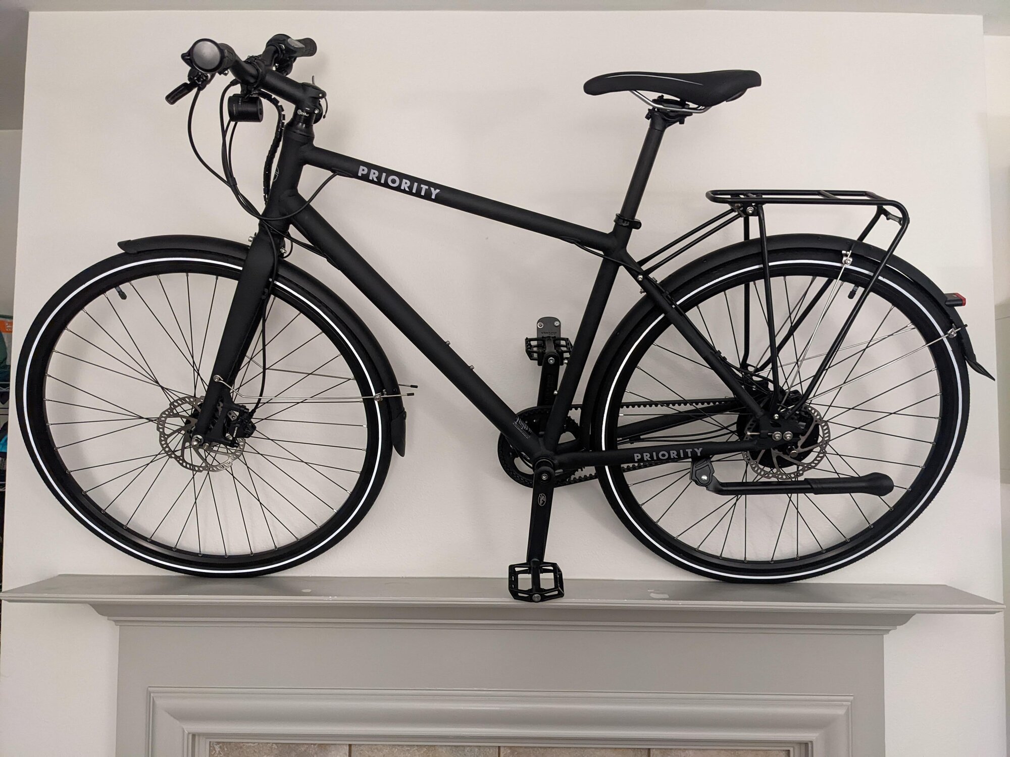

What is your inseam? I'm considering this bike as well for conversion and trying to decide between two sizes.

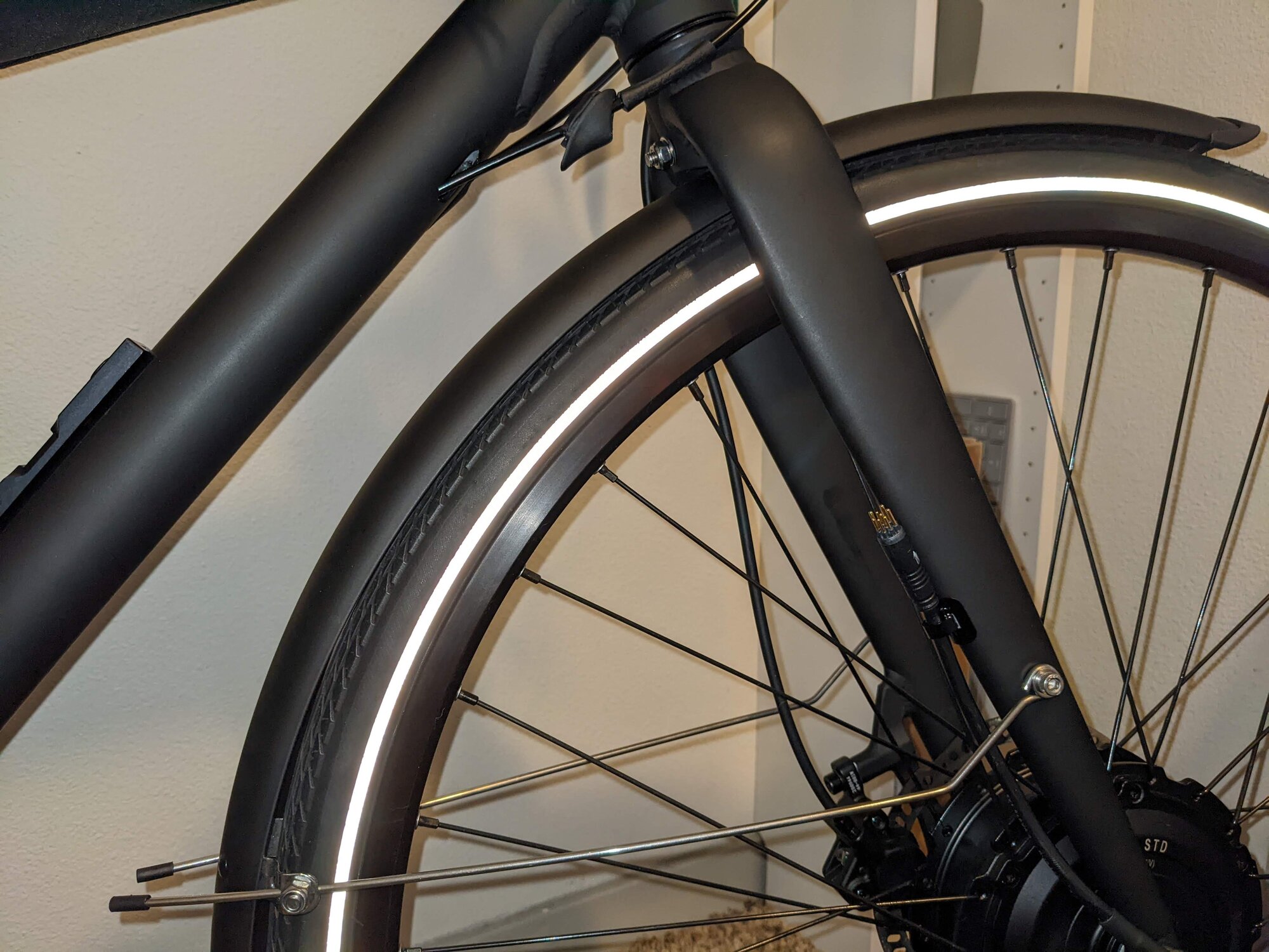

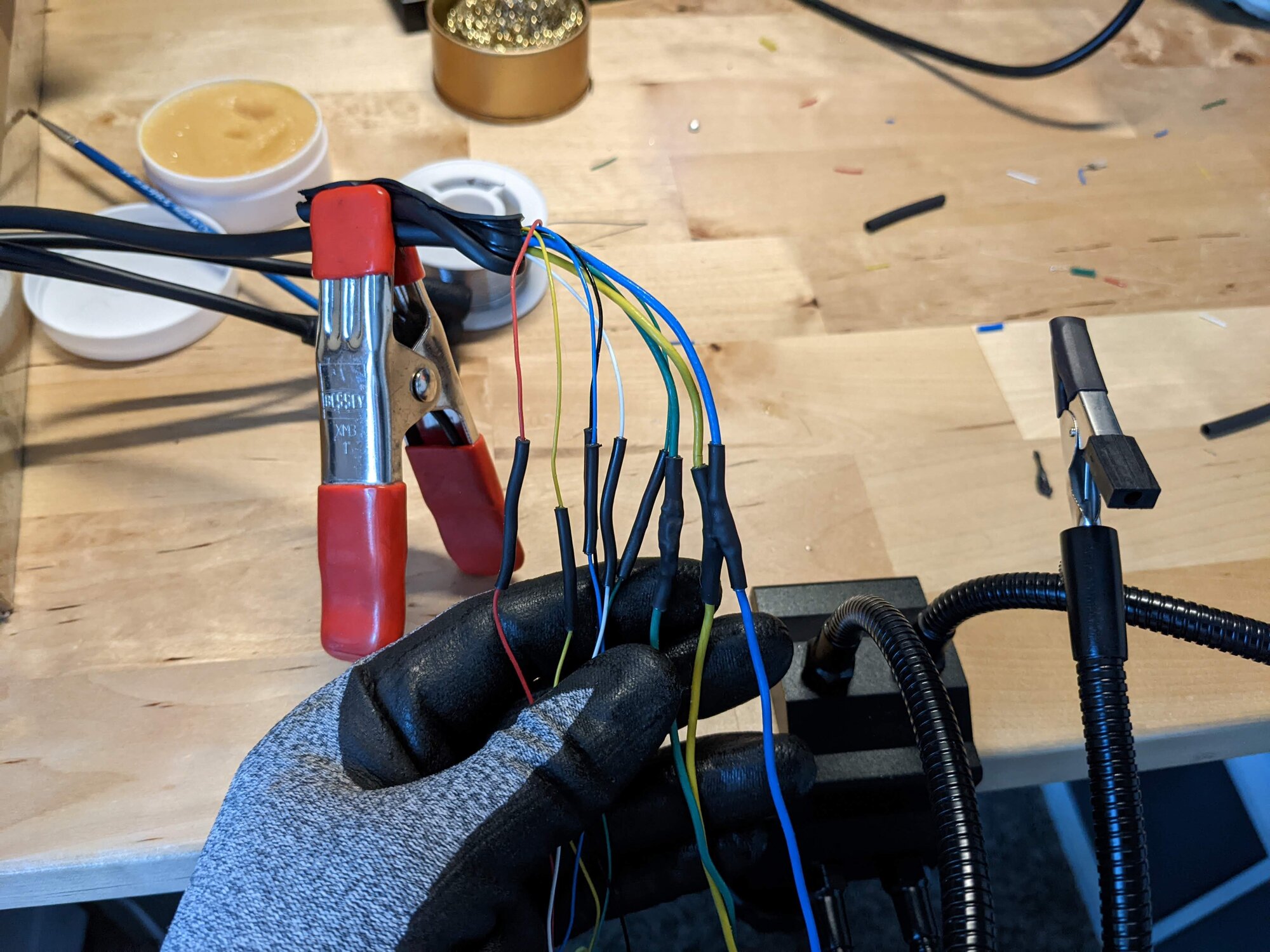

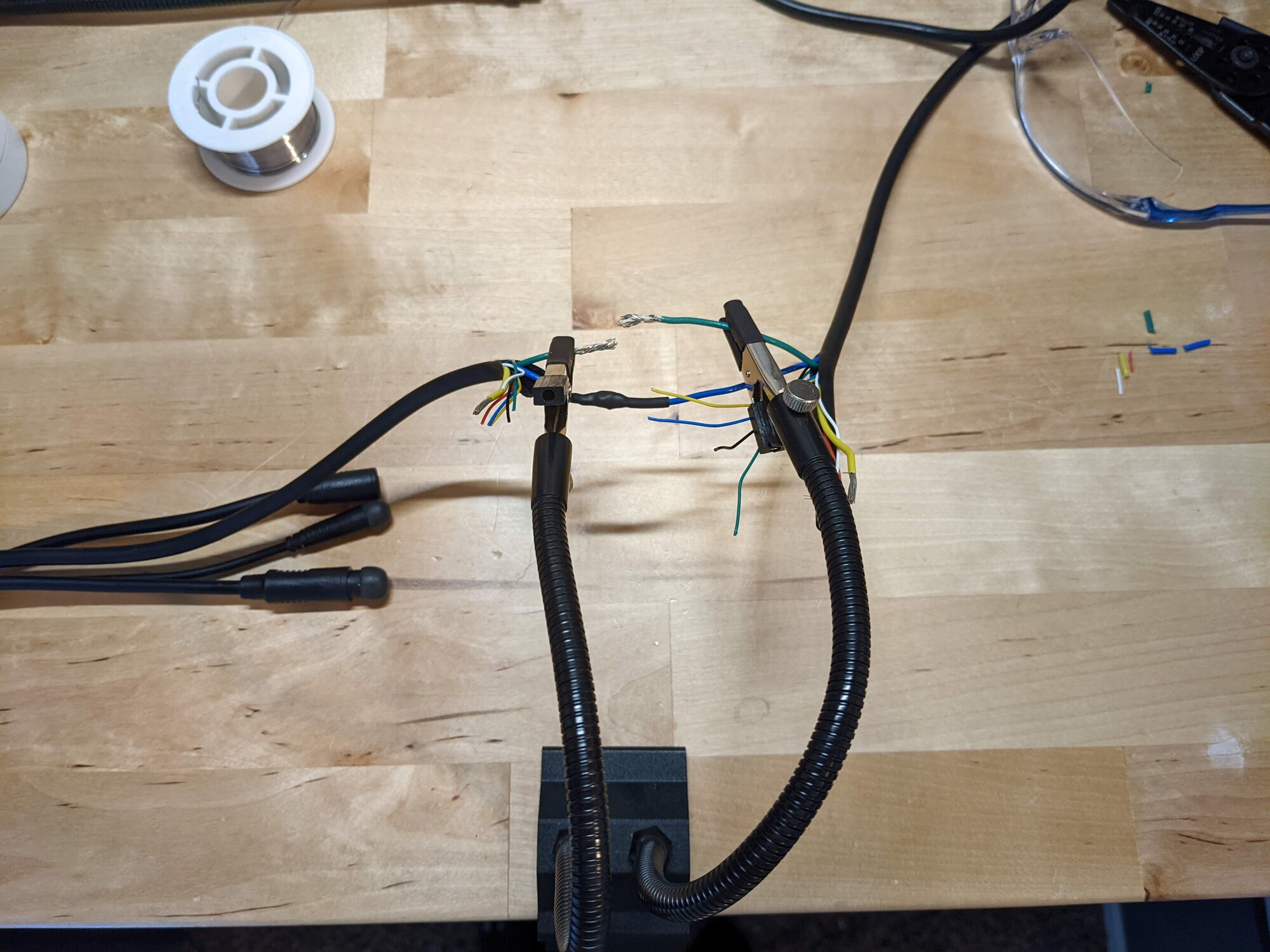

For Higo/Julet cables, if water resistance is your bag then you really want to add a dab of dielectric grease to every one of those connections. They are indeed pretty much waterproof. The grease will take that a step further.

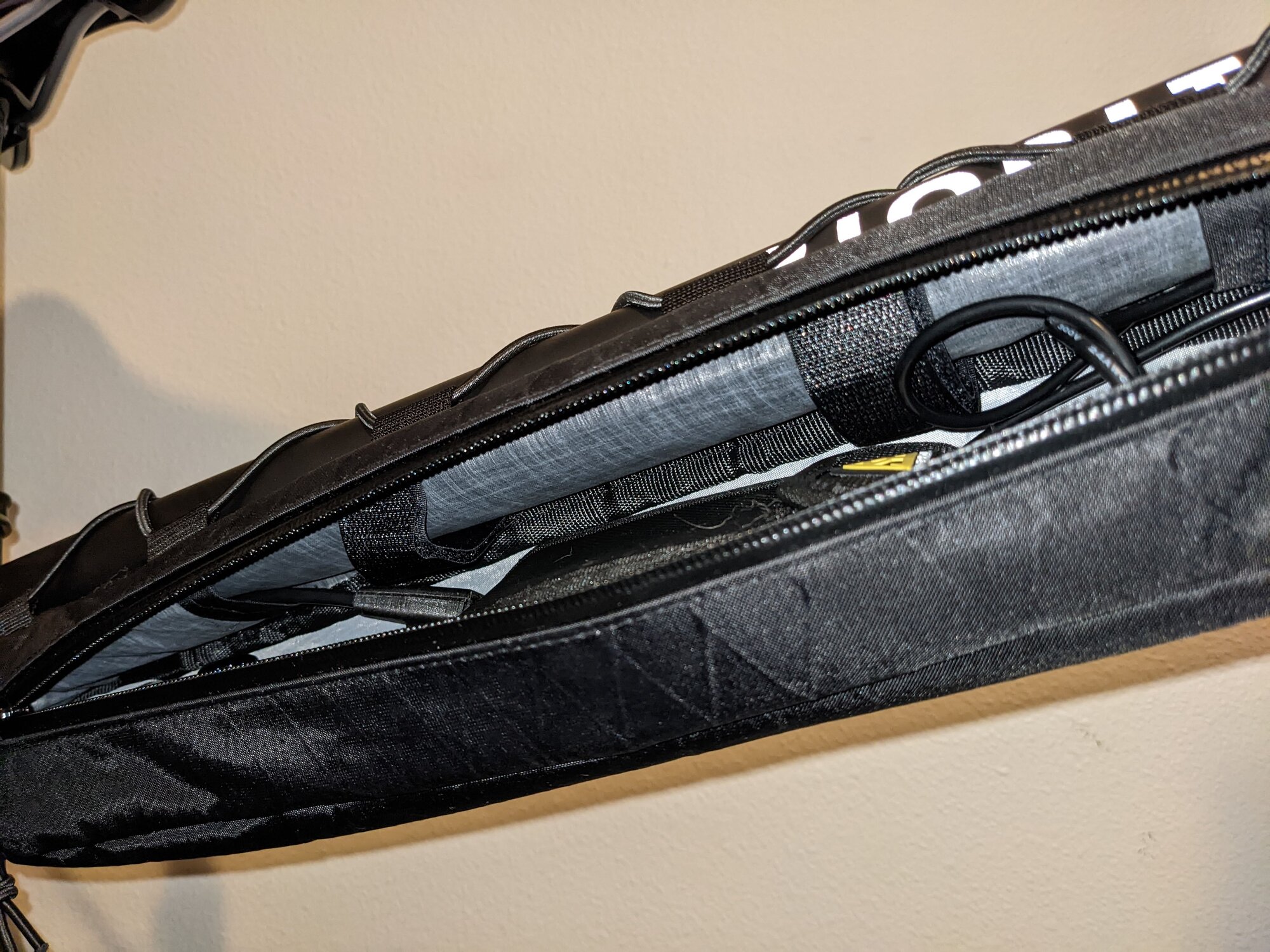

Completely agree about the CA comments and am not keen to wait for Grin's solution if I can figure out my own path. I'm fairly against using a CA unless its tucked away in my frame bag, out of sight & mind with maybe a handle bar PAS switch. I debated going this route initially but leaned more towards the simple and minimal setup.
I have a 32" inseam and am just at 5'11" tall without shoes and 6' with most shoes I'd ride a bike wearing. I went with the 19" because my spouse is shorter than me and I like having the option of her taking my bike for quick rides with a saddle adjustment. I come from a traditional road biking background and understand bike fitting for proper power output & ergonomics; the frame size is fine for both for me. That said, I would have probably liked the larger size strictly for the longer top tube to open up more opportunities for shorter stems or more swept back/wider bars.
Edit: Also cannot recommend this bike enough for a conversion. I will say that Priority will void the warranty if aware of your conversion though, so just be cognizant if you think you'll need warranty support in the future. I've never once used a warranty on any new bike purchase so I'm not concerned.

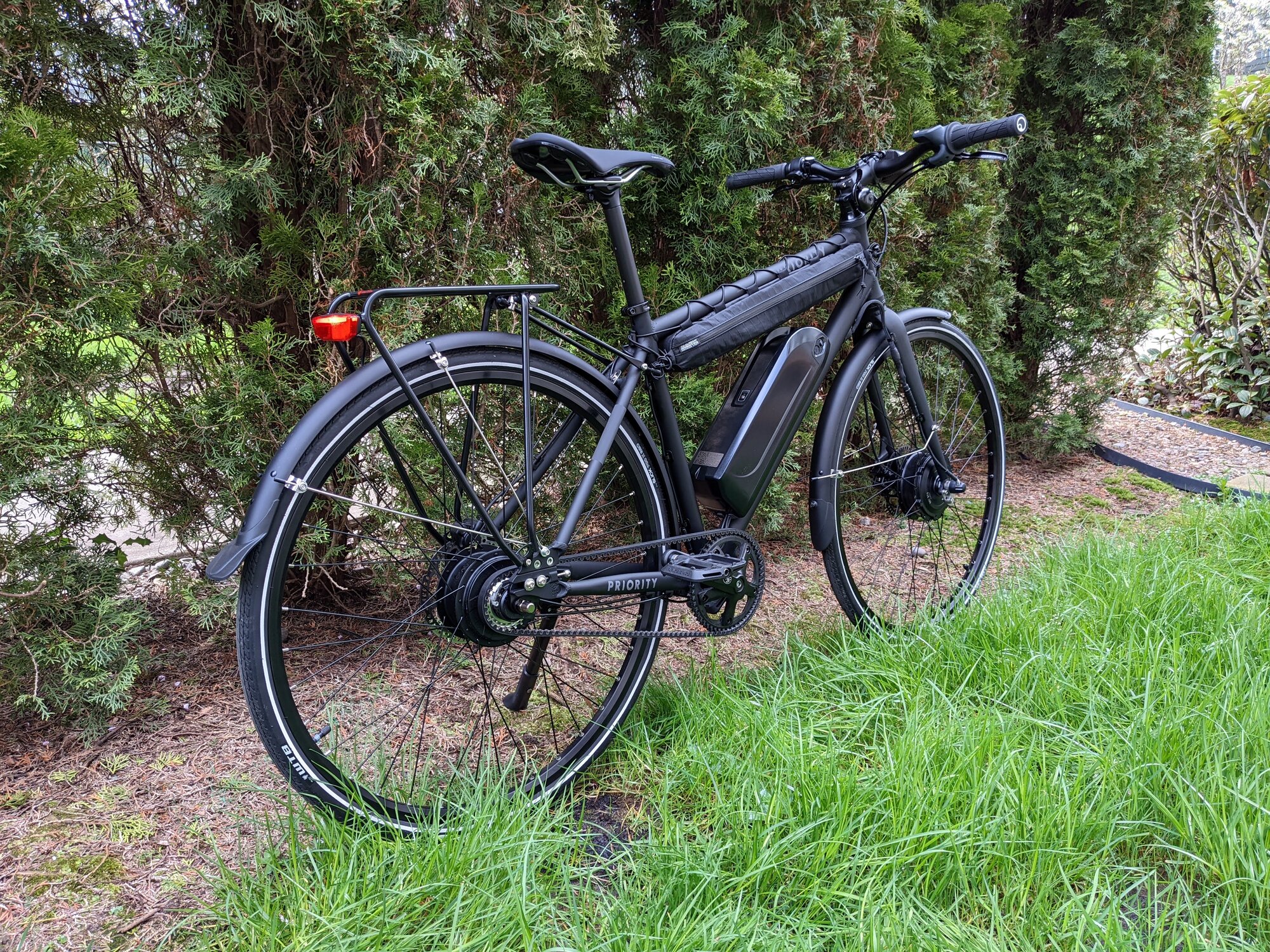

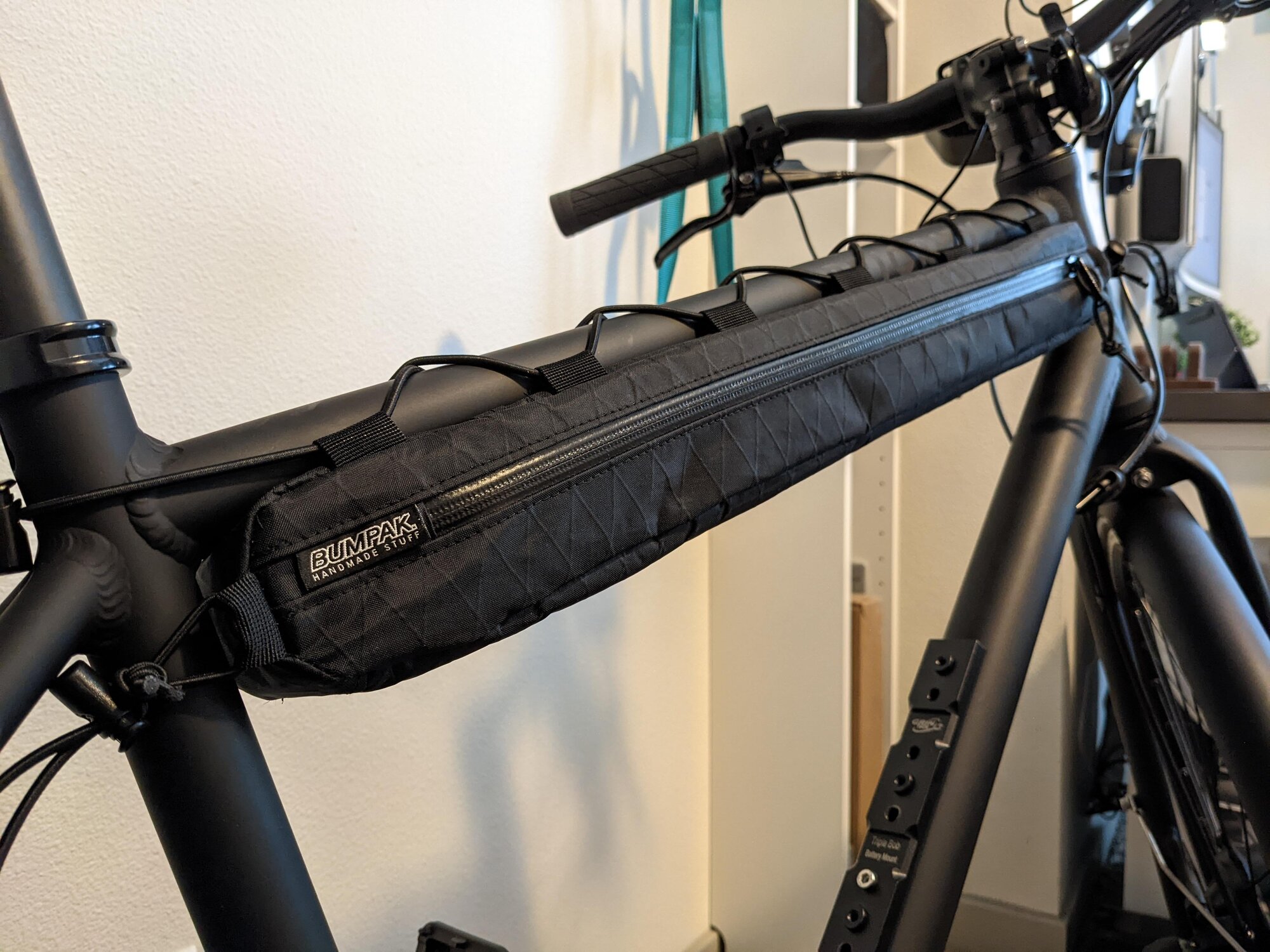

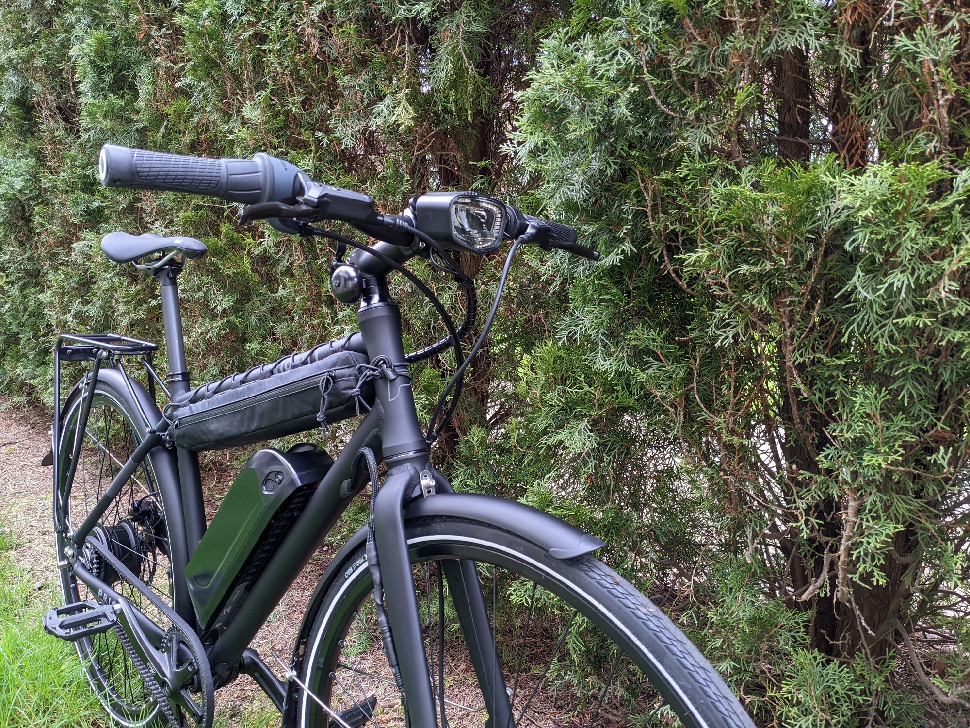

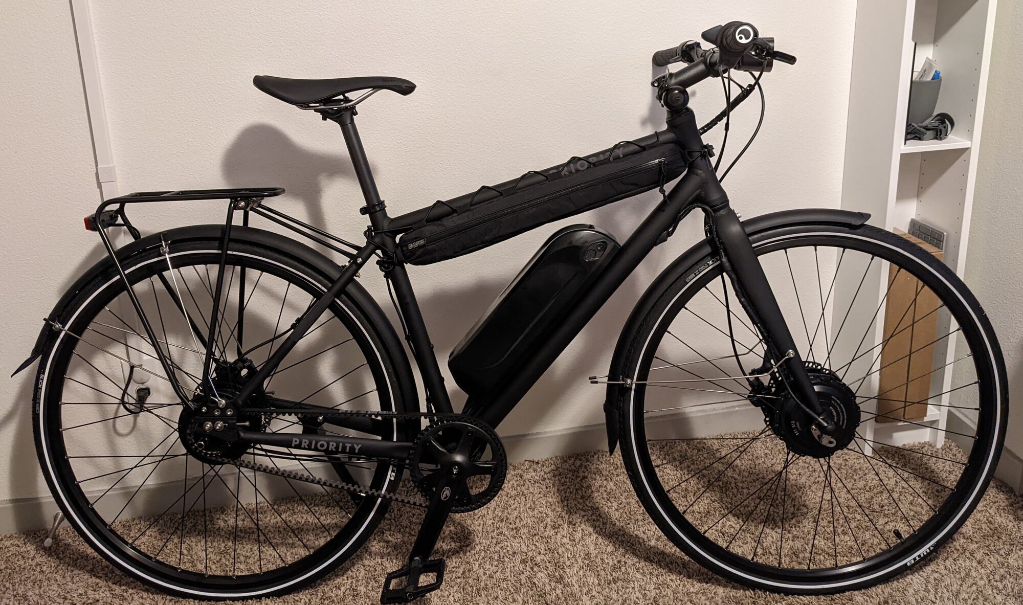

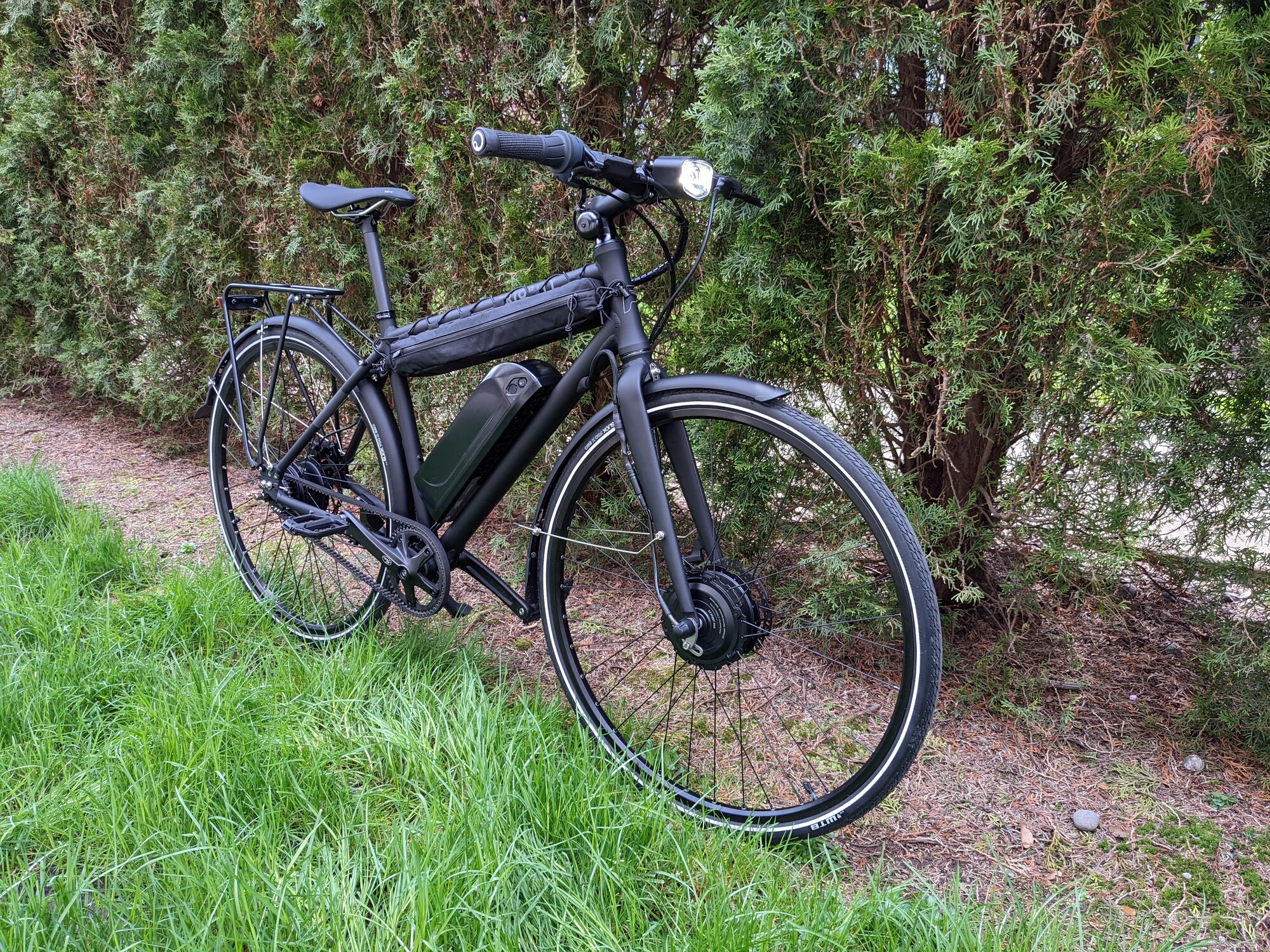

About 115 miles on the bike now and not a single issue to report. I'm genuinely impressed how well this came together and I've adapted pretty well to the throttle only approach.
Still would like to compare a PAS/torque sensor setup to this throttle one but just can't bring myself to purchase a Cycle Analyst yet. Though I have a feeling it will be a project down the road as I have plenty of space left in my frame bag to hide it. Haven't stopped to take photos yet on any of my rides since I'm commuting and in a rush to get to work or home to the family. Will try to spend more leisure time this week though.
Need to post some final specs for my bike too now that its done. Stay tuned!

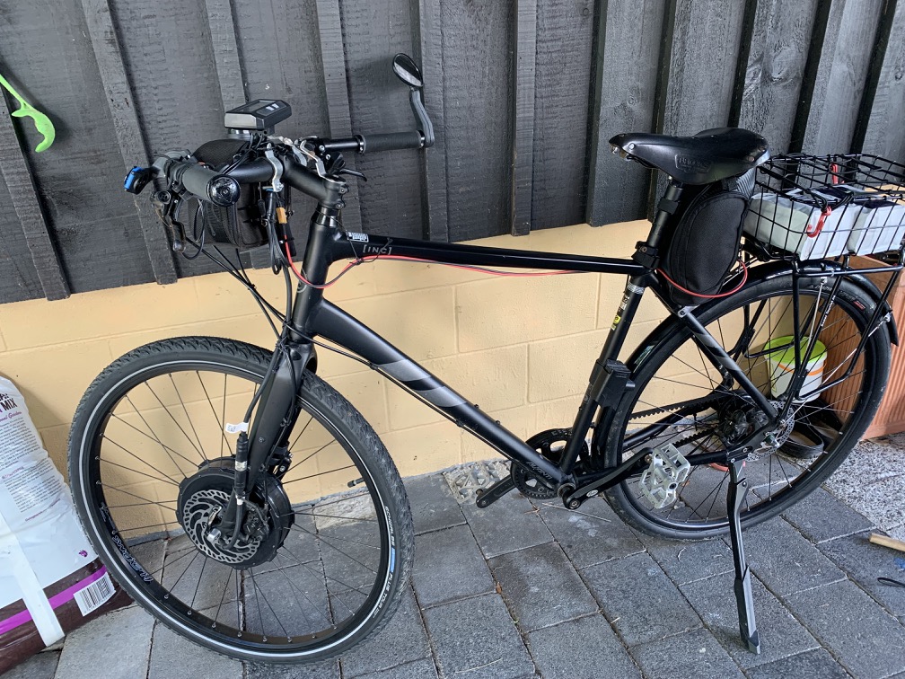

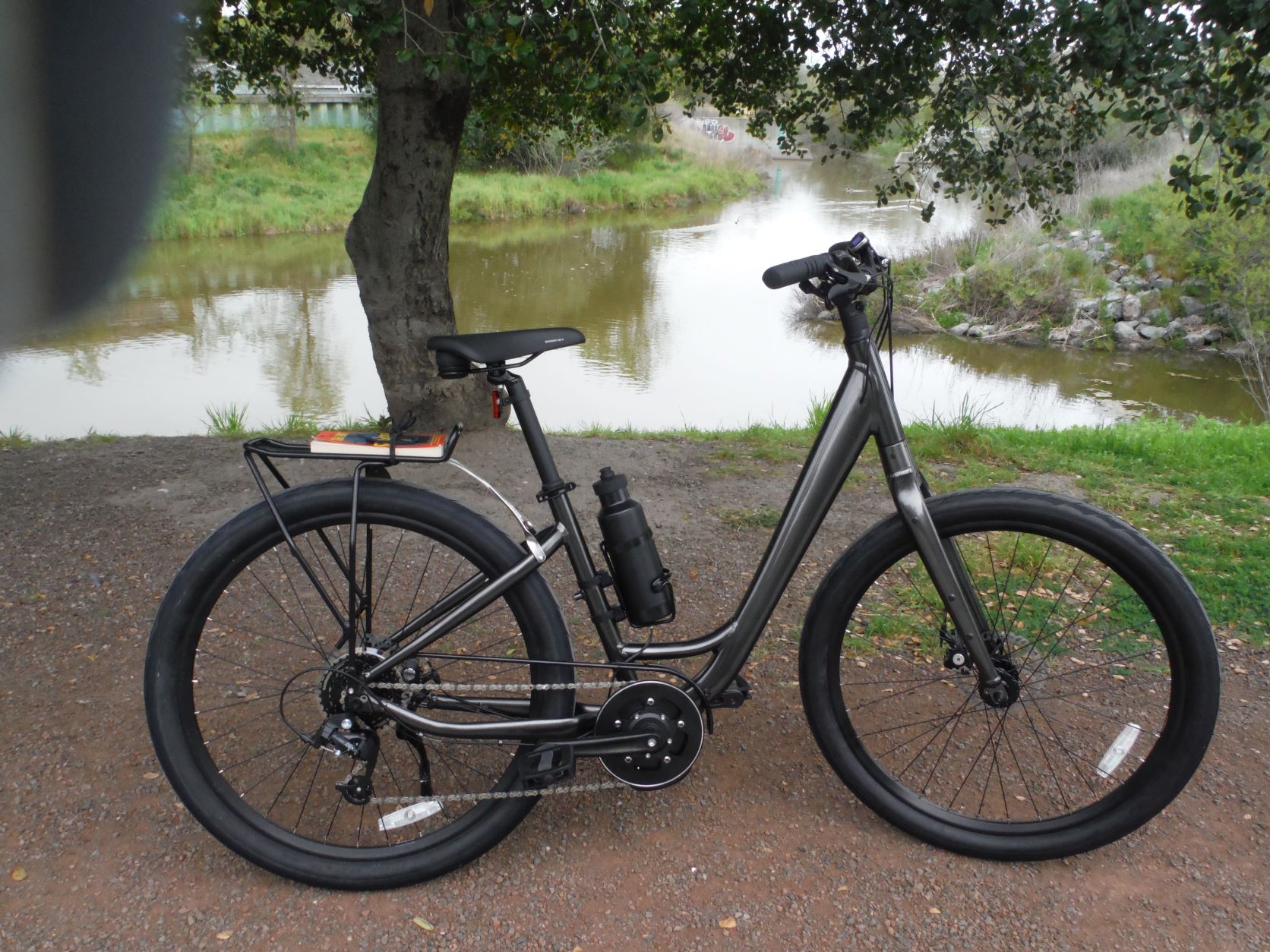

I'm so sorry I'm late to this party. But, OMG. I am thinking along very similar lines and love those Priority bikes - Do you guys know Shifter channel on YouTube? I recently converted an Avanti Inc 8 speed Alfine, Gate belt drive using front All Axle from Grin. Along with baserunner and CA. And all those wires drove me crazy too. I didn't even want to large battery fixed to my downtube, so opted for local battery x2 to fit in topeak bag under my seat. I love the idea of the LiGo batteries from Grin but didn't like the totally sealed aspect - I want to be able to replace dud cells if I need to. I initially had the baserunner fixed to Jones handle bars and CA on top with wires pushed into small bag in the Jones gap. After noticing the baserunner did not get hot from my use, even without heatsink that I forgot to order ( and Grin failed to mention), I moves the CA and baserunner into a toptube bag along with all the wires AND the battery. The batteries are 10s2p and small. If I plan a big trip, I'll put the second battery in the seat bag and simply change them over if the first goes flat. Here are the 2 setups. I'm now planning to go back to battery in seat bag and CA + Baserunner up front using a handle bar bag for the wires. I have the BB torque sensor to fit and wire in and I'm keen to set up regen braking with a brake cutoff switch to change throttle into progressive braking. The CA is necessary for all this and has been easy to access and programme via serial cable. Those are bags of coffee beans in the carrier - one of my favourite reasons to go for a ride - freshly roasted beans.

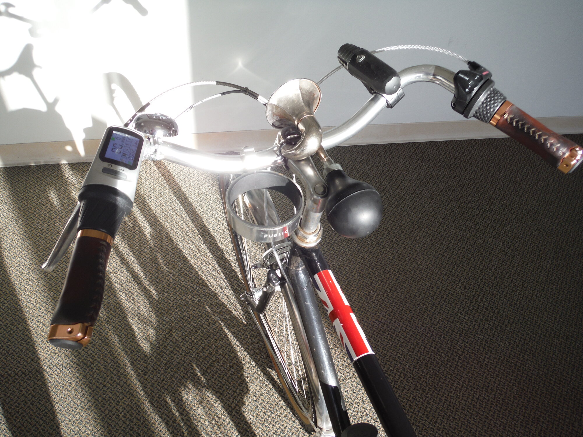

The build I am working on today will have a mini display that will show only two things, battery remaining and power level. It has three small buttons. One for on/off. One for power level up and another for power level down. That's it. Road bikes have shifters that do not display what gear you are in because real riders ride by feel, not data. A guy was posting about his Bluetooh Blues with his Specialized not syncing with his phone and mission control and not hitting wireless shifting, Strava, and Gopro! That stuff is all useless, gimmicky, gee-whiz, gizmos. It is like casino sounds. Anyone impressed by it is someone I wouldn't care to impress. And what if that makes it so your bike doesn't work?

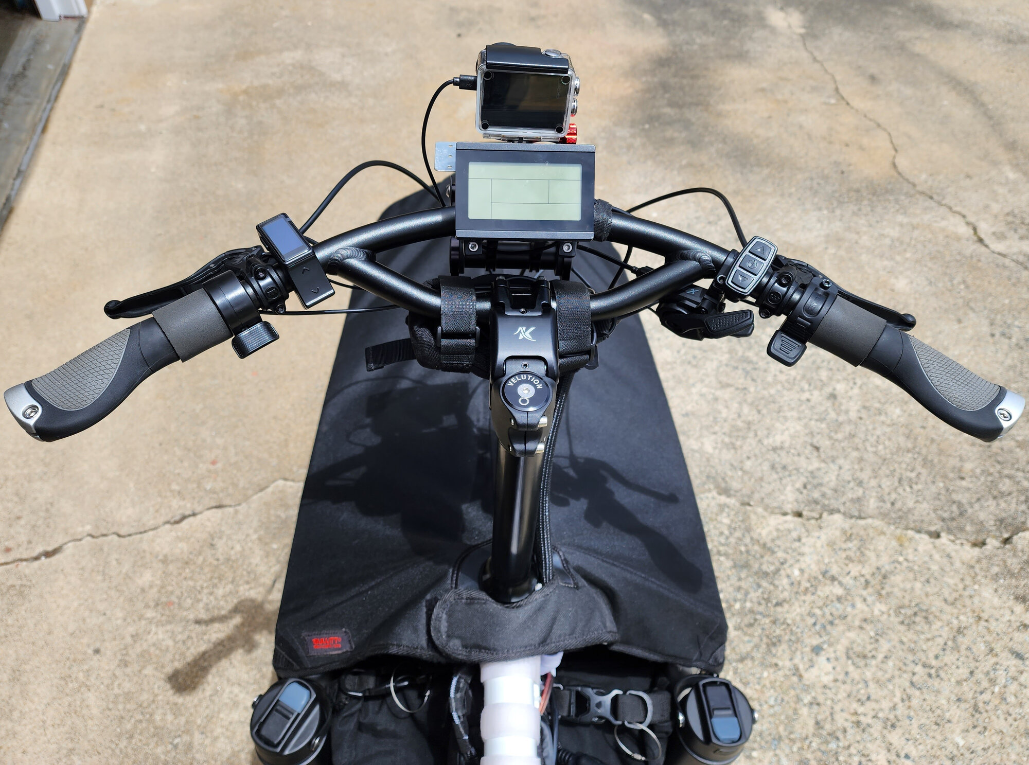

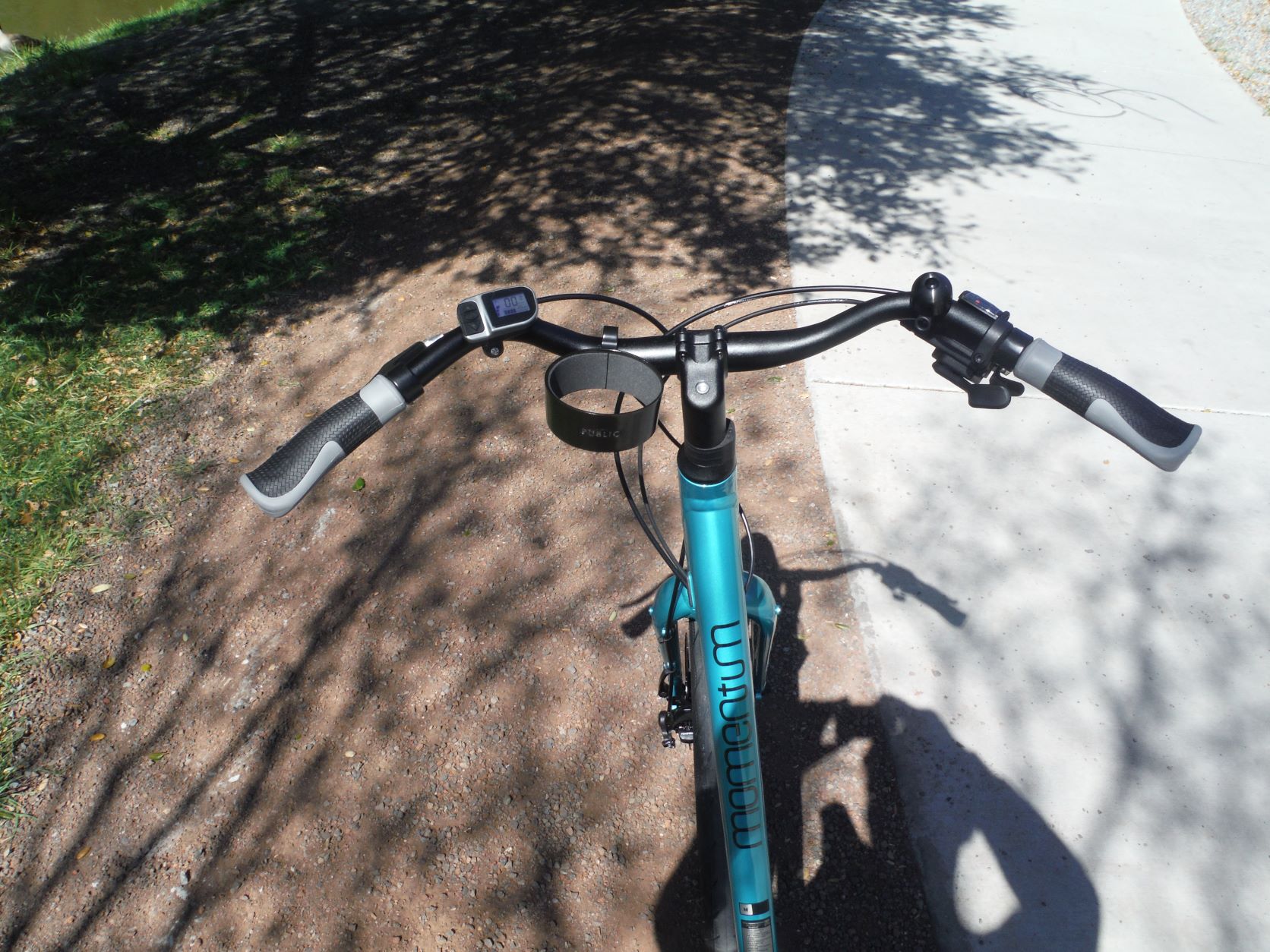

I have converted one of my Bullitts to be more or less display-free, and the second one is in progress. The display is hiding in a handlebar bag with only the PAS panel accessible and on the handlebars.
KT makes the KT-LCD4 which is a tiny thing just like an EggRider v2 but with an LCD display and a backlight, so you should actually be able to read the thing if you choose to. Thats the one that is on the way and it will replace the KT-LCD3 you see on these bars. Cost is about US$30. And for a replacement Bafang display, there is something of an improved version of the Eggrider's SW102... Its called a DM03 from VeloFox. Supports 9 levels of PAS, slightly larger buttons. Same nearly invisible OLED display. US$40 or so. It is on the left side of the handlebars on this 2wd bike below. The LCD4 will eliminate the one display left and take the place of the PAS panel on the right.
