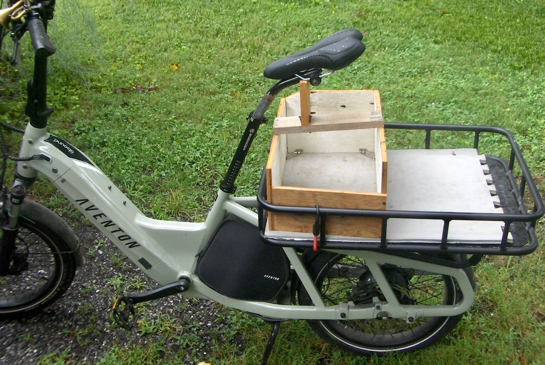

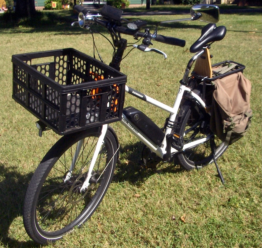

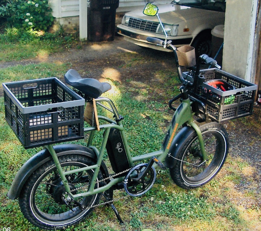

I bought a layback post, bent it to get me back farther, and supported it by putting three notches in a plywood triangle; clamping the post holds the support in place. The bike was far more controllable because I was more stable. Comfort was an unanticipated benefit. I'd moved so much weight from the saddle that if one pedal was at 6 o'clock, I could raise myself off the saddle by raising that heel relative to that toe.
Pedaling improved greatly. Before, I would have had to walk home if the motor stopped working. Now I could really pedal. I bought a Radmission and found that it, too, needed a layback. I heated it with a torch to bend it farther. I bought the abound because its seat post was farther back than most. I still needed a layback post. Like the handlebars, the seat is more to stabilize me than to bear weight. That's why a little seat is plenty comfortable. Because they're mostly stabilizers, I can tilt them forward for easy mounting and dismounting.
The photo of my legs shows that with the seat back, pedaling is like walking. When the pedal in the background gets to top dead center, the knee will be opened to 90 degrees. I can shift my weight to that leg as in walking, without tiring my leg or straining my knee. As in walking, that keeps weight off the seat. It also allows me to start applying power by kicking forward on the pedal.
In the leg photo, my arms come down steeply to the bars. It took me months to figure out what was wrong. A riser allowed me to lean forward on the bars for stability without so much leaning down. A riser made bumps much more comfortable.
The Radrunner and the Abound don't look like classic English bikes, but I've altered the seat and handlebar positions of all three to be more like English bikes and, for that matter, the 1885 Rover.
