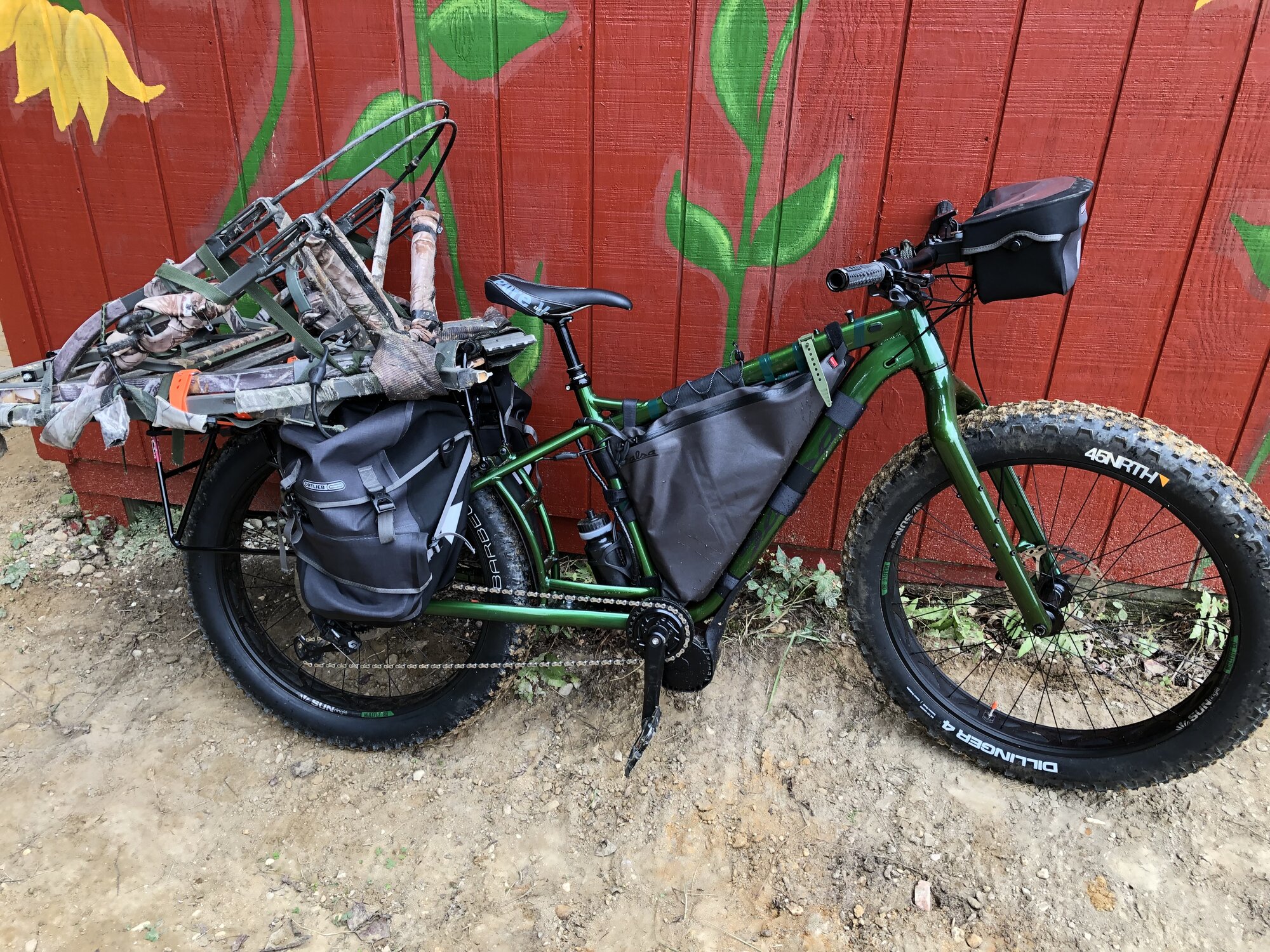

Here is what I just put together.
2021 Salsa Blackborow
100mm threaded bottom bracket.
EM3 battery and BafangBBSHD and Eggrider.
Built for trail building, maintenance, and general transport.
Not satisfied with ground clearance due to motor indexing, but no option yet with this set up.
Bike rides well, hauls the farm, and I am pleased with it.
My first post, my first ebike.
Feel free to ask questions, though I have alot to learn.

Mid drive hangs low, no doubt. I have about 8ā€ of ground clearance.
No issues on anything but logs.
Hard to pop wheelies with this extended frame length.
But that is not the intent of this build.
