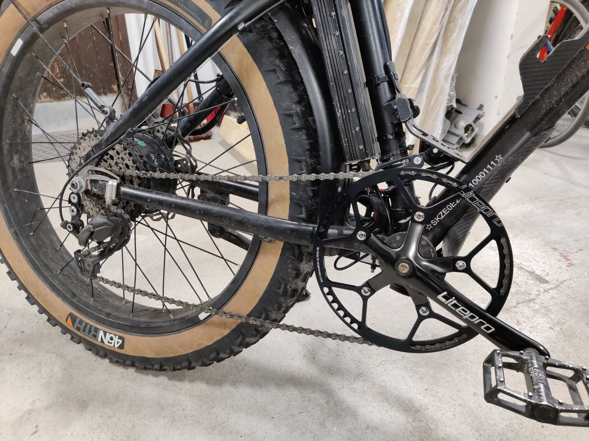

I'm using 8 speed 11-42t cassette but upgraded modified G062.1000.DC motor. Chainring is 58t.
