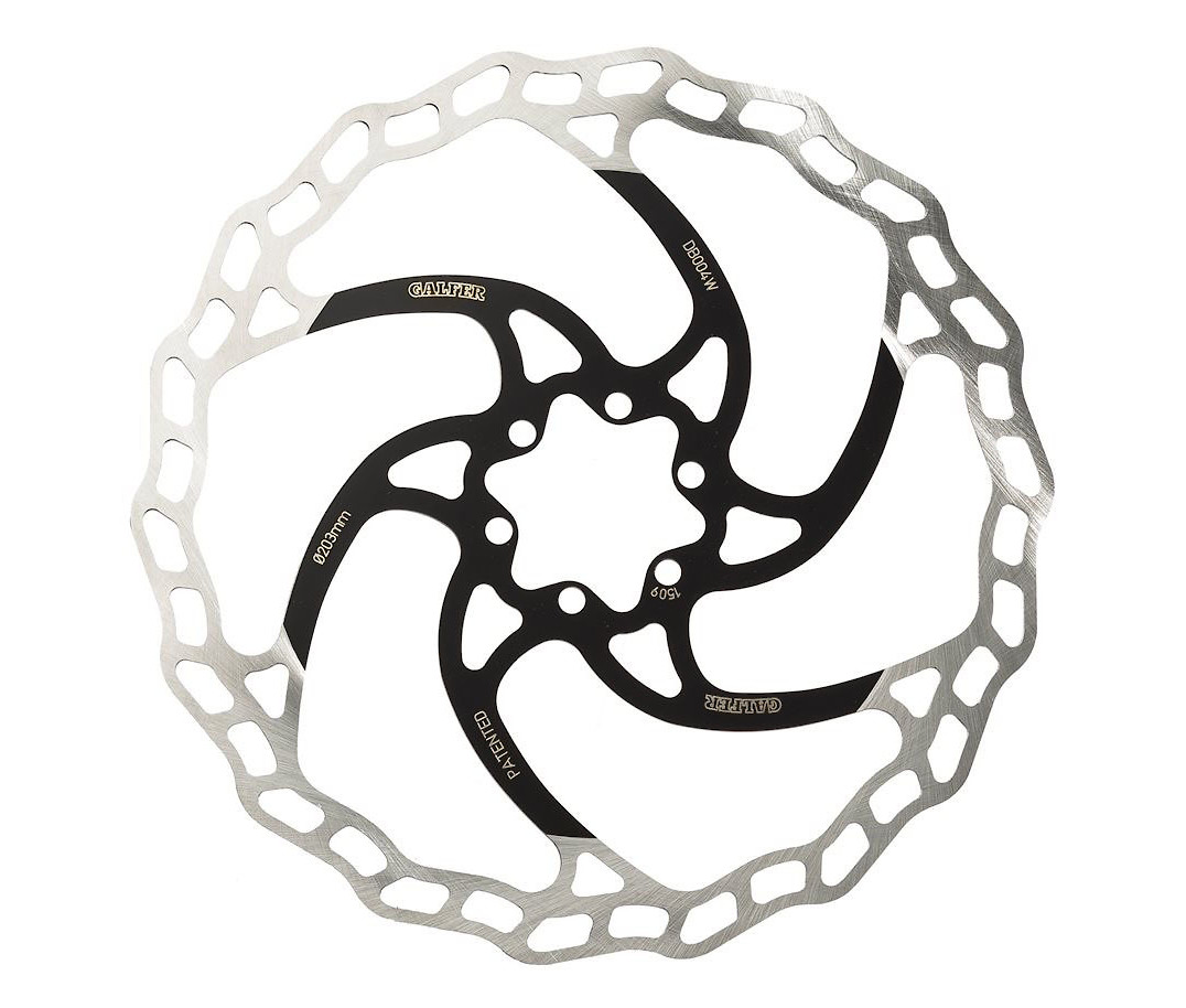

Well, thicker rotors are less likely to warp. And since a rotor is a heat sink, more material makes them more effective than less material. Thats true for how 'holey' the rotor is. I look at some rotors that are almost all air and shake my head...
'Standard' rotors are 1.8mm thick. Magura rotors are 2.1mm thick. Tektro downhill/ebike rotors are 2.3mm thick. So... you had better know if your Tektros are spec'd to use the thicker ebike rotors because using the standard 1.8mm thickness is very bad. It'll cause the pistons to overextend and boom leaky pistons.
If they are not spec'd to use these thicker rotors, trying to stuff them in will not work. I can *barely* get the 2.3's (Type 17 rotors) to fit within my Magura calipers and that is only a 0.2mm difference in thickness.
Beyond this, try and use a rotor that isn't all air holes. And if you are winging it, be prepared to have guessed wrong if they decide they want to squeal. I had a pair of Avid rotors that just would not shut up on an old set of brakes I had and I could not fix the problem until I changed the rotors. was just a bad combo and a harmonic developed I could not dial out.
well, mines are 180-24 disc rotors from tektro and with the pads. They are already touching lol
I am not sure about the thickness. But i have search that Tektro uses 2.3 thickness rotors
Edit: I just found out that my rotor that my brakes are en E350 hydraulic brakes. The disc that i have is a Tektro Polygon Disc Brake Rotor, 180mm.
Edit 2: i believe my rotors are 1.8 in thickness. i dont see anywhere where it says that they dont. If, i go and buy them, they are also saying it is 1.8-1.9 in thickness

180-24 means it is a Type 24 rotor in 180mm size. Tektro makes rotors MOSTLY in 180mm thickness, with only one or two exceptions in 2.3mm. If its a 2.3 you can be sure they'll shout it out.
It doesn't help that they don't say how wide it is, but this happens to be about my favorite oem rotor that I have pulled off but re-used on another bike I liked them so much. I am going to guess 1.9mm as they fit generic calipers, but the feel is a little more substantial (thats probably unscientific BS and they are 1.8). They also don't seem to make any unwanted noise. They outlived the bike I had them on.
To find rotors on their web site they are kind of hidden. Drop down the 'Accessories' section of the search bar to select rotors. Then they come up. I poked around and the new Type 45 is 2.3mm - Looks like Tektro is making a fancy/pretty one to rake in some extra bucks from the suckers. I like the nice, inexpensive Type 17 for my 2.3's. Note the type 16 looks almost identical and is 1.8mm so beware if you are ever shopping for the thick ones as these are usually what a seller really has if all they say is "wavy rotor".
