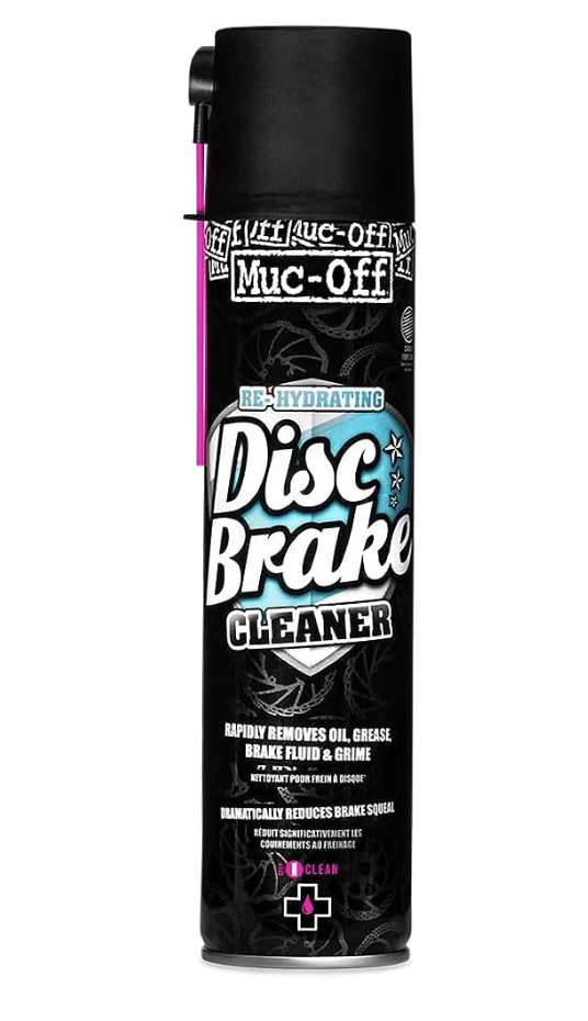

We either use Acetone as recommended by the LBS, or a bike disc brakes cleaner, like this.
