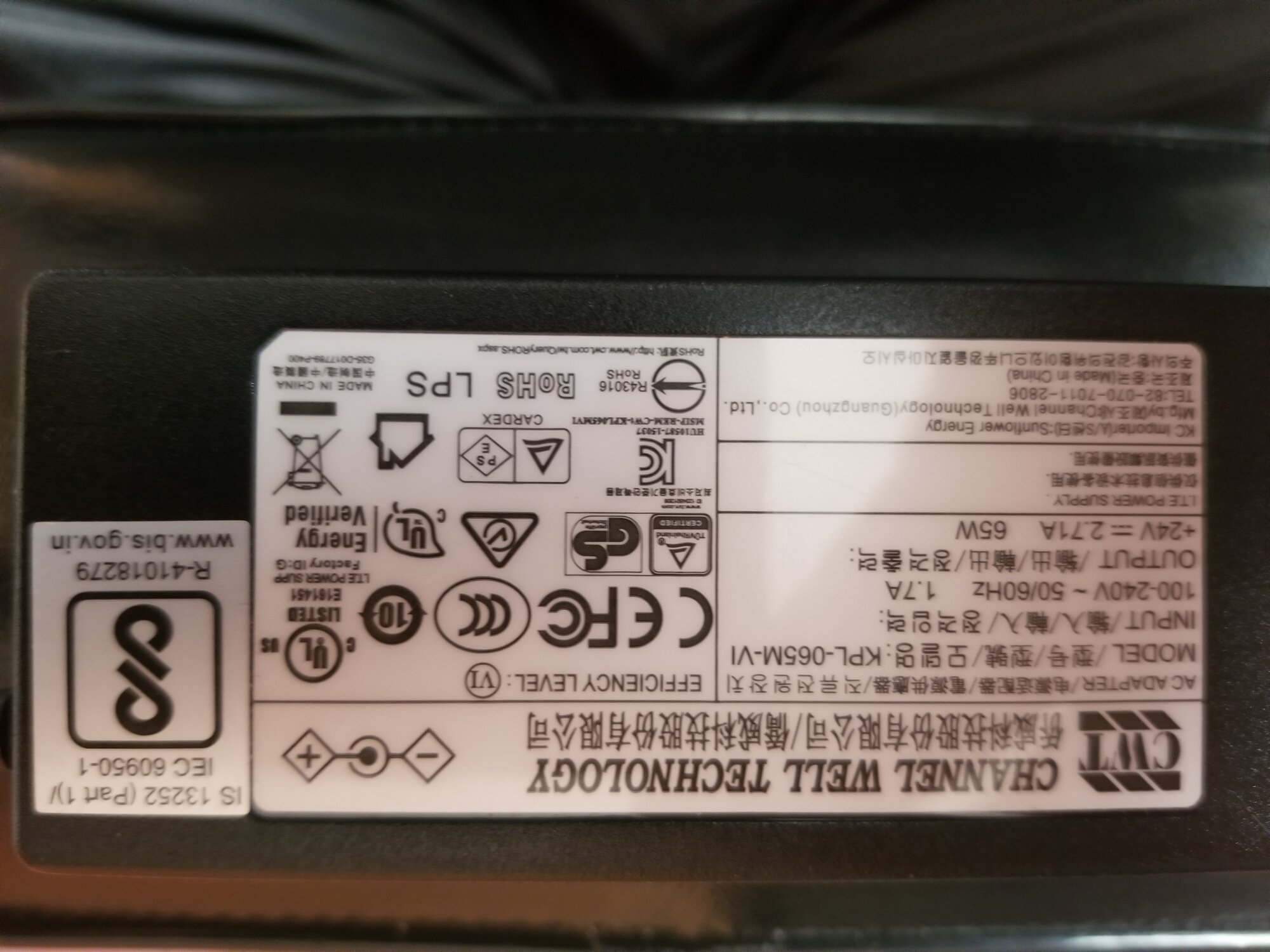

i checked voltage from charger and it is putting out 24 volts as stated on the back of charger.

The charger must deliver 54.6v to charge your 48v battery, at 24v the battery monitoring system of your bike doesn't recognize the charger.
i didnt see that it was a 48v battery.
thanks for pointing that out. great now to find a good charger.

Charger I was given..
