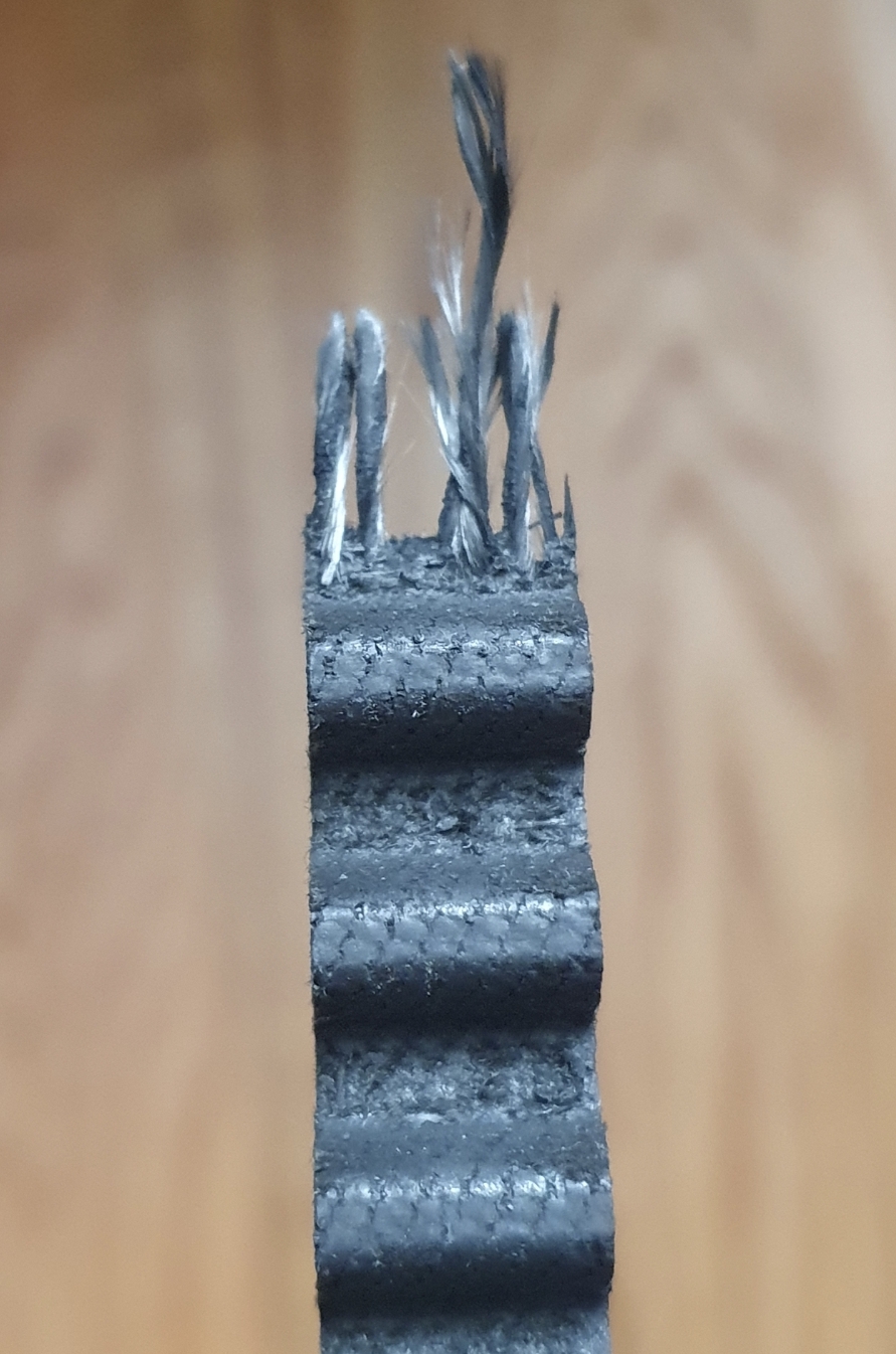

FYI, just had my first belt break at almost 5000 miles and 1+ year on my Roadster v2. Not from wear really, but from me overusing and overloading it I think. No fault of theirs. I had started to hear some noises and creakiness, but I ignored it.
I've been doing a lot of motor off riding, and specifically climbing major hills with the motor off (using arm and leg strength), in my quest for building strength. So my fault for using it in a non-typical way. Also doing 7500+ ft elevation gain rides, and 60-100 mile rides.
Got a replacement from Ride1UP for $50 + shipping/tax, and all is good now with the best bike ever 😀
Why not a gates carbon belt over the stock?
There is a slight difference apparently, in sizing, between the Gates and Top Trans belt. So there might need to be some others mods required to do that. Reality is that the Top Trans belt is fine. If I didn't overstress the belt (by riding a fully loaded 42+ lb bike, up 10% inclines, with motor off ... and many other rides with lowest assist level, up 10+% grades), I'm guessing the belt would easily last 10000 miles for more normal use.
