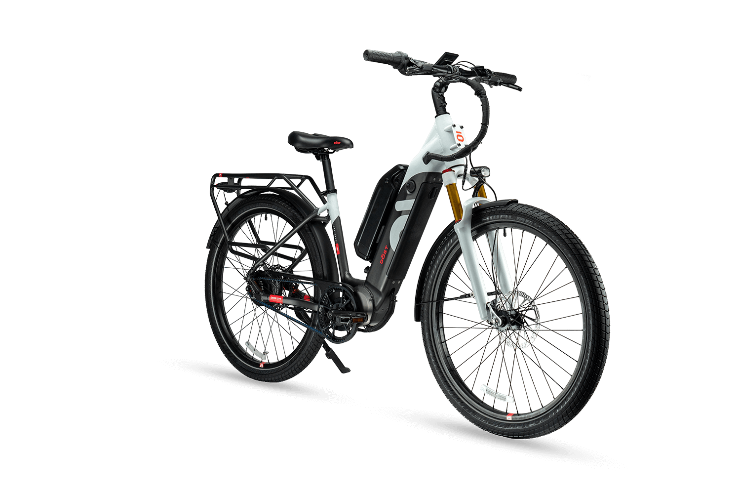

RIZE - CITY MD E-BIKE ARE THEY ANY OWNERS WITH PROS and CONS REVIEW FOR ME BEFORE I BUY 2 OF THESE E-BIKES
W8N4U
Hello everyone, that are E-Bike Riders and Lovers,
we are looking at the RIZE - CITY MD e-bikes and I wonder how many of you own this bike?
your input on the Pros and Cons would be so grateful as we wish to purchase x 2 e-bikes.
I am 5'9" 240 lbs and my wife is 5'5" tall no weight is required lol as I need to survive a marriage.
Seriously I hope many of you have purchased this beautiful e-bike, the "City MD Electric Mid-Drive Bike"
How many bought the TEAL Color bike please let us know.
we like that colour.
Let me know what colour you took as well 🙂
Thanks in advance

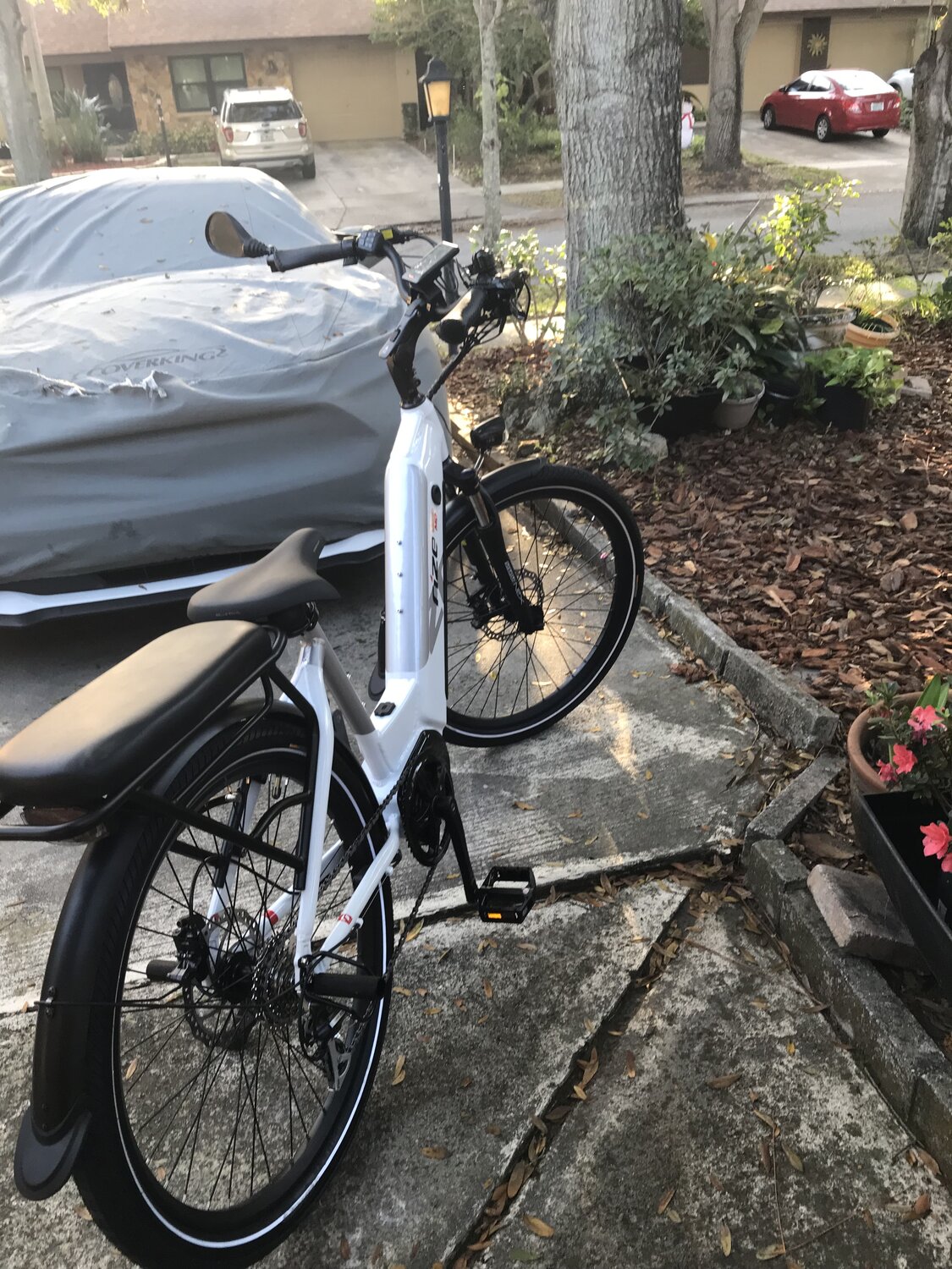

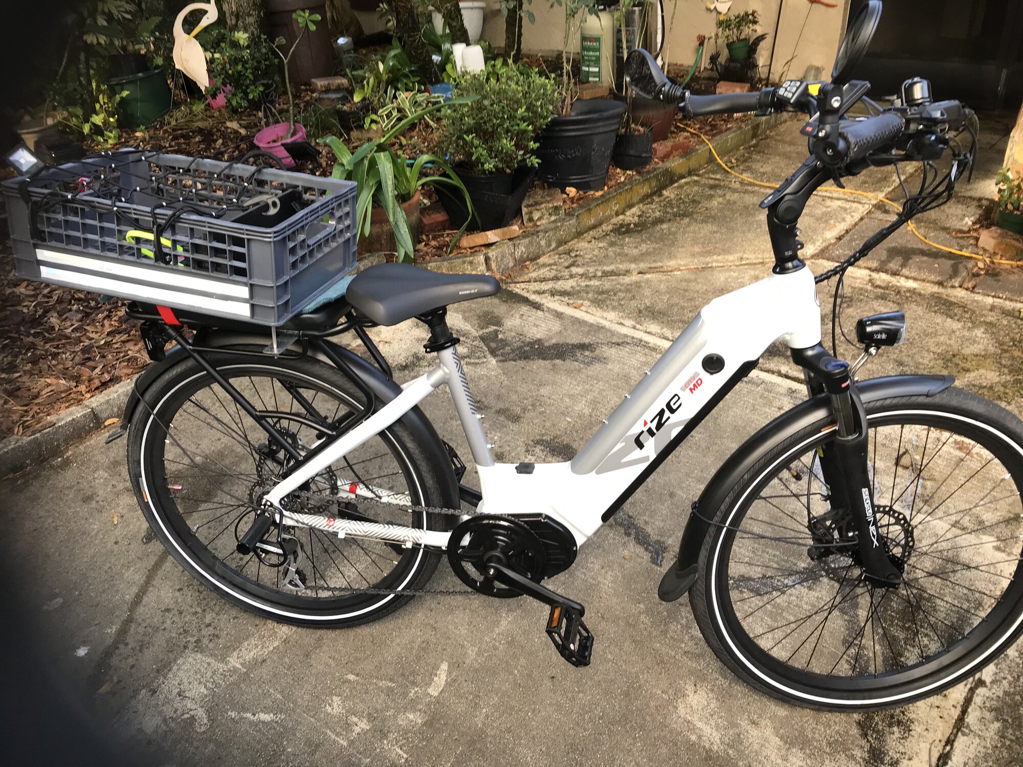

I own the 2022 Rize City MD with the secondary battery. My drivetrain clunks if I press too quickly for power or if I shift to lower gears coming into a stop. I am new to Ebikes, but have lots of road and MTB experience. I have used the brake application to cutout the motor when doing large gear changes. I assumed that this bike doesn’t have a torque sensor as causing the shifting issue. But again I am new to this Ebike. Does anyone have info on how to use the secondary battery correctly? The owners manual has nothing. And nothing came with the battery. Does the BMS decide on which battery to draw from? A web search provides nothing. Do you turn the secondary battery on when the primary is expended? The only thing the company provides is how to install it on the bike. Otherwise I have very few Cons on the bike. Initially I had the rear brake rotor rubbing the kickstand fittings. Rize was quick to provide parts and directions to fix. Again I like the bike. I have modified it to ride double or use it as a light cargo hauler.

Rob, I can't help with how the aux battery is used, but wanted to say that bike should shift like any other you've ridden. Or at least it should once you get the timing down right? Do you feel the motor is still powering the bike when you get this clunk, even though you've stopped pedaling?

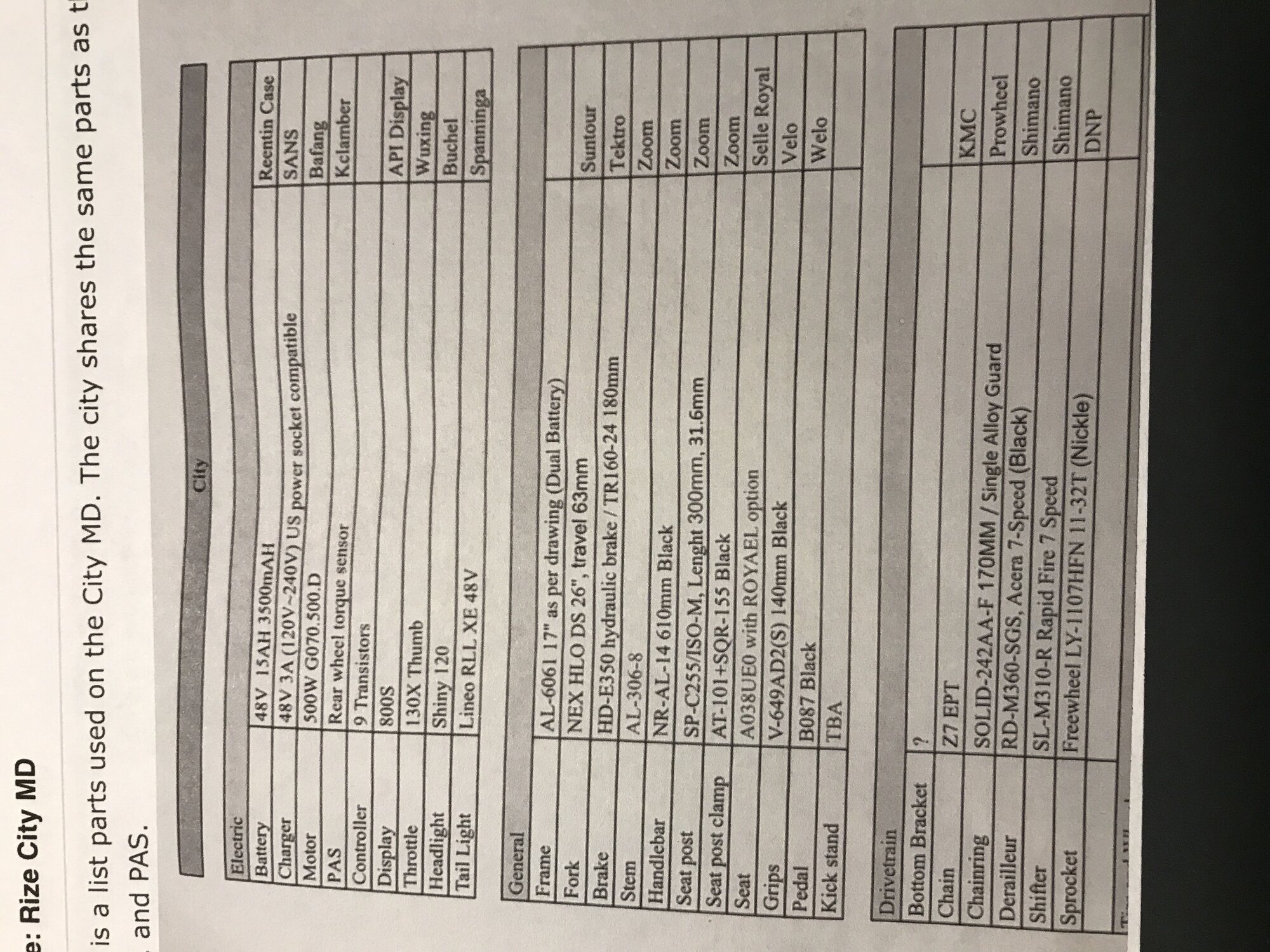

Hello AHicks,
My motor according to the specs sent by Rize is a 500W G070 500D. The connector to the display is round.

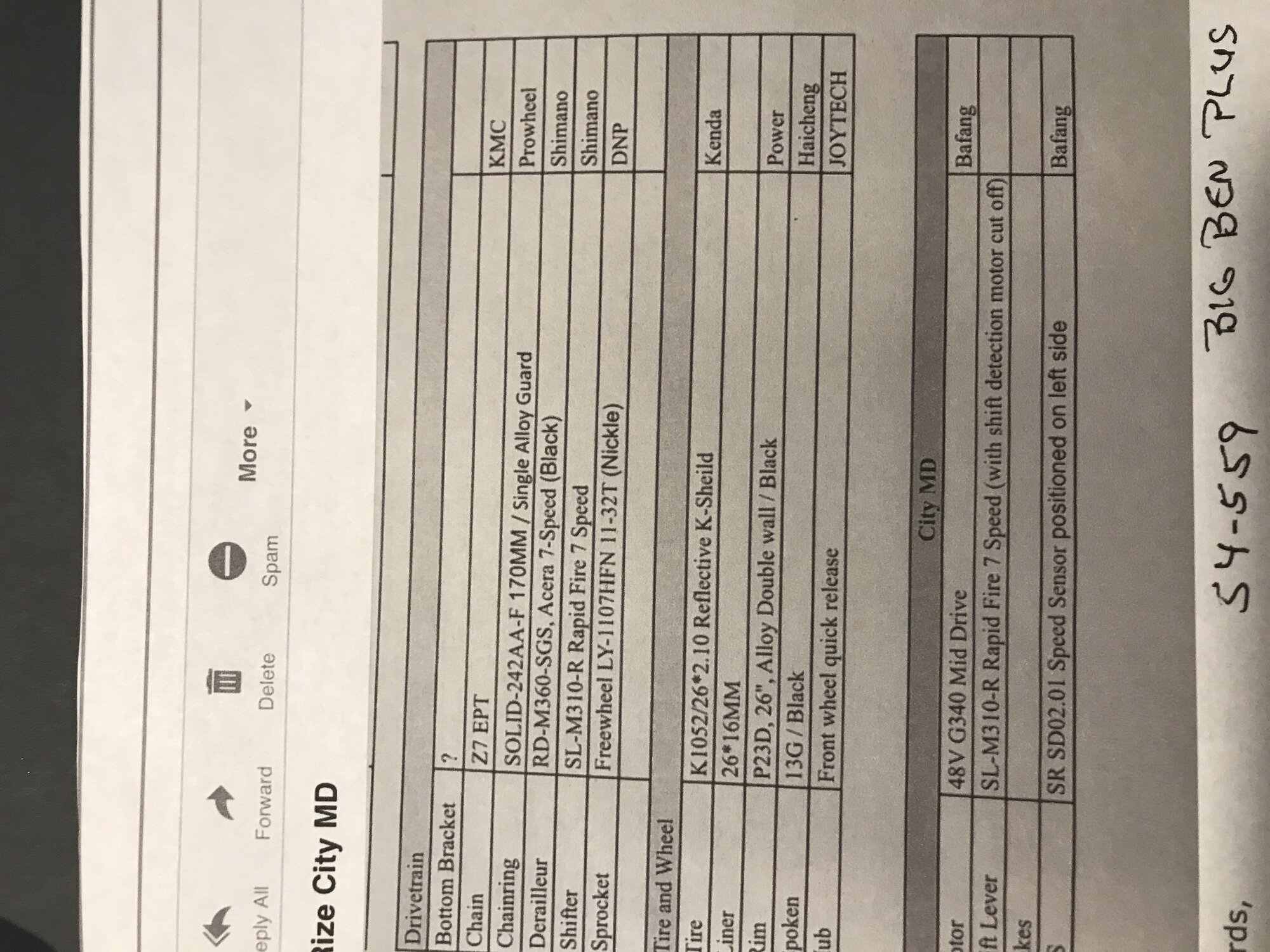

OK, I'm confused for sure. The bike in you picture is a mid drive, the model number in your note is for a hub drive. I think the bike is available either way, leaving me at a loss for which one we're talking about? It makes a difference as the mid drive is adjustable for how long the motor keeps running after you stop pedaling. The hub drive is not.
No mine is a mid drive. I asked Rize for a printout of all the specs of my model. Stuff that is not in the normal owners manual. So maybe with the supply issue this is not accurate. Question: If I come to a stop while downshifting and not peddling when does the derailer function? During the slowdown or when peddling commences? I am obviously getting the chunking noise when the motor kicks in. And old habits as above I would peddle without thinking on a road bike to get the right gear selected next. Here is the data sheets they sent me.
OK, that helps. They sent you the sheets for both the hub drive and the mid drive. Your mid drive motor spec is listed on the second sheet (48v G340, more commonly known as a BBS02b). The shift delay switch they install shuts the motor down (much like the brake switch would) when the shift cable moves. It's just for a second or less though! This switch should let you shift like you always have, but there is a timing issue you have to get used to. The derailleur moves like you are used to, which just starts the actual shift. The actual shift is not lightning fast. It occurs during what, maybe half of a crank revolution? So in practice, you initiate the shift, the switch does it's thing (that you may or may not notice), while you continue to turn the crank with no pressure. You'll "feel" when the shift is completed, and at that point you can start applying pressure on the pedals again.
