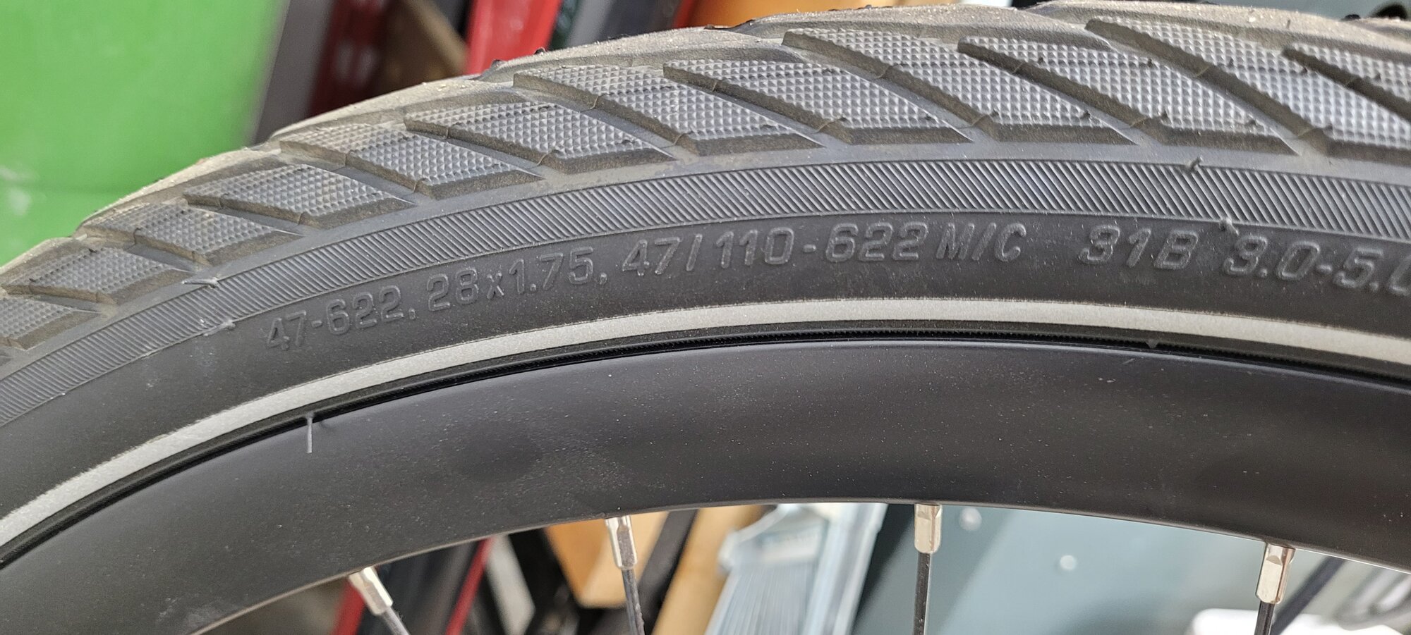

I ride an Ultimate C380 with 28 x 1.75 tires. I am 210 lbs and keep my tire pressure between 55 and 60 psi. I think 70 psi would be too firm. According to the table posted above it seems I am at the recommended pressure for my tire size and weight. The side wall of my tire specs 45 to 70 psi.

Pic of existing tire. I think(cannot remember if I read or was told) Gazelle has introduced a wider tire in the 2023 line up.

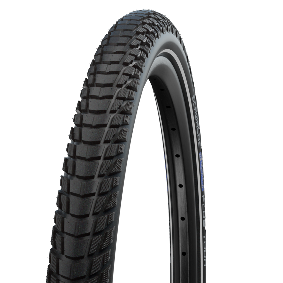

If it were me, I'd do a Marathon Plus Tour in 28x2.00. Its flatless, has a 128kg weight limit and can be inflated down to 35 psi, although for a 225 lb rider thats not going to be such a great idea.
No matter what I would go a bigger tire. I know a 1.75 can be made to work, but I would prefer to spend a few bucks to have something working well under its limits rather than up close to them. Plus, the MP Tour is known as a lasts-forever tire. I've seen claims of 10,000 miles. I have two cargo bikes using them as a back tire, one approaching two years with minimal wear, although its the older tread pattern and not the new/improved one. I had the same decision to make on my first Bullitt as the frame specs say 1.75" tires, but I could fit 2.0" without rubbing, and have never regretted the change.
