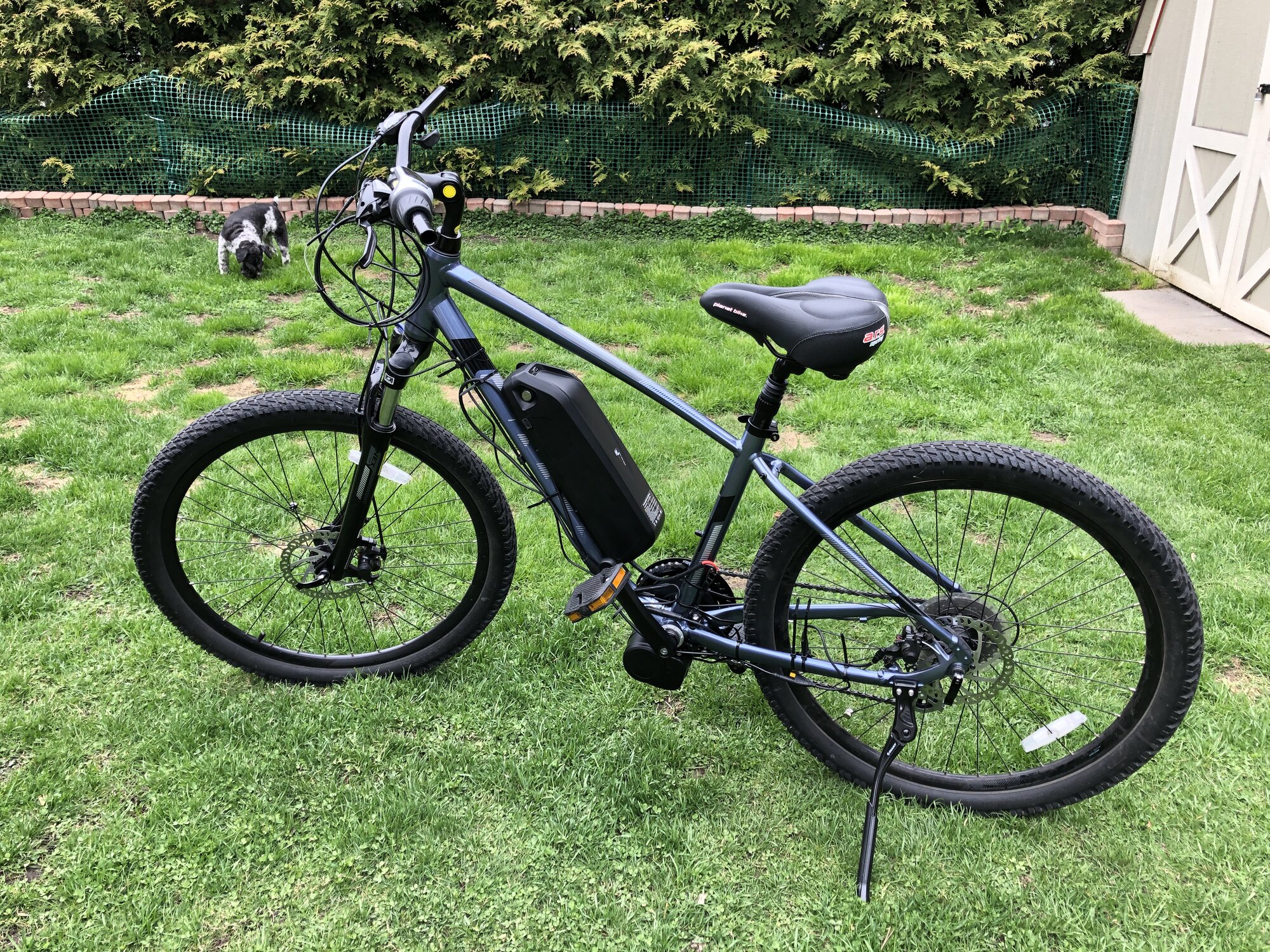

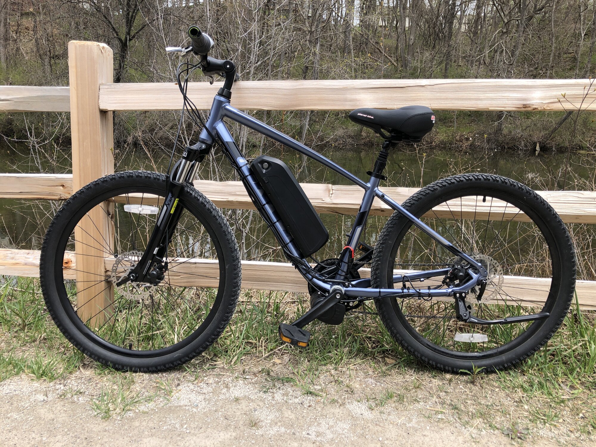

Retrofit of my (now) bluish, purplish bike!

Not a lot of excitment here. I can only change the voltage and amperage. The amperage was set to 00, which is the default, whatever that may be. I set it to 15 amps. I'll test that. Maybe later I'll try 17.
But to get into the really fun stuff, I need to get an 860C display so I can look at the open source version. :rolleyes:

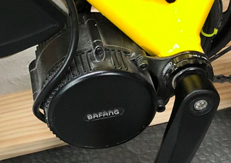

That didn't help. After the initial boost, the power dwindles down until it's completely gone. Then I have to shut down and restart the bike... and the cycle repeats.
So I got frustrated... (no I didn't throw the bike in the lake!) Ha!

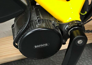

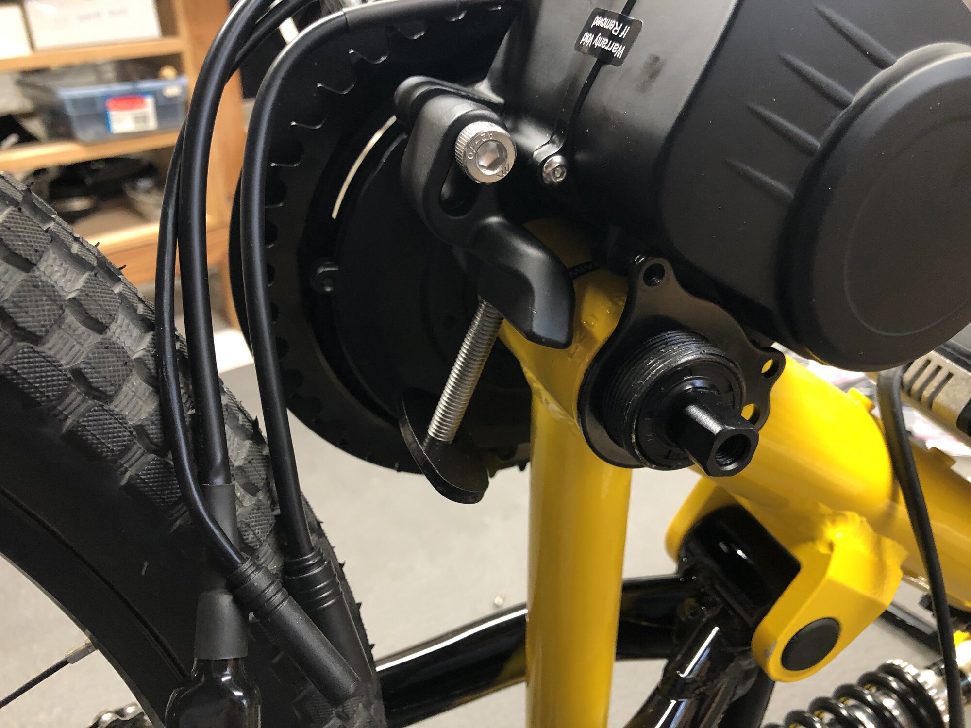

I did pull the TSDZ2 motor, and popped the Bafang in. I still need to clean up the wiring, but on my test ride, I've got lots of get up and go again!

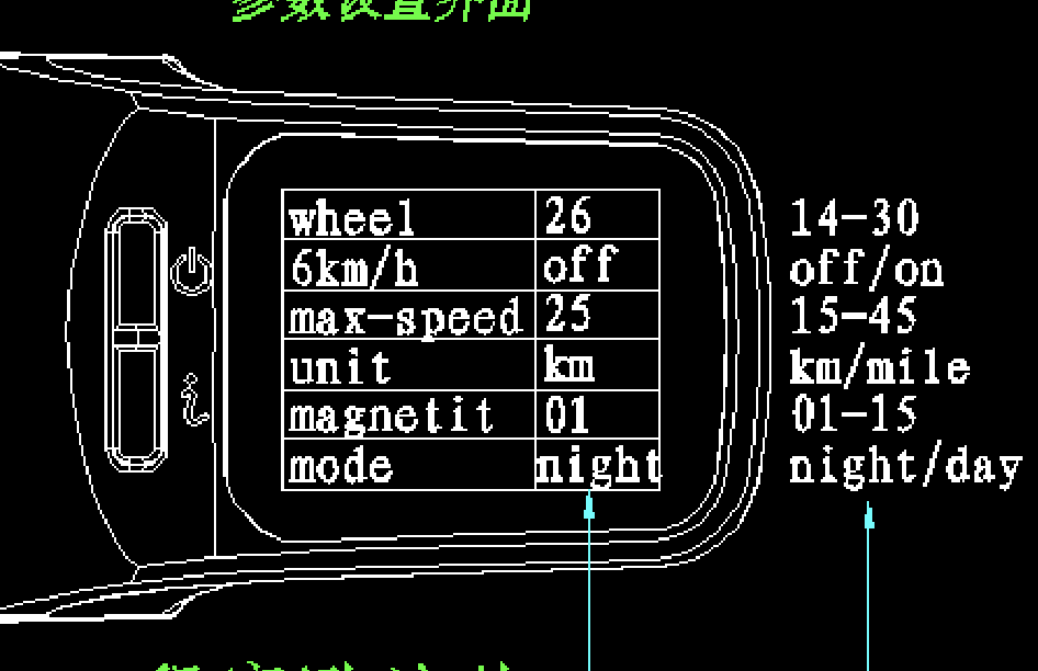

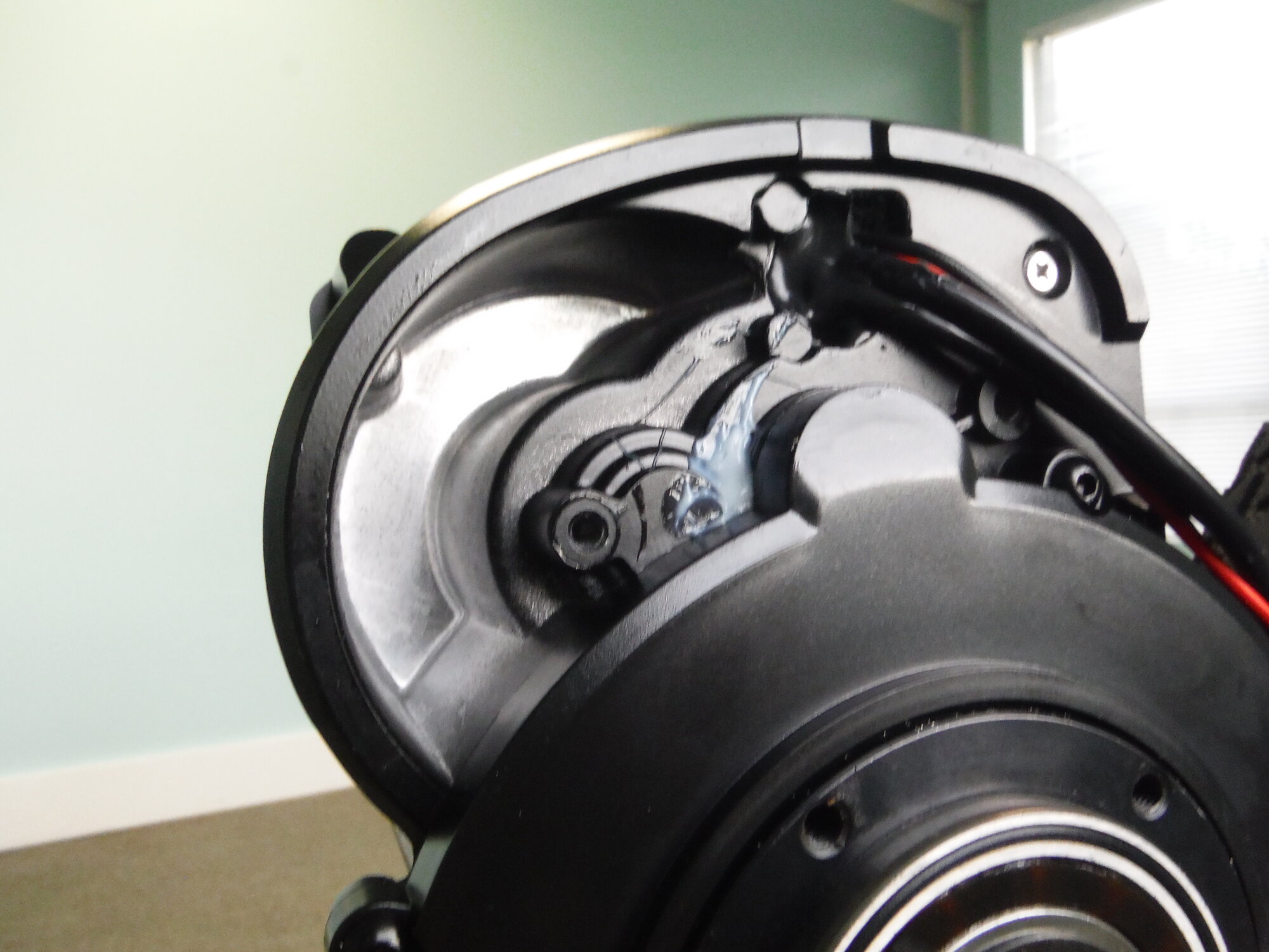

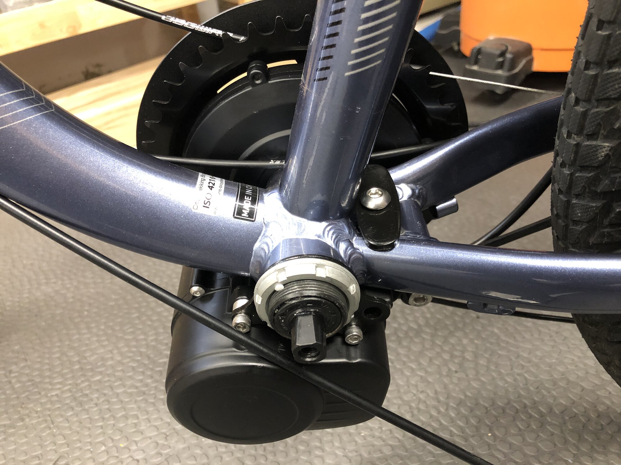

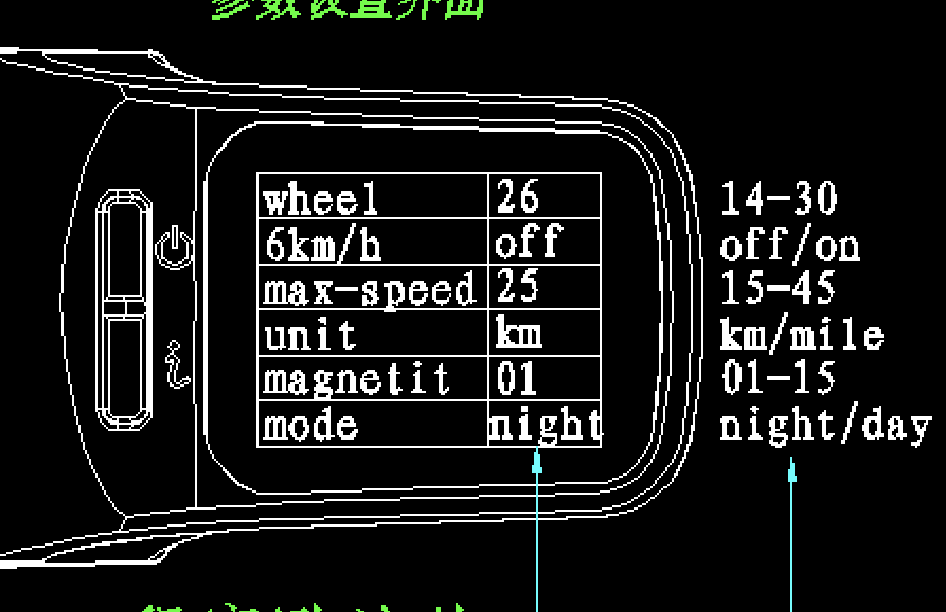

Hey everyone, I'm just jumping in here. On a TSDZ2 there is a secret (don't tell anyone) compartment for hiding extra wires. It is behind the chainring. On that display you can tell it that it has up to 15 wheel magnets. You can tell it that it has 5, but only install 3. I don't install any. And I chop off the speed sensor. Than seal the wound and stuff the nub in the hidden compartment. This makes it fly. Otherwise it is kind of a dud. On this display you can also tell a 29er that it has 10 inch wheels, so it better keep up. The front of the secret compartment housing can be easily drilled and a wire can come out there, giving a cleaner look. Here is what the HB looks like on a recent build a couple of days ago. And then one I made yesterday. See how the battery wire goes forward?

I have other bikes that I can install the TSDZ2 on... just have to think this through... Nice trick with the hidden compartment!

Sorry to post twice in a row. This is the Top Secret Compartment for hiding wires. In the second photo it took an hour to properly position the the hole. How long does it take to dill a hole? That all depends on if you want it in the right place!
