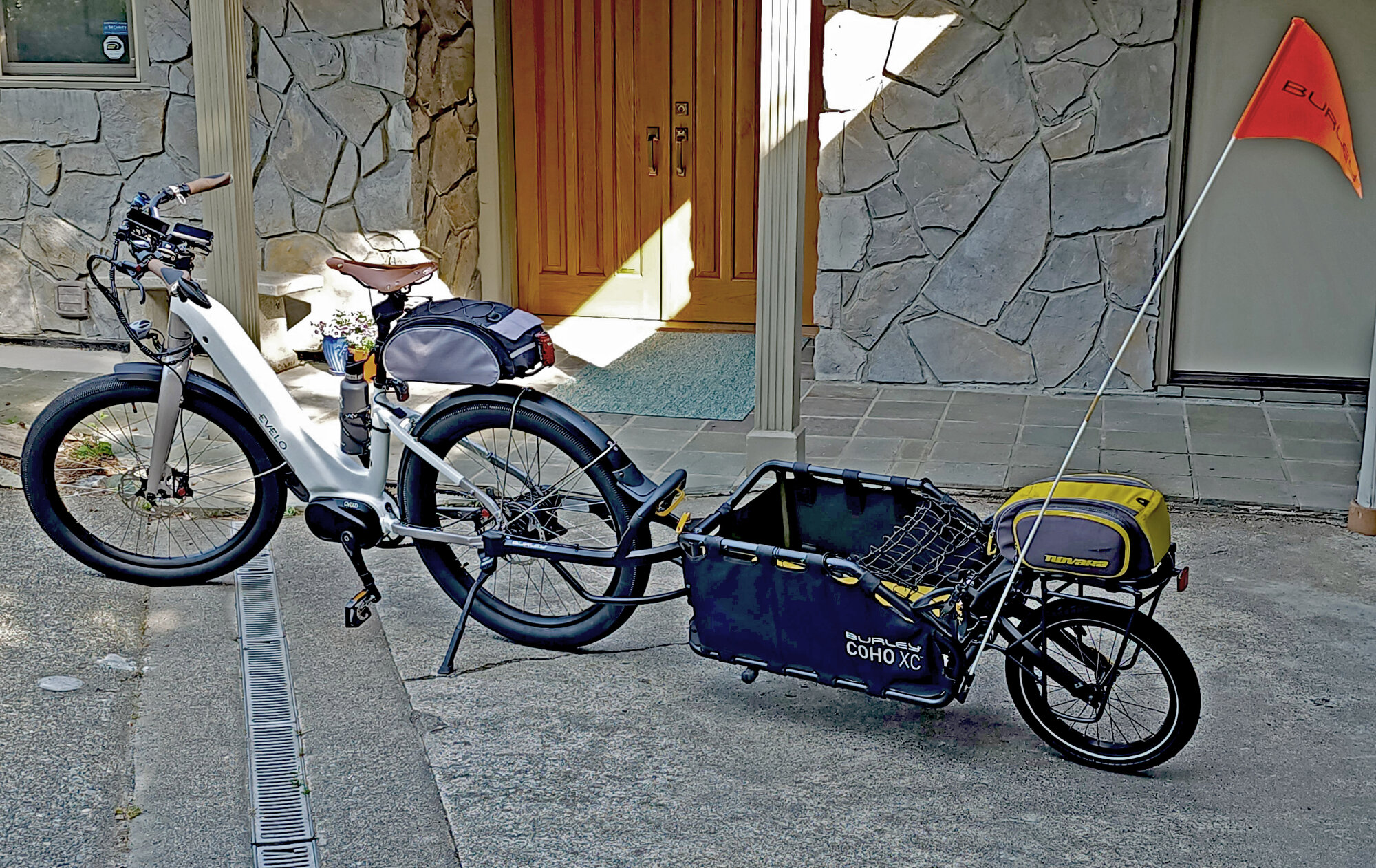

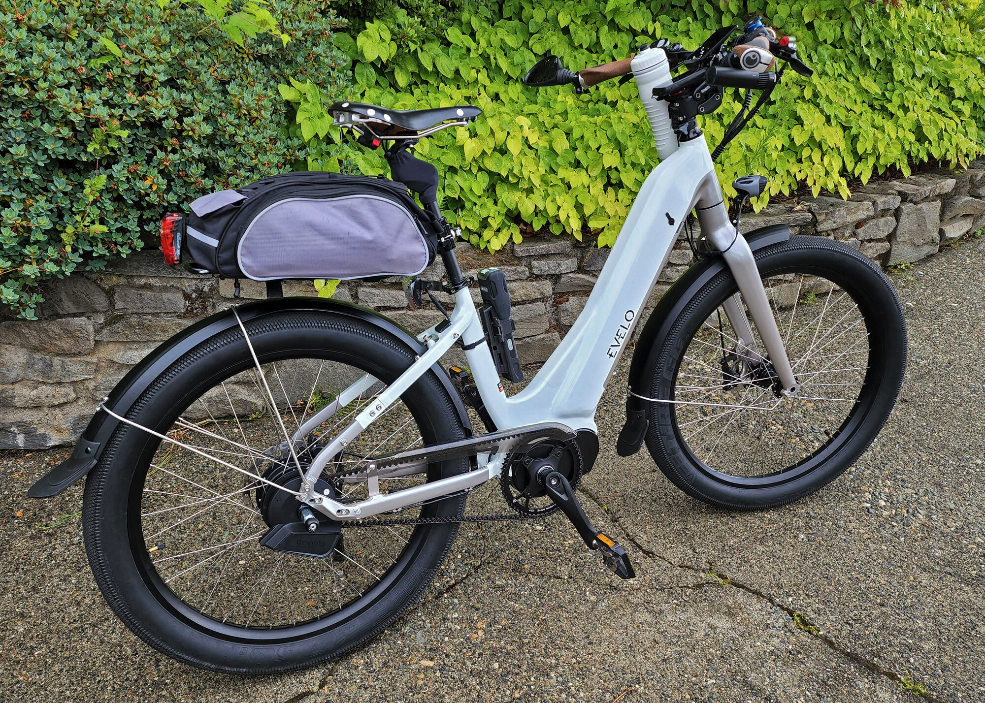

I recently purchased an Evelo Omega, a comfortable step through with a strong mid drive Dapu motor from Japan. It is a 750 watt motor produces 115 Newton meters of torque connected by a low maintenance, durable Gates carbon fiber belt to an Enviolo Automatic CVT. It does have a thumb throttle. It comes with 26 x 2.8 plus sized tires, not quite fat tires but close. It is very well made bike, built in Taiwan, not China. Excellent finish and a real pleasure to ride. I added both the Kinekt body float suspension seat post as well as the Kinket suspension stem. It has a 720 watt hour battery with the option of adding a rear rack mounted second 680 watt hour battery for extra range. The bike is rated for riders up to 350 lbs.
Evelo has been designing and making its own ebikes for 10 year and offers an excellent warranty, with outstanding tech support and warranty service.
It is a bit over your price range but with the warranty and build quality, well worth it IMO. They currently have a July 4 sale going on and the bikes are actually in stock and ready to ship.
My other bikes are Bosch powered and I love them. This bike was purchased to help me rebuild after a health challenge and has really delivered for me. While I again ride my Bosch bikes, they are used more for exercise and recreation, while the Evelo has become more a vehicle replacement for running errands, getting groceries, going to appointments and generally doing my around town rides. We live near the top of a 500 foot hill so every ride ends in a hard climb. The Evelo is up to the challenge, getting me up to the house without strain, even loaded with groceries or towing a cart.
Given your specs, this bike is well worth a good look.
