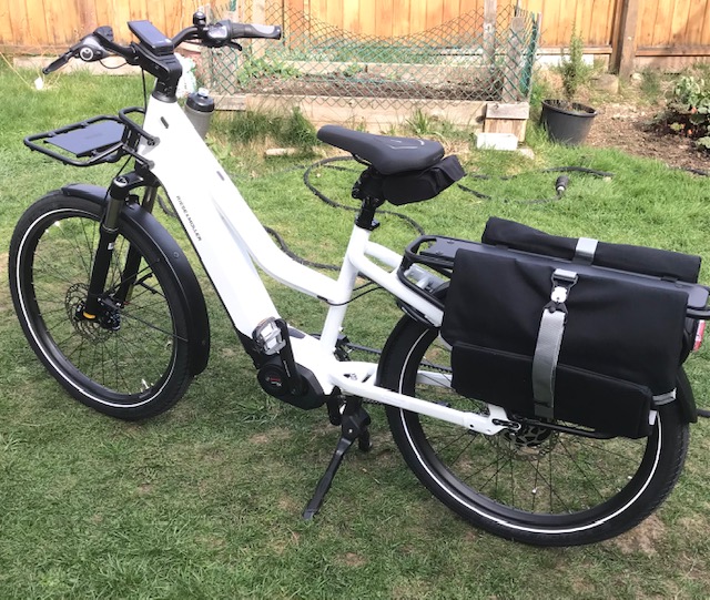

OK I put an Tern GSD double kickstand on my 2020 Mulitcharger Mixte. The dealer had some of these kicking around because the stock Tern item was replaced by a heavier duty one offered by Tern to these models. This was a great addition to my Mulitcharger. The dilemma I had was in order to get the centre stand from R&M I had to have ordered the passenger kit which I didn't want (expensive). So if your dealer sells Tern as well, check with them.
Less help to you having already found a solution, but for anyone else wondering, the Multicharger centerstand can be ordered by itself aftermarket. The one for Touring models is #VBK0363 and Vario/Rohloff is #VBK0364
