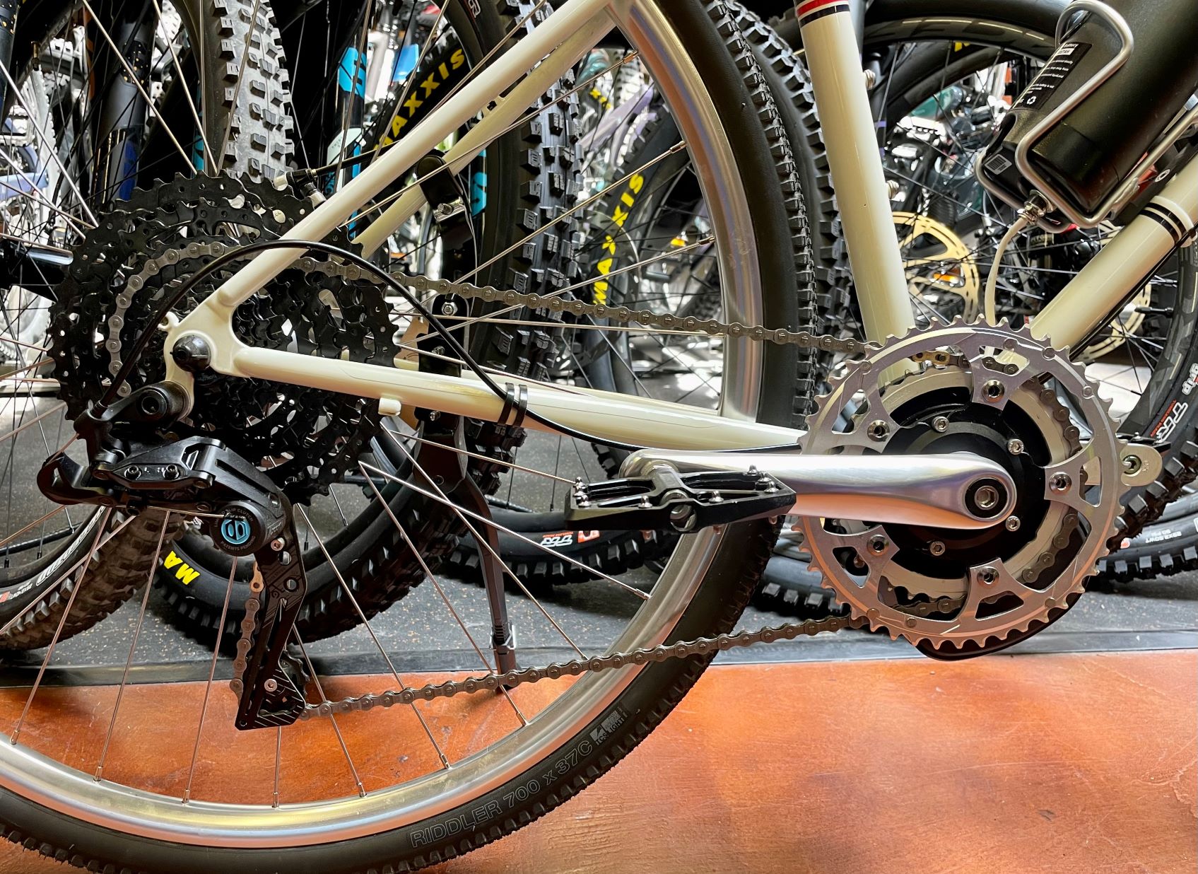

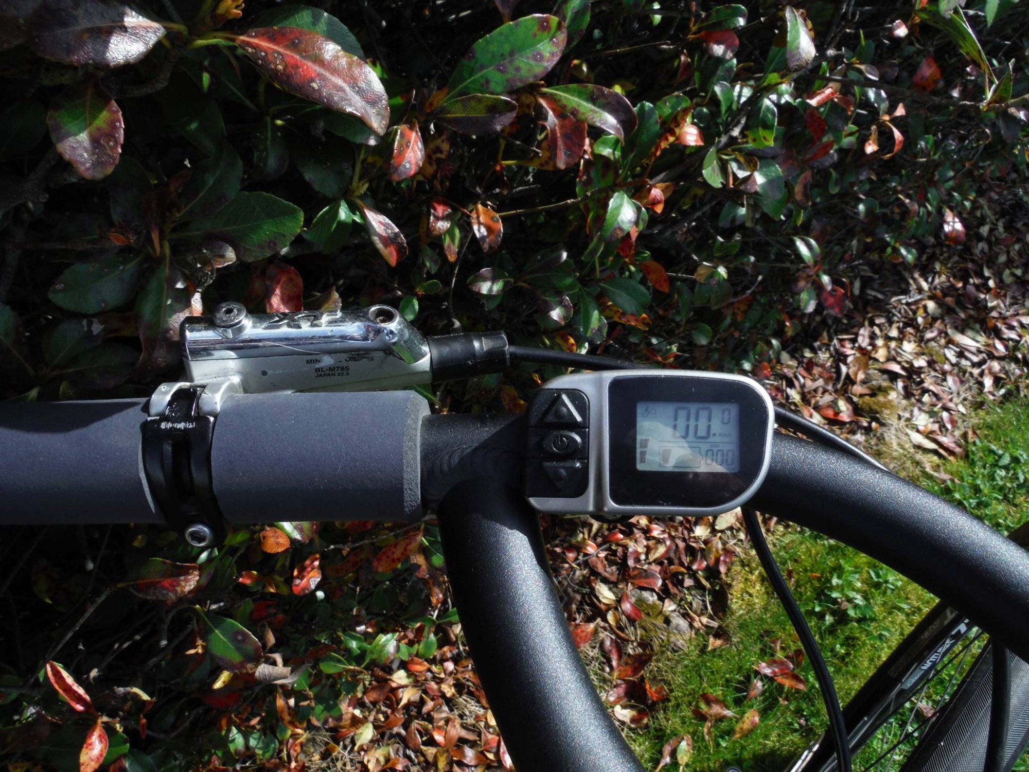

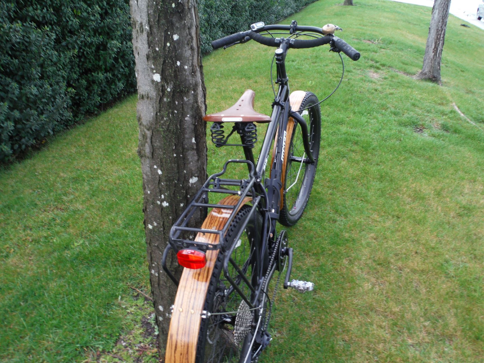

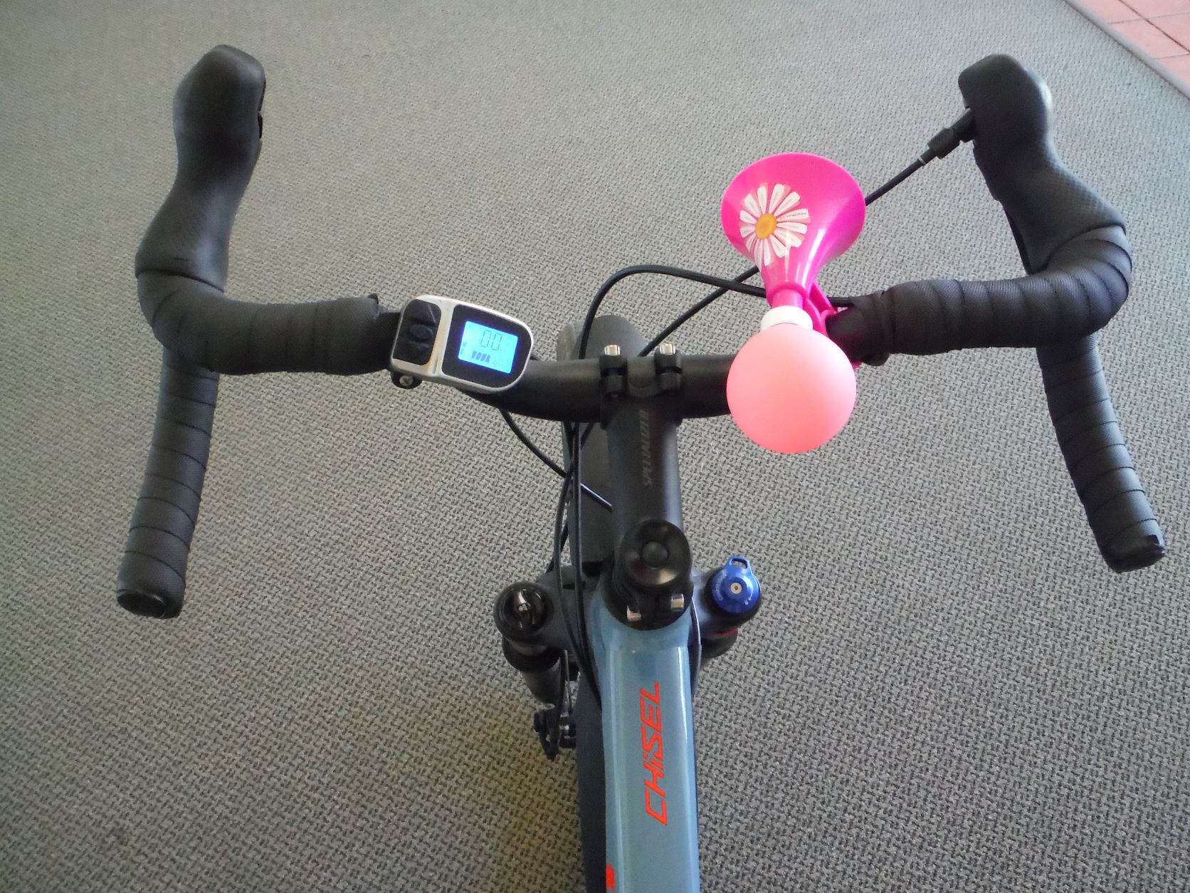

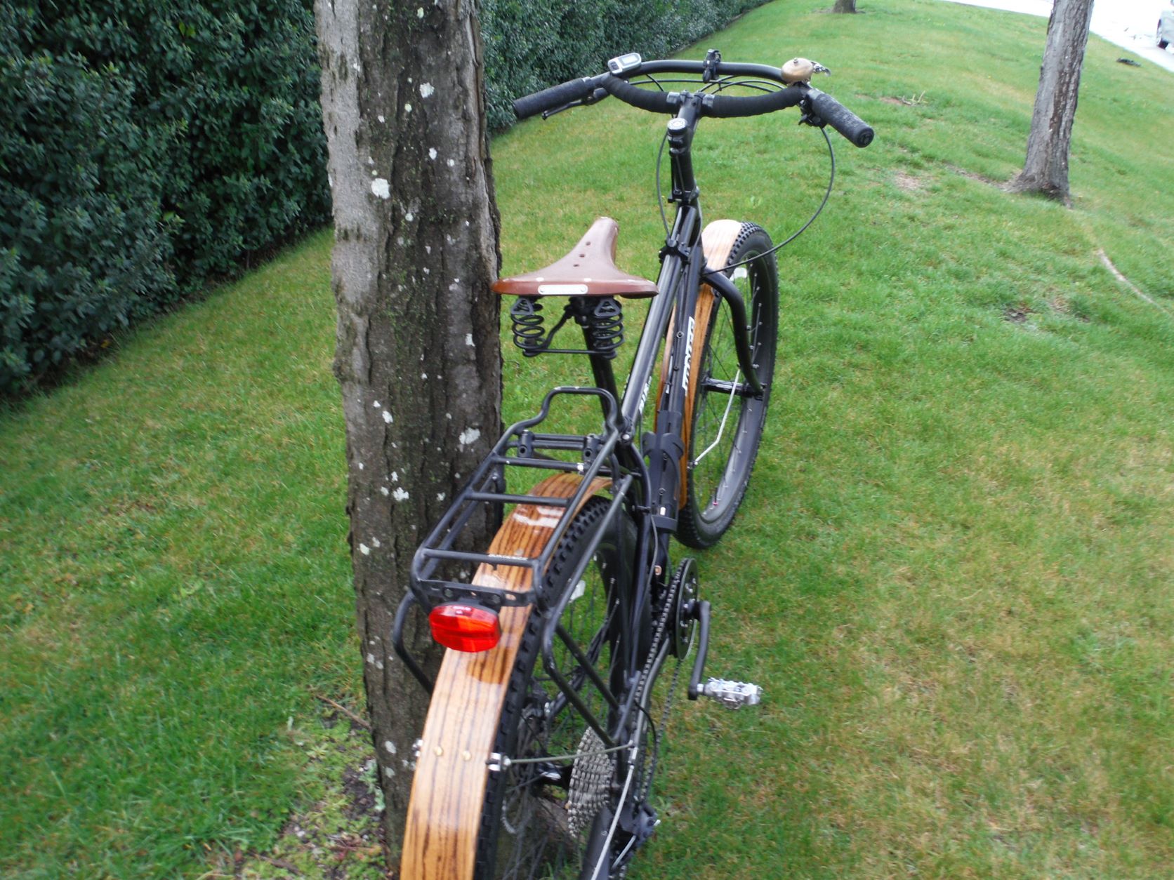

Here is an a Jones bike that I made a mid-drive. The display is to the left/high. The battery fits in the downtube holder.
With a Brooks saddle too. Did you wrap the bars yourself

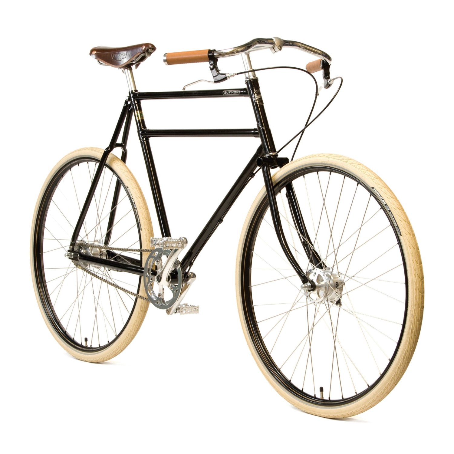

My eBikes do not look like others. They are all different and like one's children, l love them each. A custom Pashley Prospero gravel bike has been delayed but is arriving this week for conversion with a DM02. It is 501 Reynolds. Yes, I wrap bars, often go through frame, and shorten wire runs. You can see that I sometime disguise the mid-drives with decorative chain guards, or will paint motors so they disappear in plain sight.

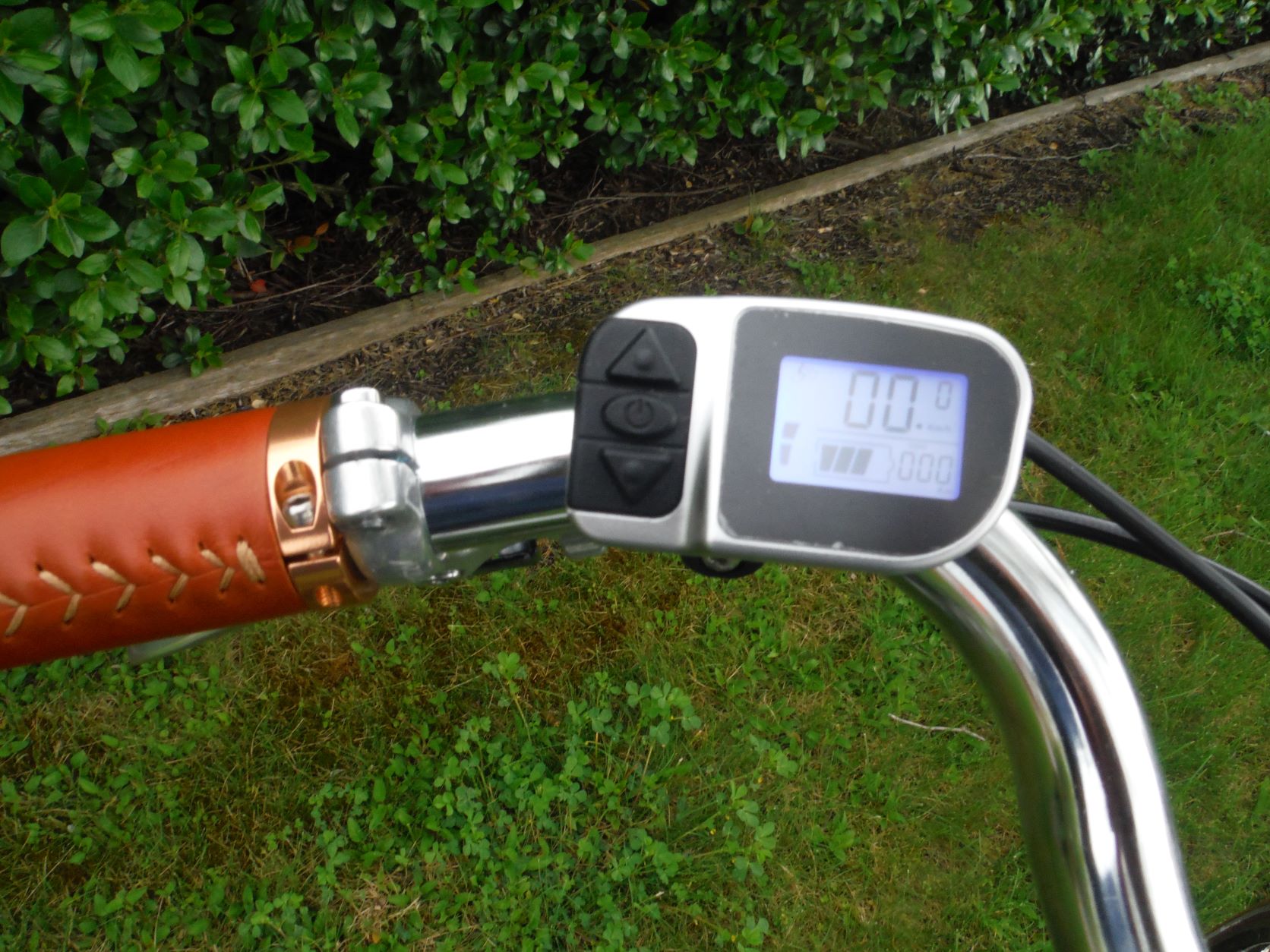

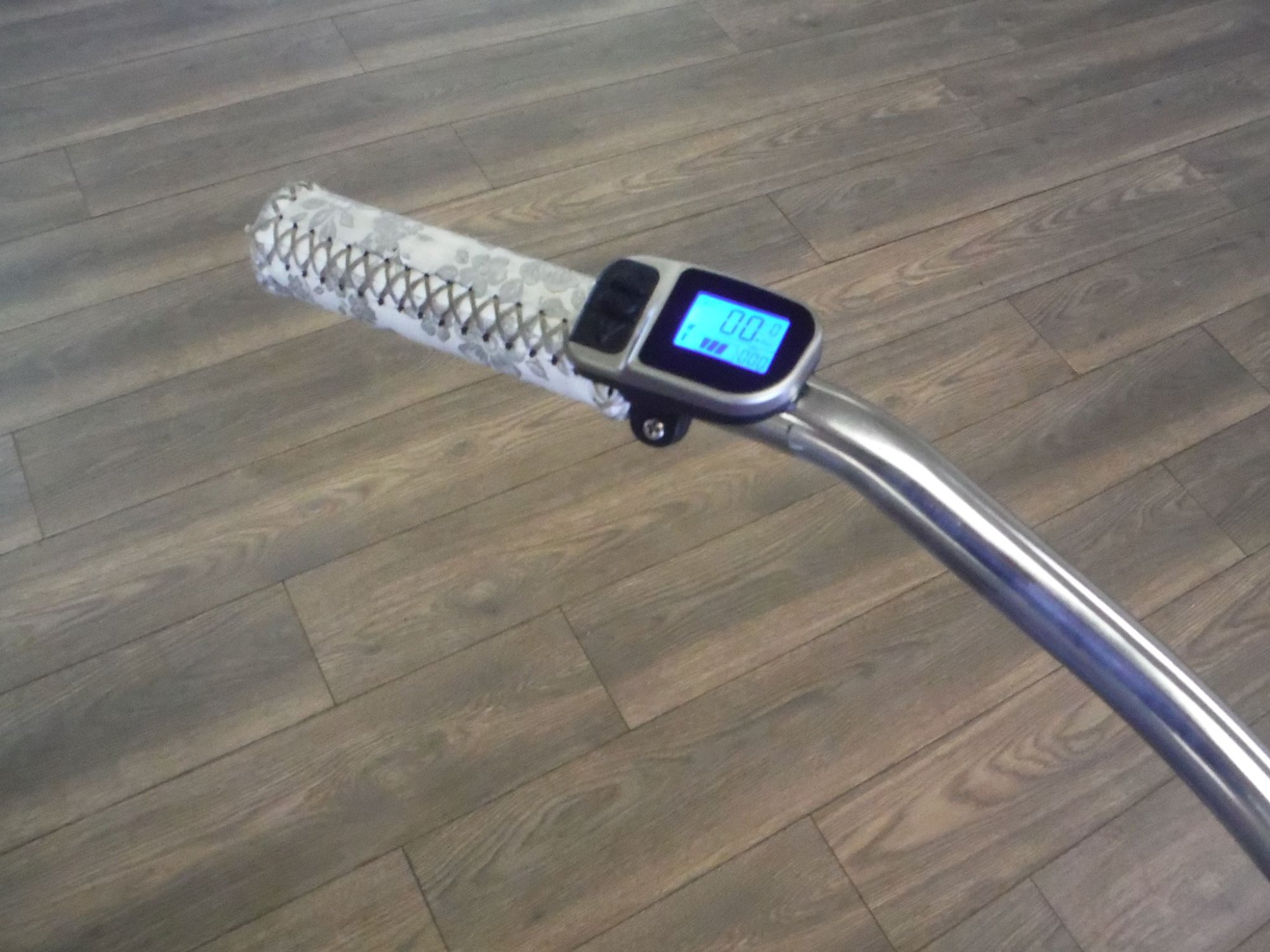

These bars can be flipped, and left to right. Note: The screws in the bar-end shifters are reverse thread, because someone thought that would be less intuitive.

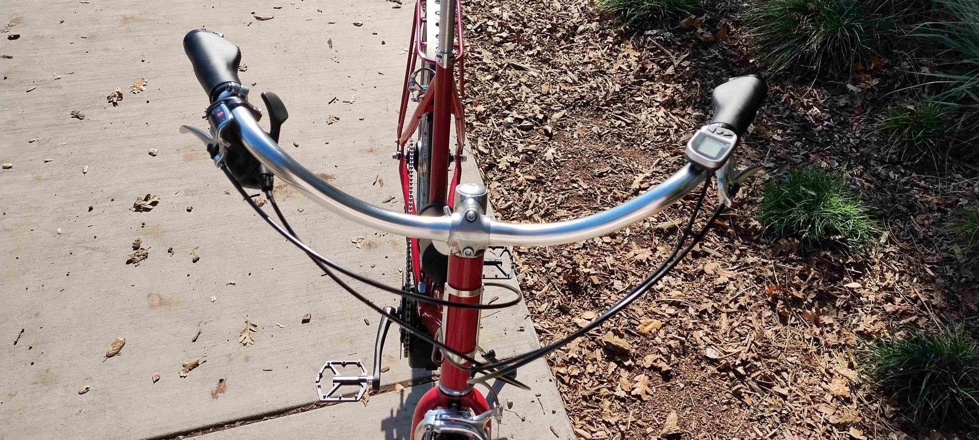

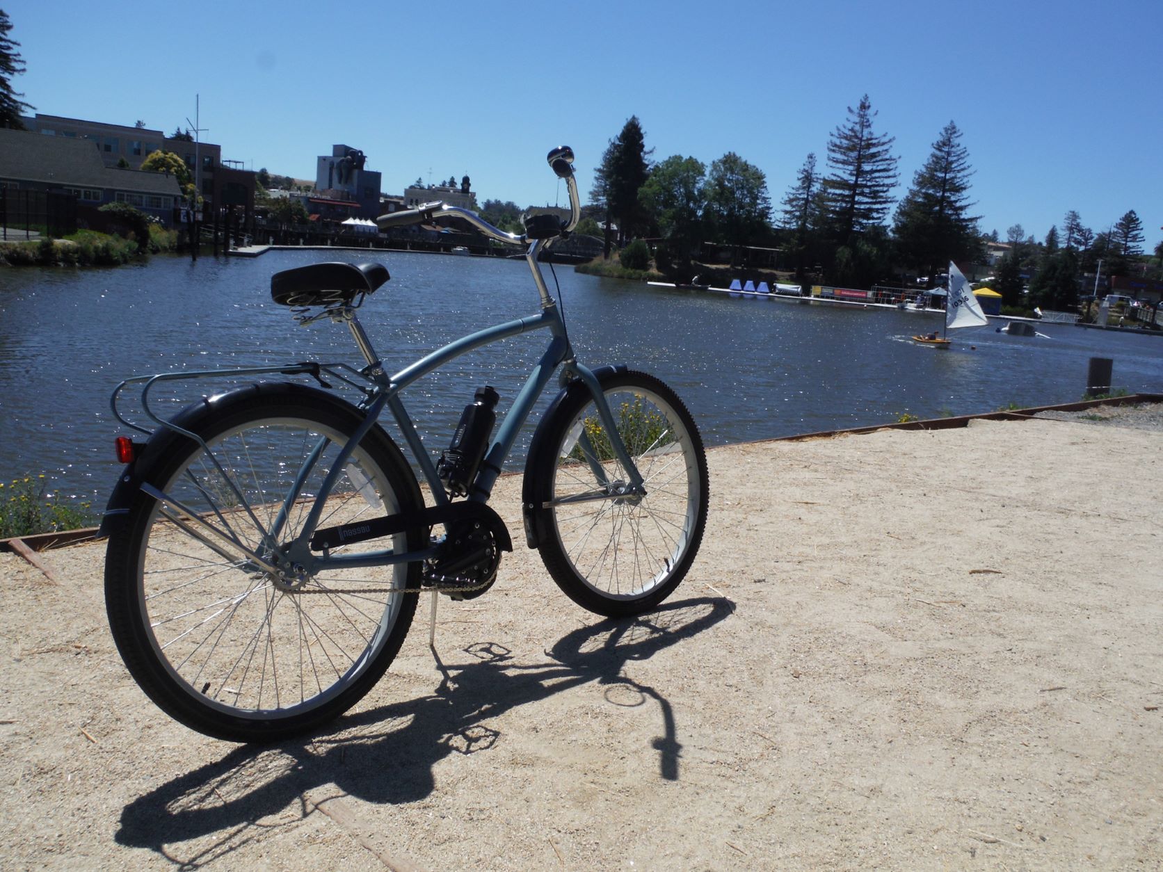

This next one is one of the cleanest eBikes in terms of backswept handlebar wires. I added a Nantucket basket and it sold the next day to an artist. It is all through frame and through handlebar. From the side it looks like nothing. One wire, hidden by the basket of flowers.
Good god man thats a work of art !

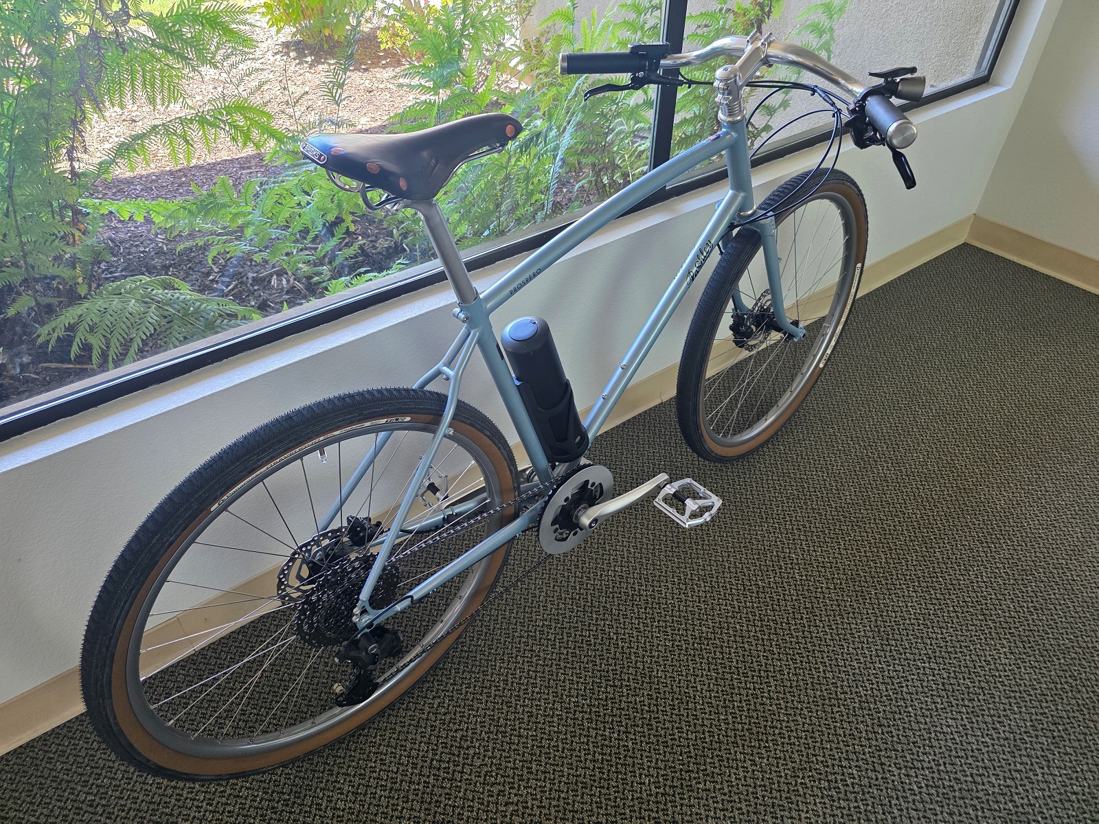

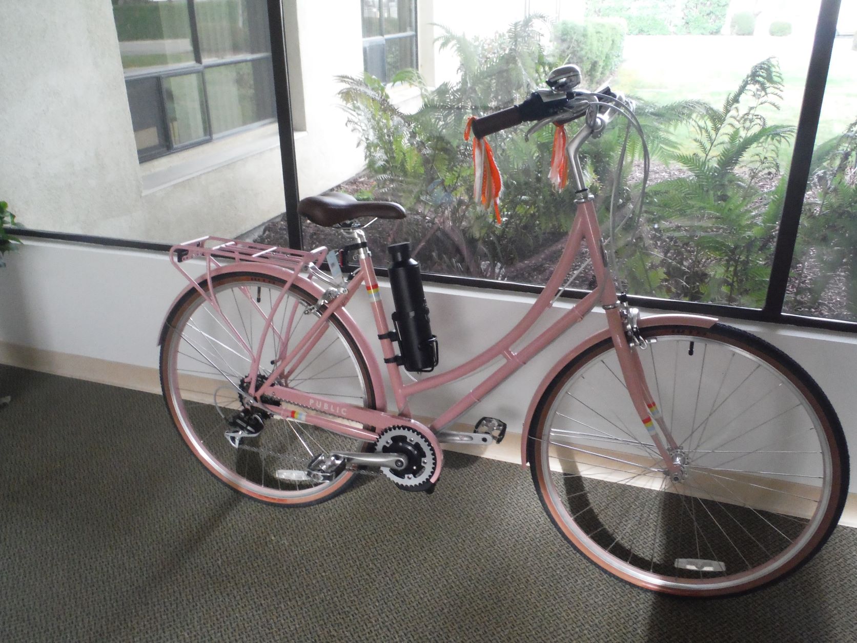

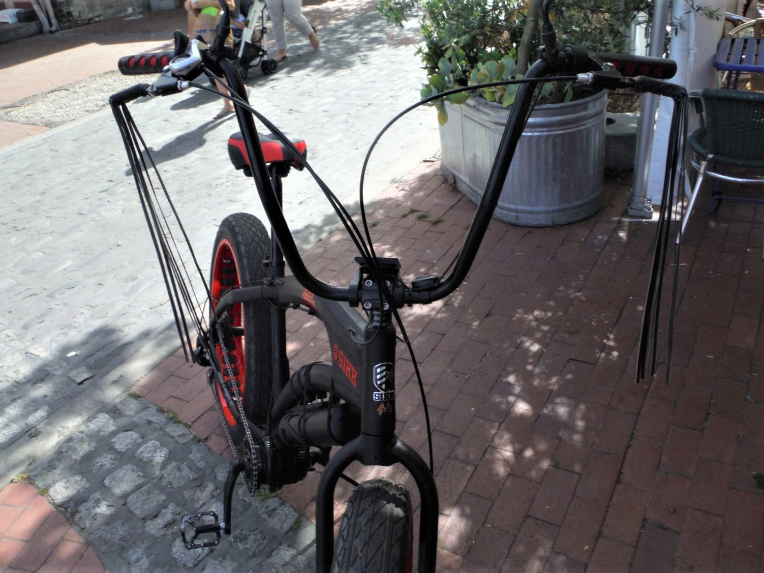

A woman who I have seen walking on paths and said Hi to for years had a problem with her saddle on her favorite bike. The bike above was purchased new and got a flat on the first 50 meters of its first ride. It sat in her garage for ten years unused taking up real-estate, so she gave it to me for free for fixing her saddle on a Tuesday and I sold it as a custom coaster brake electric on that Friday for an undisclosed large sum to a visiting artist/designer from Arizona. That is a backswept cruiser bar. Here is a similar blue bike. This pink one is here in the shop for a tune today. Check its wires. I do not like to ever use any zip ties but was forced to on the pink bike, so I painted them to match the downtube. It sold three years ago, before it was half-way finished. It is rare for an electric bike to have a chainguard.

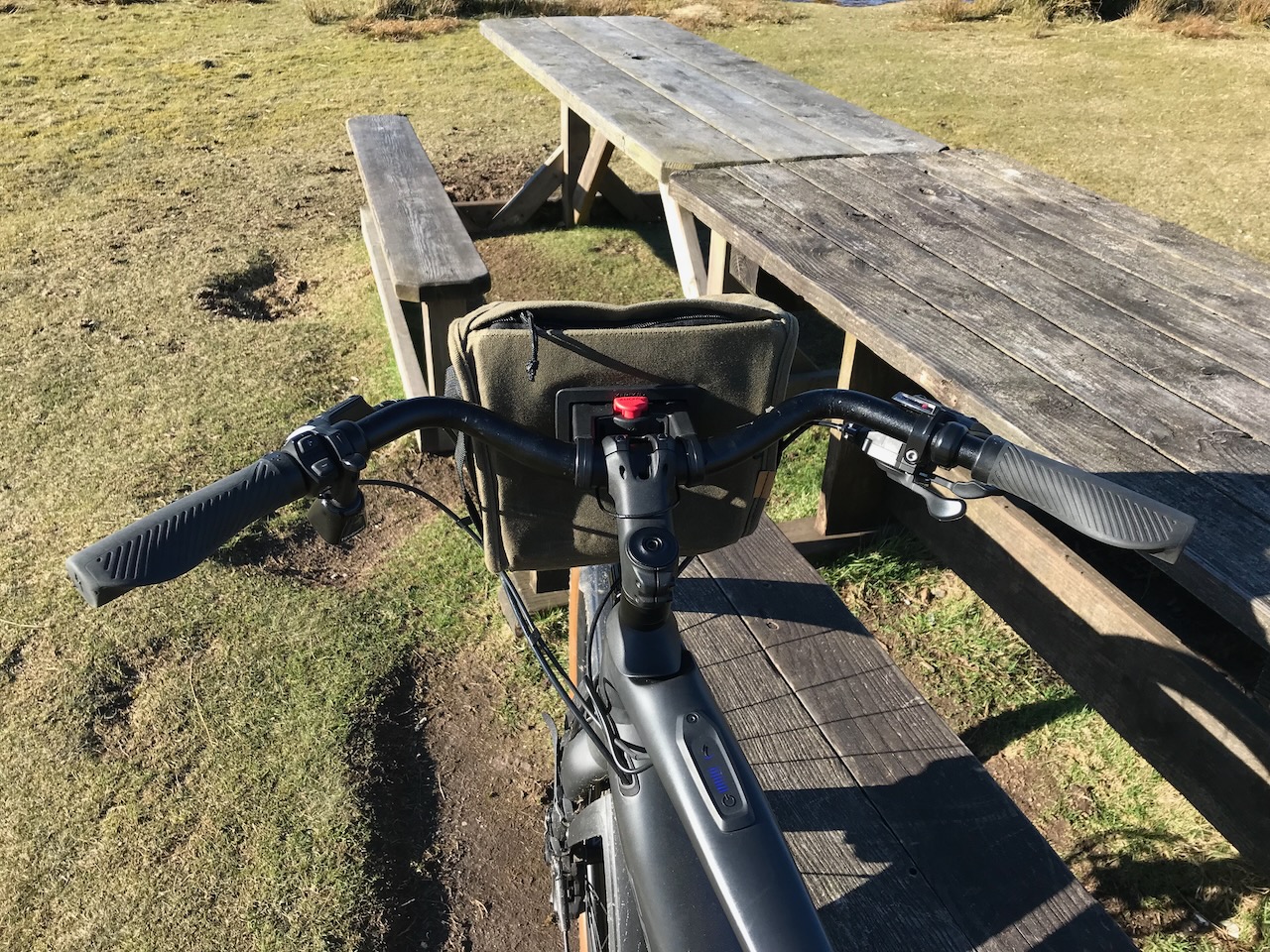

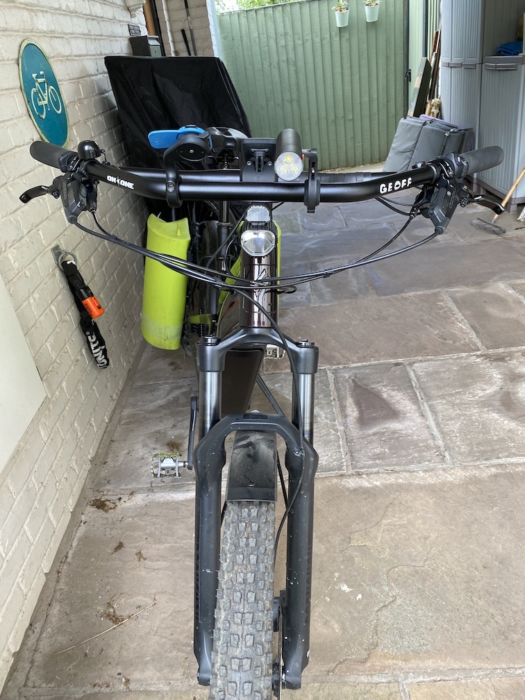

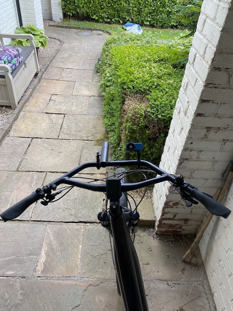

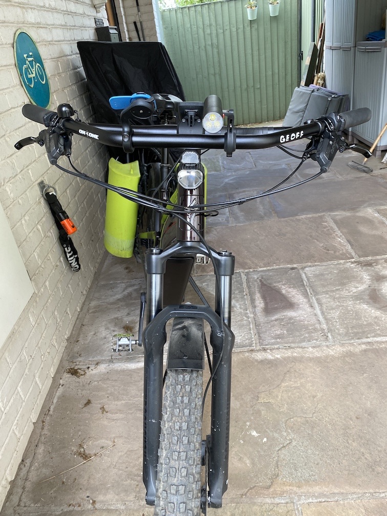

So they arrived and been fitted as you can see. Quality is very good. I love the fact I can have my phone and anything else mounted on the additional bar. And plenty of space to fit a small rearview mirror. There were no real issues to install them. And I like that the birds nest of cables seem to sit better. So I am thankful for that. Im also enjoying the more relaxed and raised riding position. So yes so far its all good.
Thanks again to you all for your interest & recommendations.

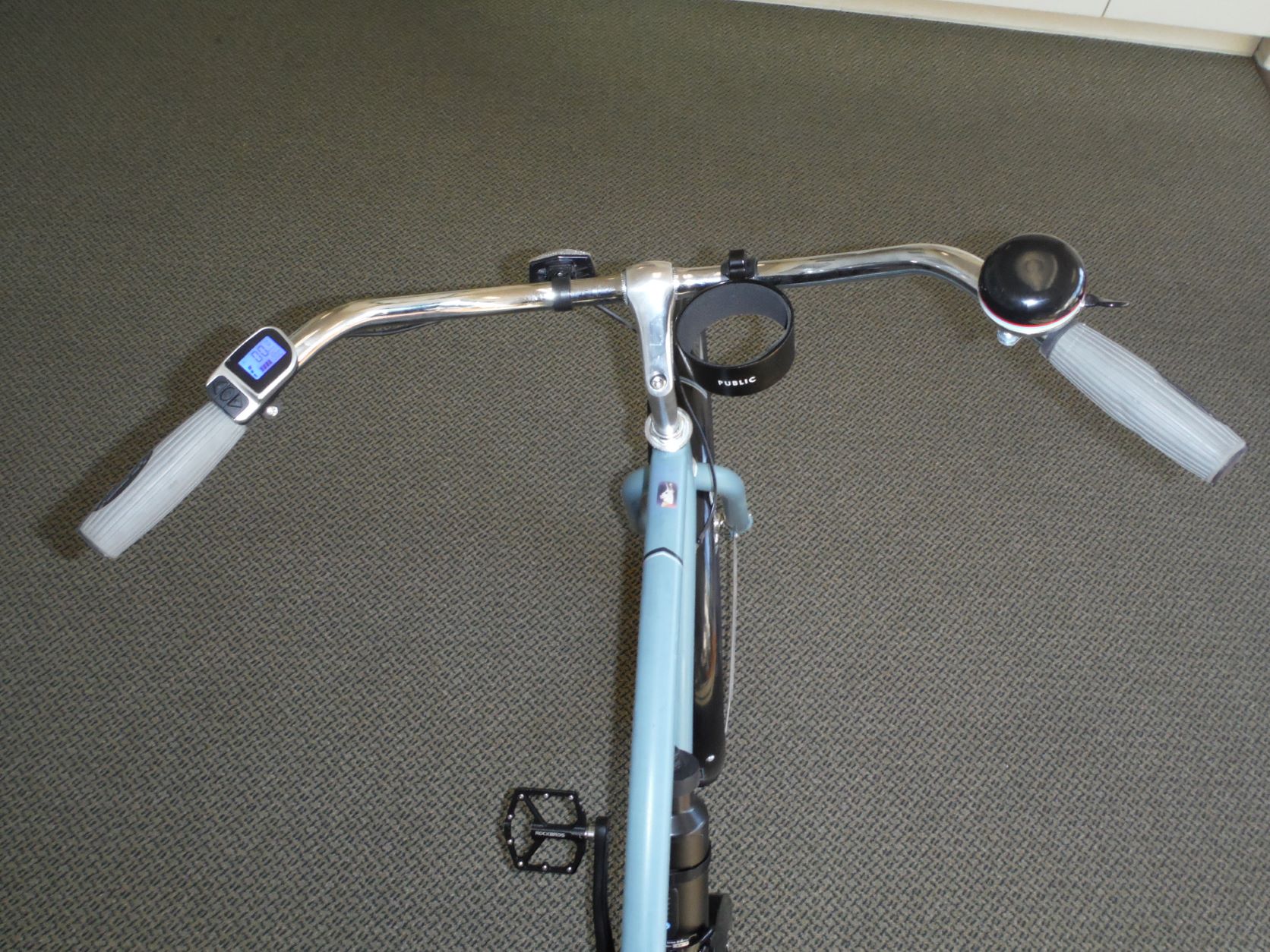

I was just about to order the SQ Lab 321 3.0 bars with 70mm rise, 35° back sweep and 20° downsweep. (You mentioned these in answer to my help post). The only thing holding me back is that they are $110 and it's still less sweep than I measured on the cruiser bars I put on my Trek 520 Touring Bike when my hands started bothering me. They have a sweep of 60°, and were put on an adjustable stem. It is true, however, that I can stab myself with the bar-end shifters in a tight turn! I was liking the fact that SQ adds a down sweep to the grips that eases tension on the shoulders as well. I thought that would also help the hand position with the lesser sweep.
Those On One bars look great on your bike and I like the 45° sweep but the rise is much less than the original bars, which my (non)LBS told me is 50mm on the Vado. I would have to then add a riser stem, so maybe it's not worth going cheaper on the bars.
Damned if all the high rise big sweep cruiser bars that are perfect dimensions for me are the wrong clamp width!!!

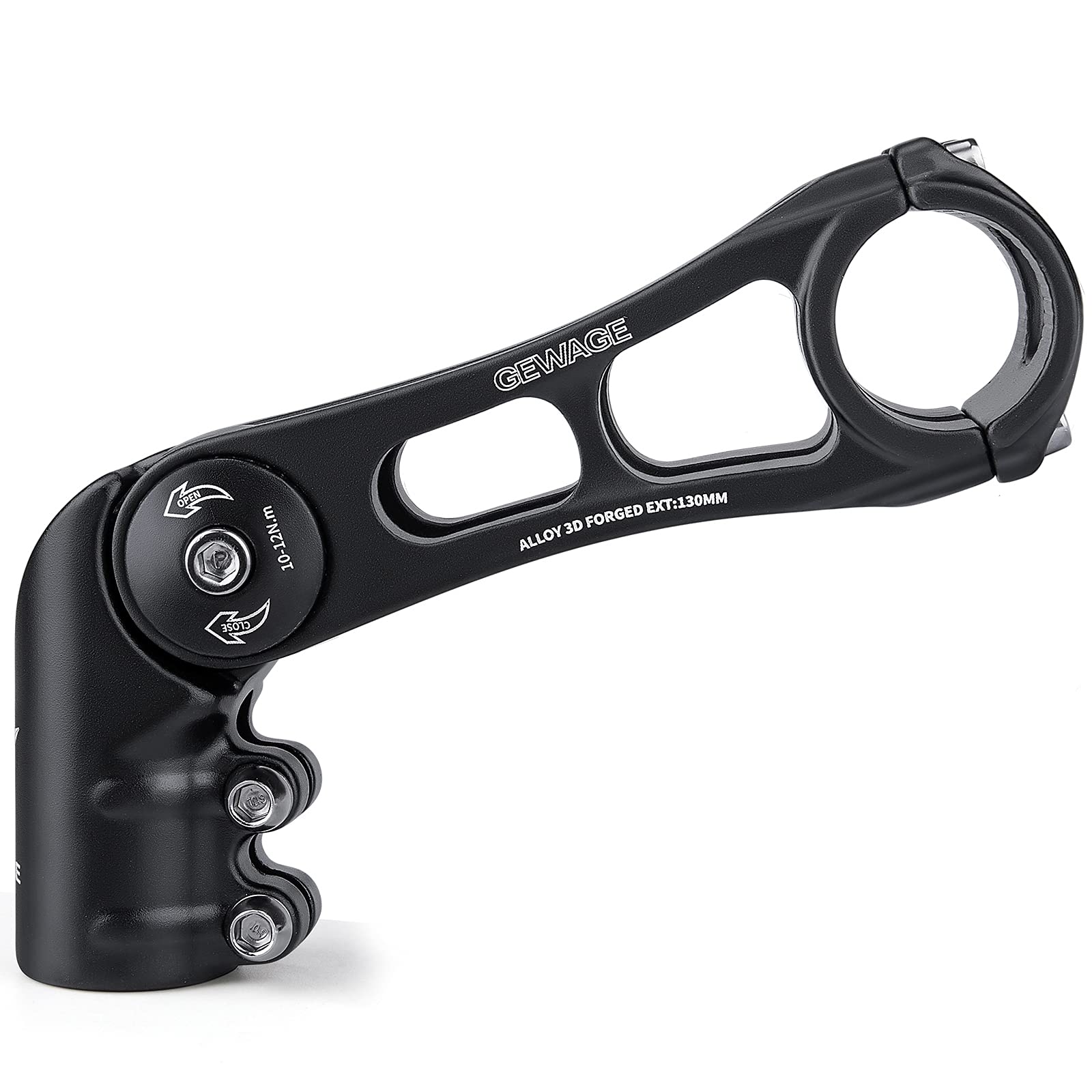

Have you seen these reducers, they can take a 31.8mm Hbar clamp down to 25.4mm diameter, and with an adjustable stem you can get just about and angle/height needed to fit you.
I use the adjustable stems to get good Hbar angles on all my bikes.

I do not have the XL double top tube Pashley Guv'nor yet. Yes, those are some conversions to mid-drive torque sensor bikes. Except for the chopper. That is a BBS02 that the guy purchased and then threw in the towel and had me do it. For a dumb Bafang it turned out fairly clean. My favorite is the Pashley Prospero gravel bike with GRX and a 90Nm DM02 motor. That bike is so beautiful. Another is arriving soon in Amethyst with custom silver rims. Those are handmade in Stafford-Upon-Avon, then I do the conversion here in the Coastal Northern California hills. Attached is a photo of my town in late November/early December. And here is another of that Creme.

Nvreloader,
I see the stem, nice one, but not the reducer. I didn't think I would trust a reducer anyway.
As for changing the stem, I was intimidated by the way the computer is attached to the Vado. I didn't think I could change out the stem.
Advice? (I feel kind of stupid, having worked on regular bikes all my life. The electric and computer stuff intimidates me!)😰
