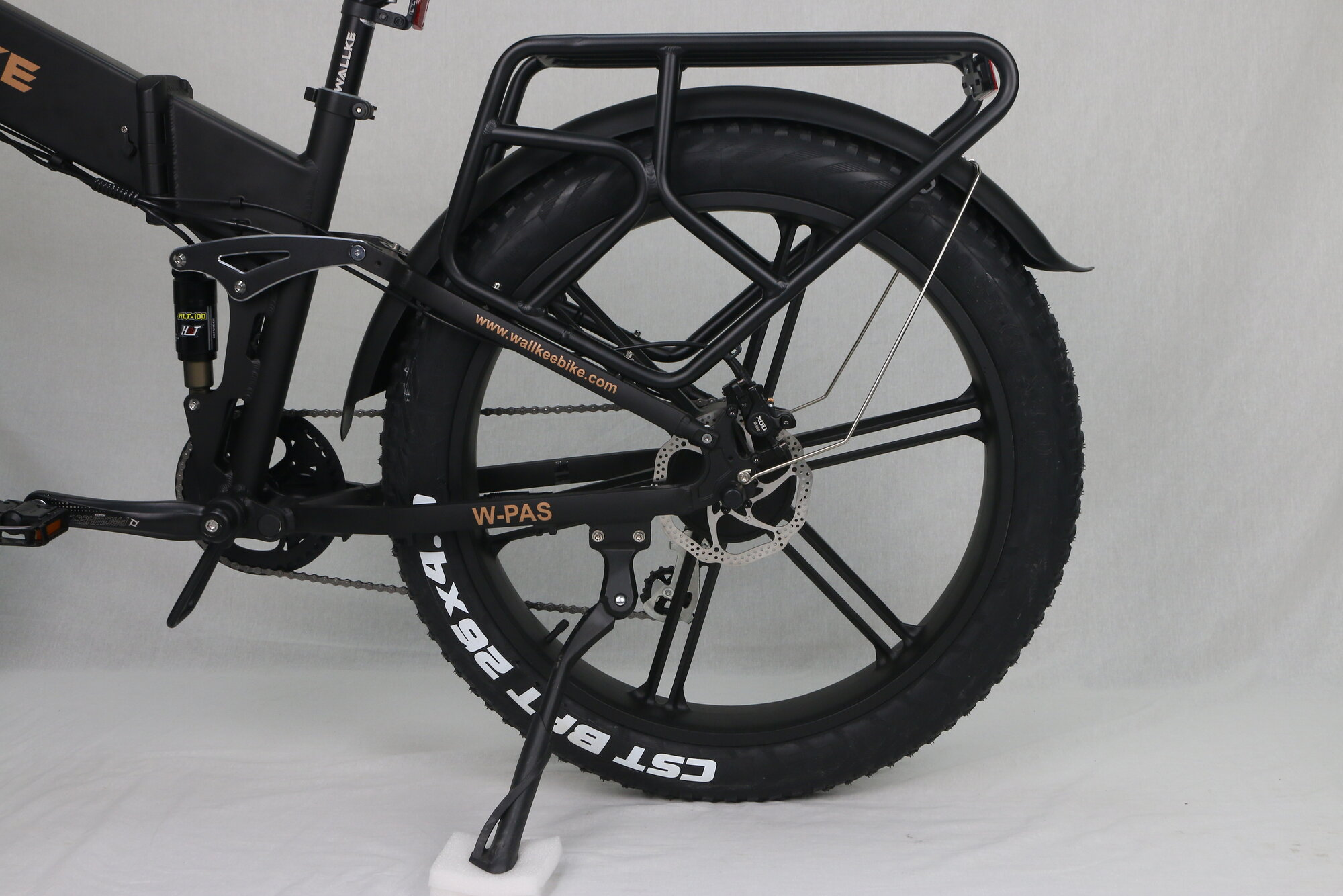

Update:
Here's the picture of the sample rack, please kindly check the attachment.
Extra storage - great for packing in extra gear for a weekend camping trip.
Easy to install - bolts into the rear frame of the bike

Update:
Nice - Thank you. When will it be available. My X3 Pro doesn't have the holes drilled for the 4 mounting screws - does Wallke have a work around for that?
Also - looks like you have fender kit there - when will that be available?
We will launch a new rear rack and fender for the old batch of X3 Pro. The next shipment of X3 Pro will have the holes drilled for the 4 mounting screws. The new fender kit and rear rack will be available in the later October.

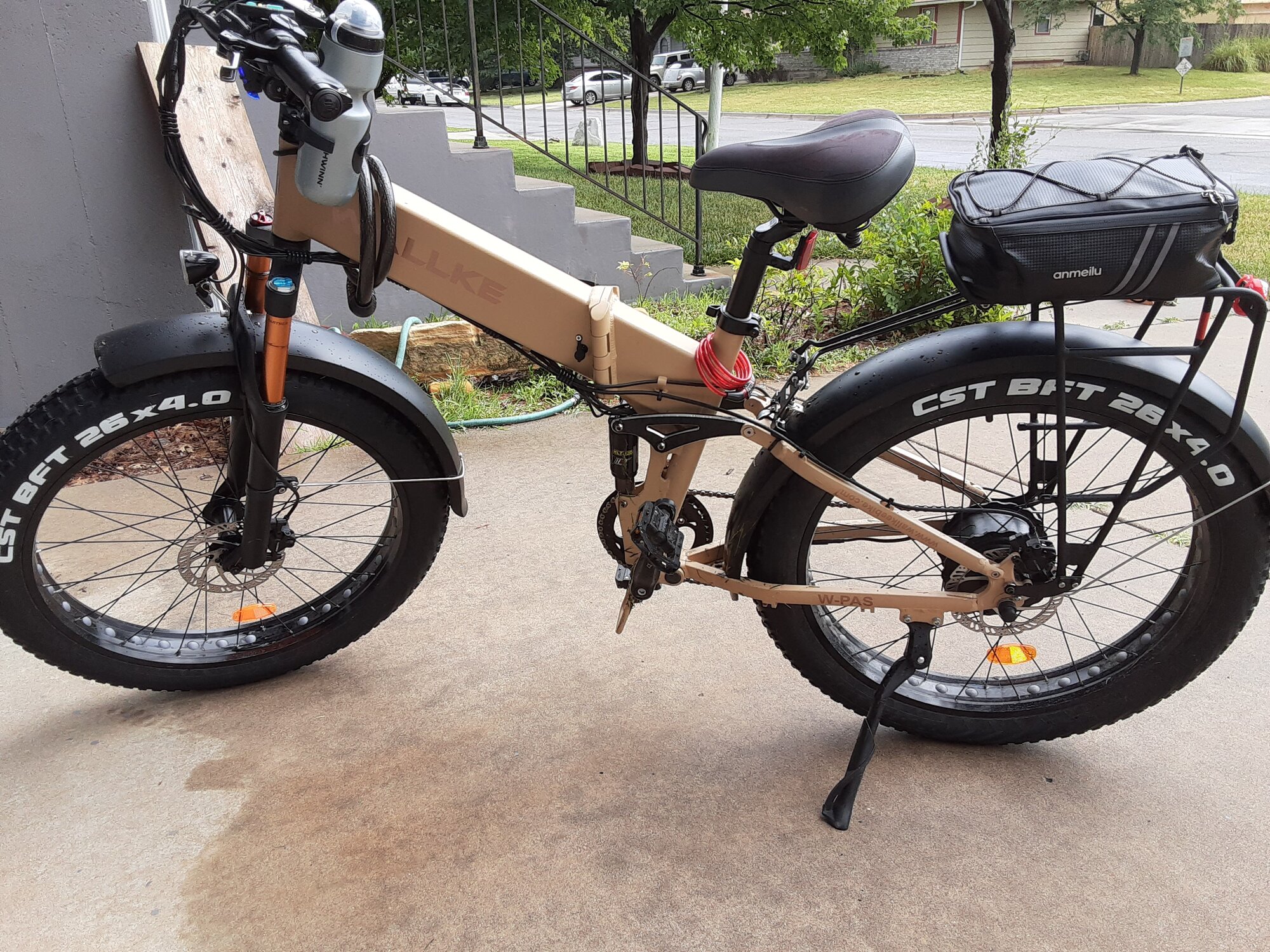

Couldn’t wait for Wallke carrying tools and supplies for long ride. I liked Rizzos Ibera rack because of the easy detach but wanted the weight to be on the axle so Jerry-rigged this temporarily- Ibera has very short posts that don’t clear the tire let alone a fender - anyone have a solution for a longer support post?

Update: Here's the picture of the sample rack, please kindly check the attachment.

I use the Ibera myself that attaches to the seat post. It works great. I take it out when riding the trails. I found a battery bag made for scooters and it fits the rack real well to carry an extra battery for the X3
