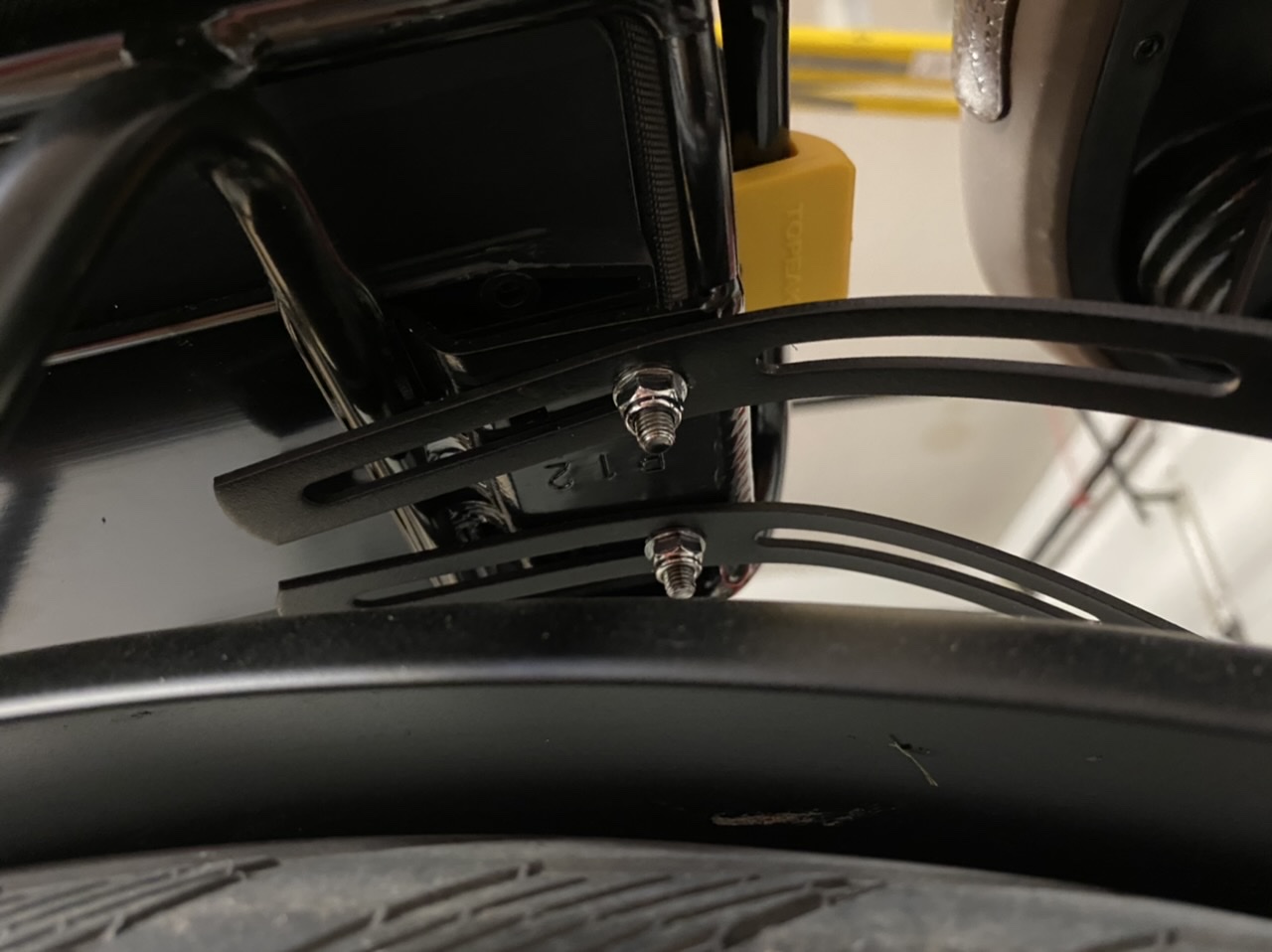

Not meaning to hijack here but I have that same bag and rack but the mounting brackets they put on my bike keep it really close to the seat. As you can see in the picture. there's a little bit of room to extend it out but I think it needs new braces. Do you think that'll be a big deal for a dealer to swap out or am I stuck having to buy new ones?

If the rack deck is level, it is in the correct position. Adding longer arms would tilt the deck back. Other rack brands/models have the deck built farther back on the frame.
I just took some pictures of mine so you can see the difference. I just bought the longer brackets on amazon and then painted them. Search for “Topeak extra long tubular rack mounting brackets”.

I am sure if the dealer has longer arms available as an accessory they would be more than willing to sell them to you, like any accessory.Outfitting an ebike is no different than any bike..the solution is out there somewhere, or parts can be machined to make it work. Like putting a puzzle together sometimes.
Talk to your lbs.
