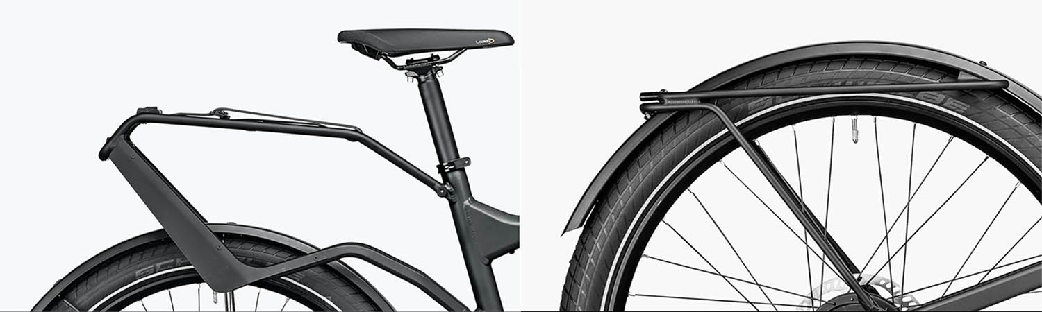

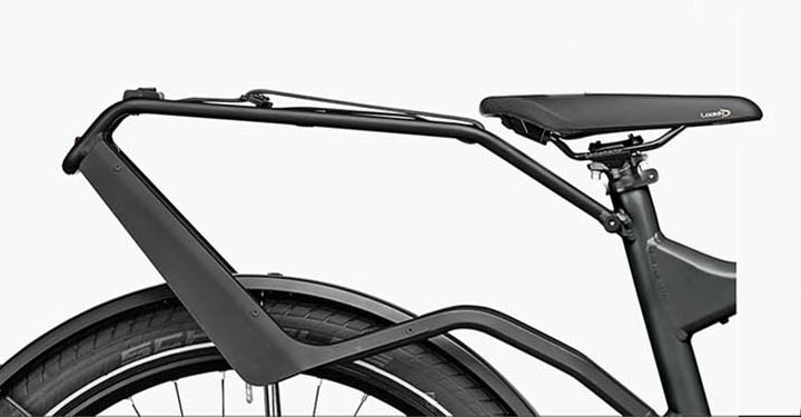

I'm planning on getting the 2020 Delite or Superdelite with the regular rear carrier rack. I was wondering if it was removable and if the smaller pannier rack could be installed. It may require a new rear fender.I could also order it with the pannier rack and do the change. It would make the decision process easier if I knew they could be swapped.
It’s not easily swapped at the moment since the parts aren’t available as aftermarket. You would need to rewire the light, swap the fender and the rack. I’m hoping this will be a parts kit available soon as I know many will want this option and we want this option for our inventory. I imagine it will be possible next spring.
The Superdelite is a big ebike. For those of us who are shorter than average, the optional pannier rack (right) would make swinging a leg over the rear wheel a good deal simpler. Losing sprung suspension of the panniers (along with lower load limits) could be a loss worth accepting. I'd add the same 75mm dropper post as I have on my 2019 Homage.

Judging from the photos, it appears that the saddle can be set at the lowest position even with the traditional rack installed; so, the answer to #2 is 'No!' Here is the 'evidence', courtesy of Photoshop…
My personal opinion:
  • If you can place both feet on the ground when stopped, the seat will be set lower than the 'correct' pedalling height but…
  • this can be overcome by using a dropper post which will give you two heights (low when stopped and high when pedalling).
  • A dropper post will also make it much easier to get onto the bike, but only with the traditional rack (above) removed.
Maybe, a 75mm dropper (usually the minimum up/down range) will be just right – it is for me on my Homage which has a 49cm frame. Whatever you do, don't choose a dropper post with an excessive range which will propel you so far skyward that, when it's in the 'up' position, your feet won't be able to reach down to the pedals!
